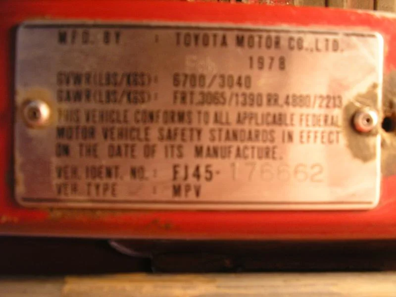

I don't know if they are different from one country to the next but my Canadian spec. 78 FJ45 says 6700 Lbs / 3040 Kg on the tag in the drivers door jamb.

Don't forget that the GVW of a vehicle is the MAXIMUM weight of the vehicle and it's contents (loaded) allowed. That amount will vary from place to place and is determined by the local authorities (I think) as well as the manufacturer and the class of vehicle (we all know Toyotas are first class ;)). GVW affects breaking and also the life of road surfaces and bridges and that is why the authorities care what it weighs. The weight of the vehicle itself is called the Tare Weight. If you squint just right you will notice my blurry tag above also shows the GVWR breakdown between front and rear axles.
interesting
The tag from my truck says the front axle will take a maximum of 3065 Lbs and the rear 4880 Lbs which added together makes 7945Lbs. That is greater than the GVWR stated at 6700 Lbs.
I believe the explanation is that each axle has a maximum and the two added together cannot exceed the GVW at any one point in time. So I could load up the bed until the rear axle hits 4880 Lbs and then the front could not be more than 1820 Lbs to stay under 6700 total.

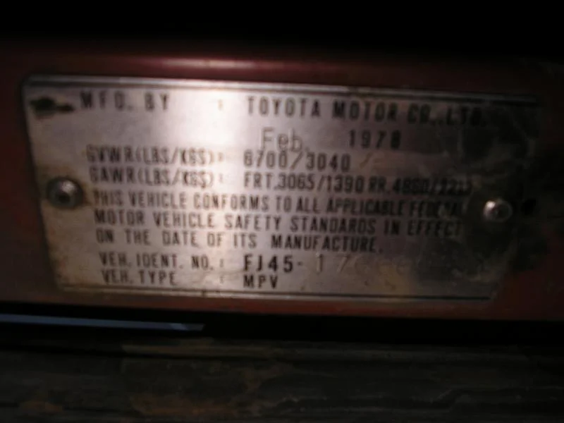

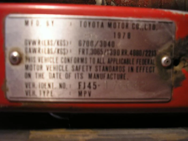

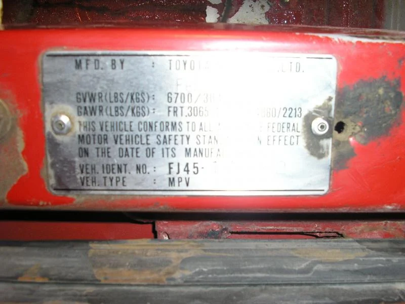

Pictures for Henry
Henry James the 47th has requested more and better images of the GVW tag in the hopes of doing a reproduction for his truck. Well I did more but note much better... hopefully you can get what you need from these. The tag is 3.432" x 1.707"
