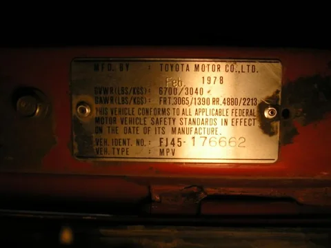

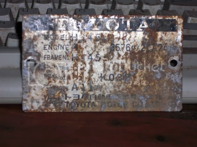

thanks Awl_TEQ for posting those pictures up - 5th time was the charm.I'm also wondering if those GVW tags were only put on N. American market trucks, on the door pillar - I haven't noticed them on Australian truck, and your South- or Central-American truck doesn't appear to have one. I wonder if anyone from Europe or elsewhere can confirm that? I've seen a photograph of an Oz truck that had a couple of tags in the engine bay, only one of which was the VIN - I can't recall what the other one was however. Mine (from Oz) only came with a VIN tag - but then, he-he, it was missing more than a few parts when I received it! :hhmm:

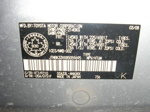

I haven't really ever noticed a vehicle that did not have the GVW marked on a tag somewhere, not that I always checked for one. I was born in the US but have spent all my adult life as a Canadian so I ask you - is it just a Canadian regulation that stipulates GVW be marked on vehicles? Or perhaps a chronological issue with mine being a 78 and some of the others here being older and before the regulation came into effect? Just for kicks I checked all the other vehicles in my possession. These are all late model, 2008,2003 and 2007
My (her) Rav4 - made in Japan

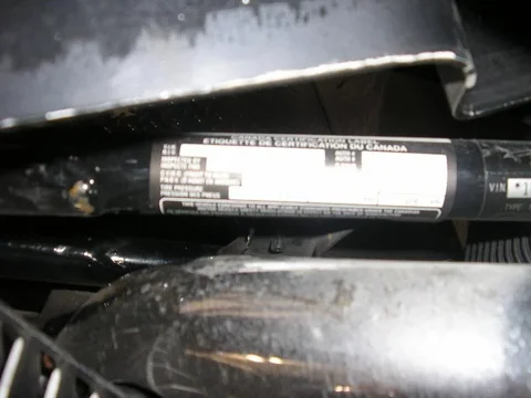

My Harley (imported from the US last year). This tag is the one Transport Canada made me add to the bike in order to get plates for it. (I know it's blurry but it has the GVW on it)

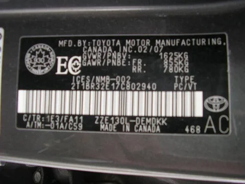

My Corrola - made in Canada

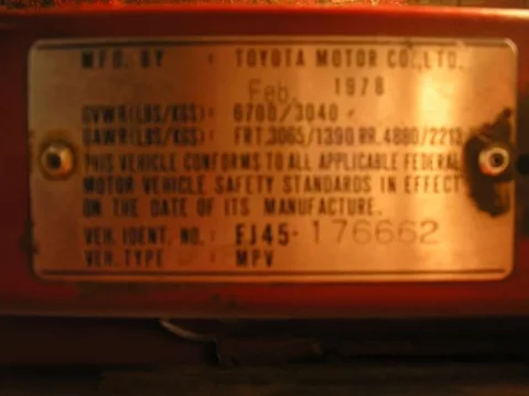

My US models have the door pillar tag with GVW, but my Aussie specs don't have it. They have a second firewall plate for Aussie compliance that lists manufacture date, gvw, and other goodies. The compliance plate is not produced by toyota, I don't believe, as it is stamped on very flimsy material, probably aluminum, with no ink/paint, not nearly as nice as the other firewall plate or the canada plate above or the door pillar plate on my us spec.
It would appear that the GVW tag on the door pillar is something unique to Can/US market vehicles.
I was surprised to read about Transport Canada insisting on a GVW tag for your Harley Awl_TEQ - I think that must be because of the recent date of manufacture. I had to pass my truck by transport Canada as well about 8 months ago, however (perhaps) since mine is more than 25 years old, they only needed to see the VIN number in two places, which was no problem since I had the number on both the VIN tag and the chassis. I was thinking that it was a really good thing that my chassis was in good shape up at the front of the rail and the chassis number was/is clearly visible.
Lots of 40's I have seen have had various front end 'incidents' , custom work done with fronts cages/bumpers and so on, which result in the chassis number location being damaged or welded over, etc. If I were buying another truck like that from OZ or elsewhere, I would insist to see photos of a clear chassis number (and VIN tag on the firewall) from the seller before commiting any money.
