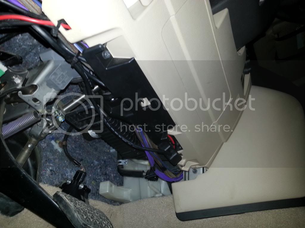

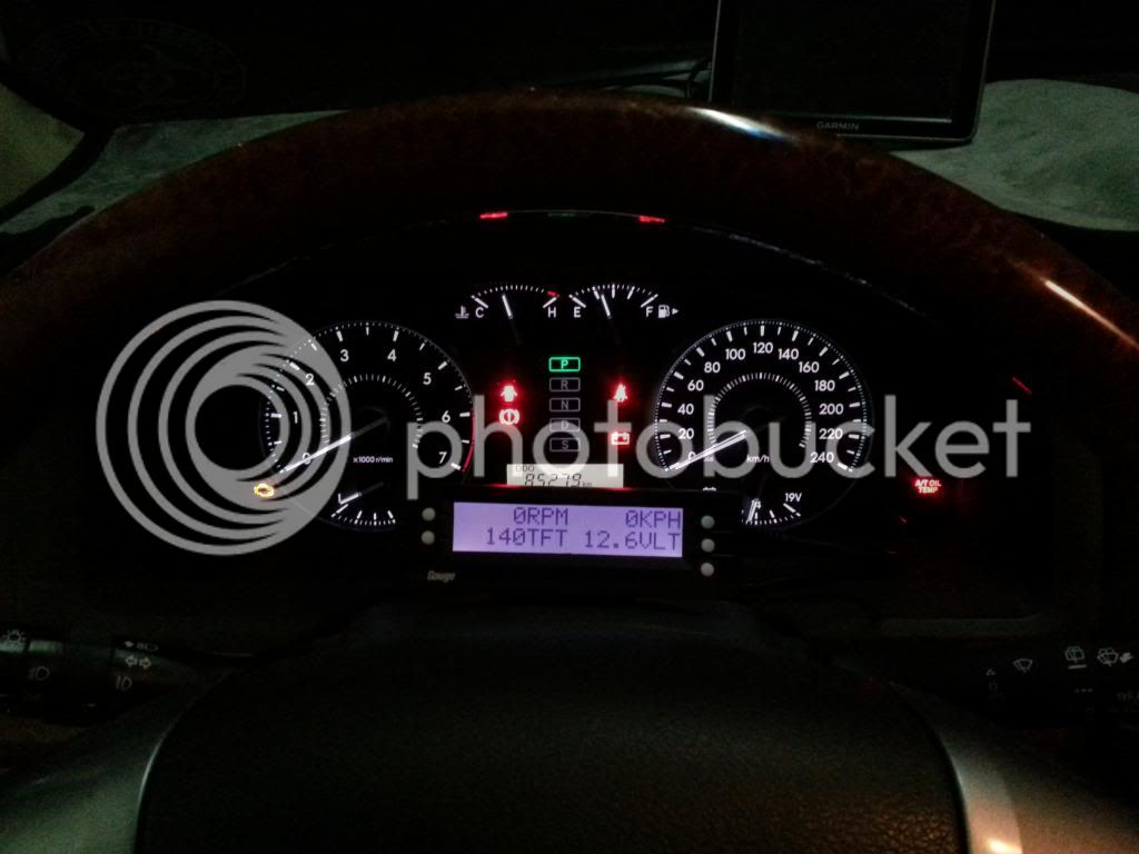

Ordered a scanguage for the cruiser, setup the transmission fluid temperature gauge on it. Just wondering what is the optimal oil temperature range, will be monitoring temp changes city/highway driving and how it fares off road once I find the avg temp range will put on an oil cooler to help with the summer heat
didn't have much time to find a "clean" way to route the wires from mounting position so pulled off a blank switch and routed through the opening

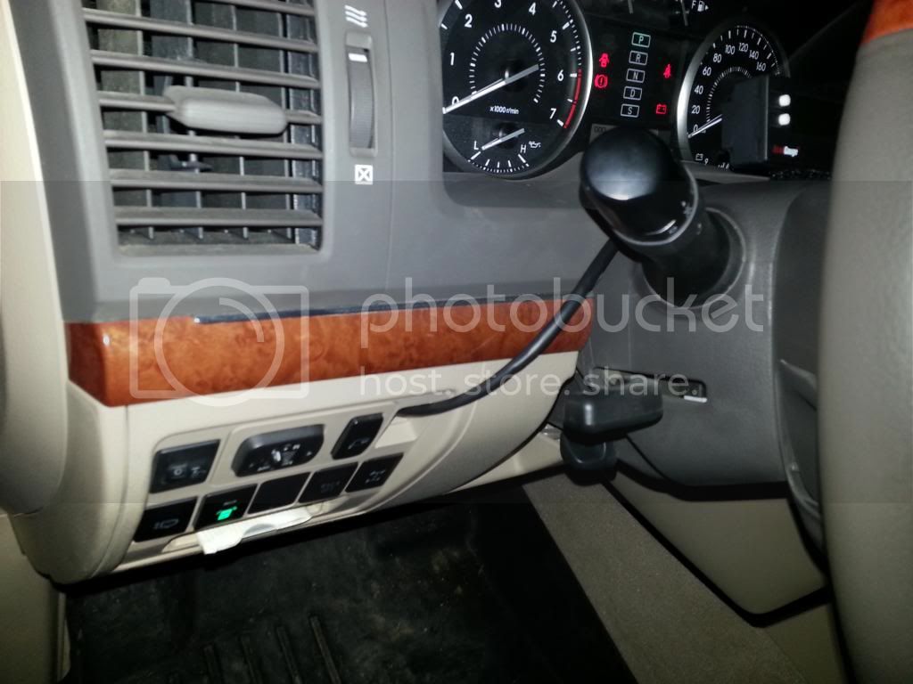

Desert Nomad, why don't you use a bluetooth device?
I personally use the PLX kiwi with the torque android app. Check them out here:
https://plxdevices.com/product_info.php?id=GSSTBLUETOOTH
I taped the device under the steering wheel with some double sided tape and it automatically connects with my phone whenever I enter my car.
This is a screenshot of the torque app, you can add whatever gauges you want.
http://imgur.com/5370DSu
I had my eye on the go point as well as the kiwi for a while. For the time being all I need is a fault code reader and it was a plus I'm able to get the transmission temperature reading, I wanted something simple that would work on its own wether or not I had a smartphone on me. I said once I'm accustomed to it if I need more features I would upgrade to one of the bluetooth modules.

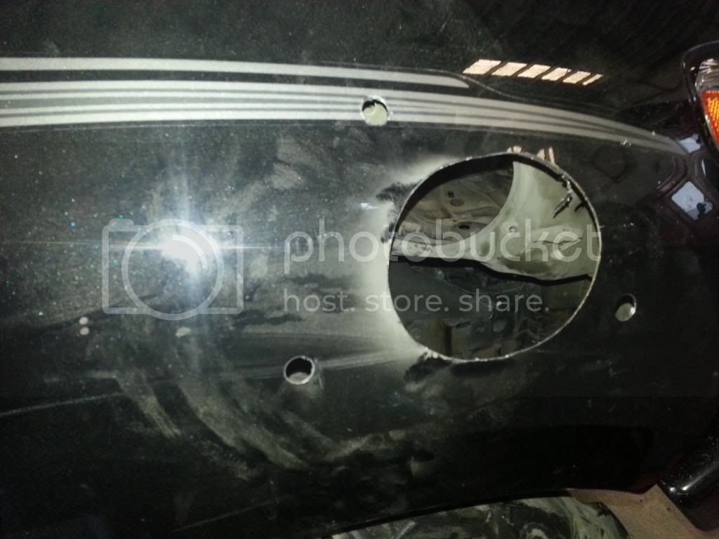

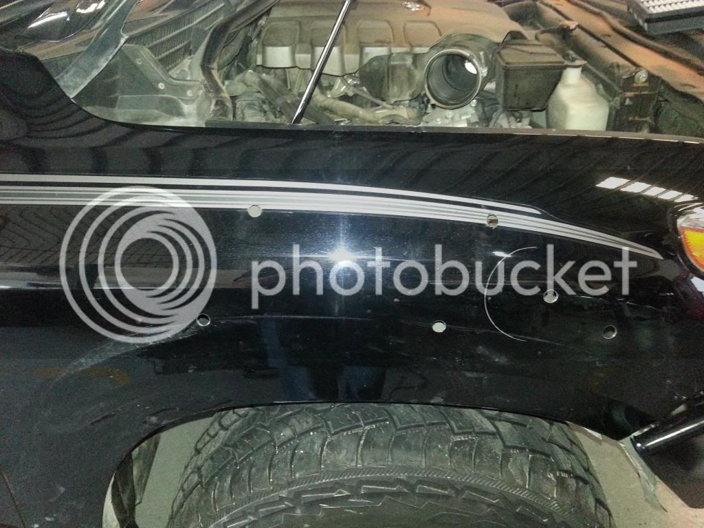

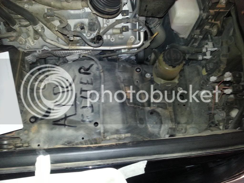

For now had an impulse buy and got my fender full of holes.

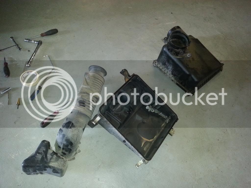

Pulled out air filter box

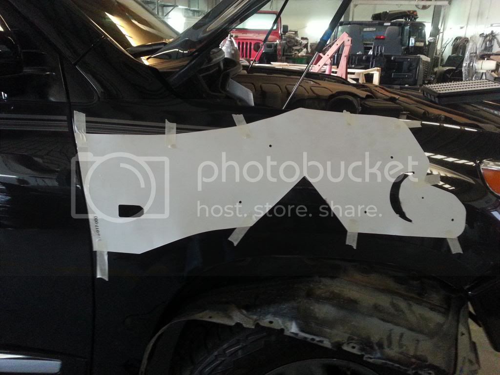

stuck a piece of paper on the cruiser

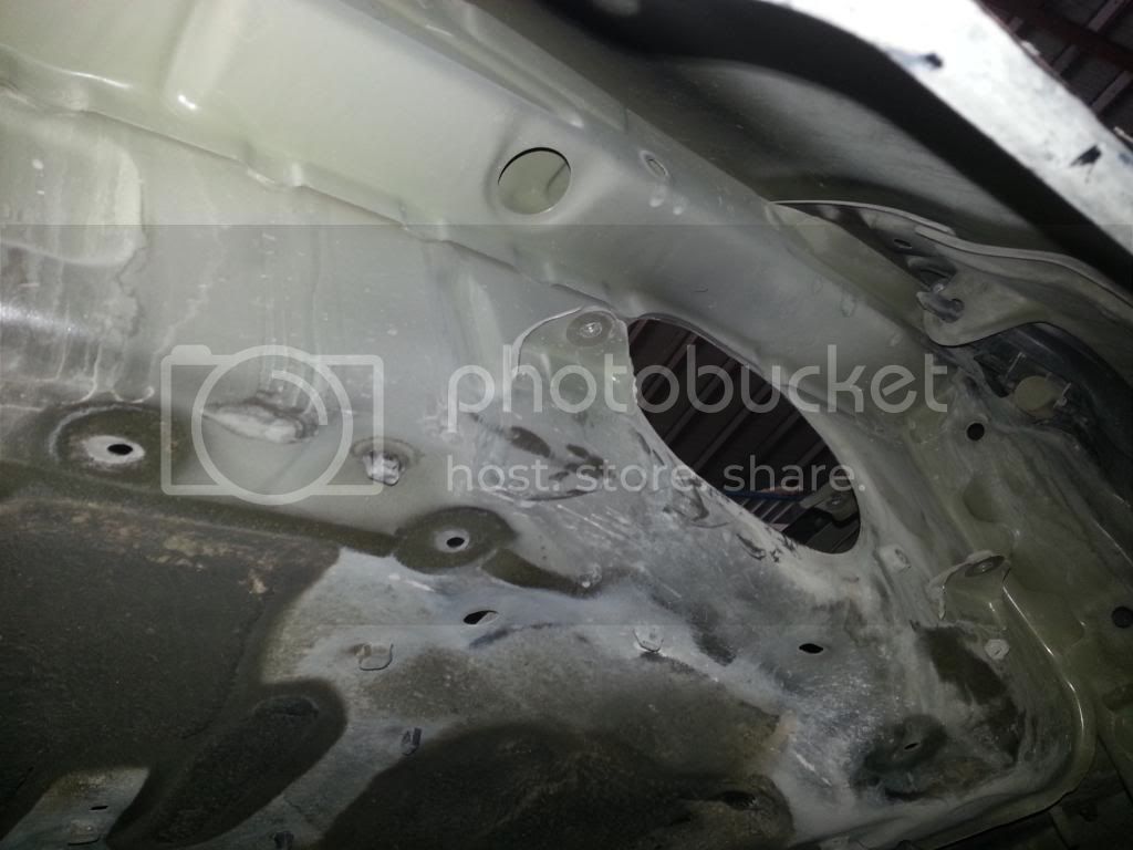

then hacked at it
and hacked some more
holes line up?

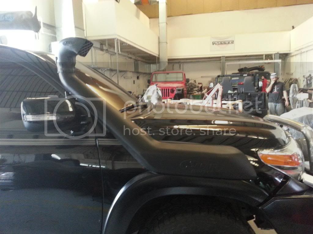

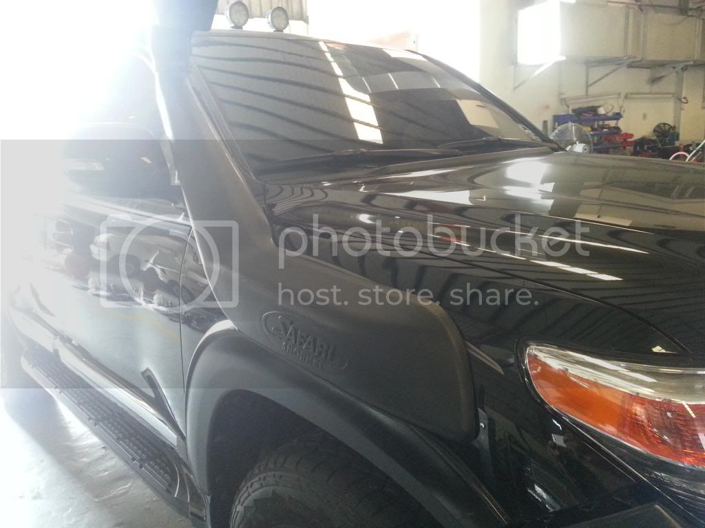

snorkel time

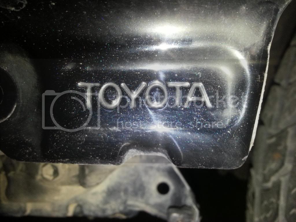

Pulled the side steps and wheel arches off, looks much better but I was shocked there wasn't the rocker panel cover underneath. I was under the impression they weren't on the LX and with the LC should be already installed.
can anyone confirm if this is the same as the other '13 cruisers or if they have the panels underneath.

Is there an option of having the snorkel face backwards so you're not sucking in sand and dirt kicked up by vehicles ahead of you?
There's one clamp at the top of the snorkel you just loosen that and flip it round... I think it's the same design on all safari snorkels
** Just realised on the older 200's the side step and rocker panel were separate, on my '13 they are connected to the steps.

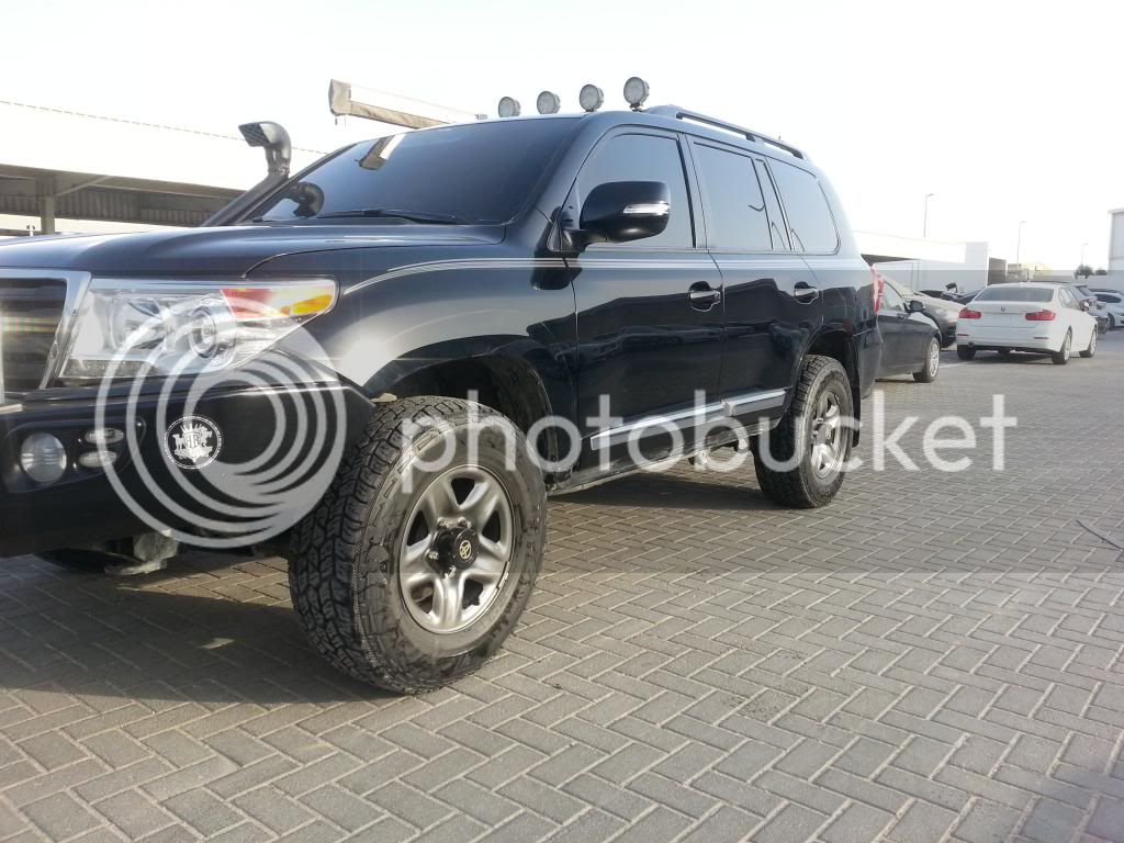

Finally got a gas strut installed on the wheel carrier and stopper welded in to hold it open and stop it whipping round and into the taillights.
Fitted pizza cutters to the 200 255/75R17, couldn't find 80, cooper discoverer s/t maxx. :confused: Only one way to find out if it's a mistake or not. Take a quick drive through the dunes without deflating and see how they handle.
Those are THIN!
