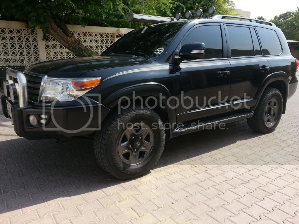

LCKID..i posted a pic here. Thinking of putting a spacer upfront and try these 305 with TRD rims.

Spacers are 35mm approx 1.37" check the backspacing of different rims as well. The black steelies I had on earlier pushed the wheels more out than the stock alloys

R20s..hmm well most of our middle east spec LC200s are R17 or currently R18s.We prefer R17s so as to add a bigger profile tire for our desert rides. the size I'm interested is 305/70-17 (coz its easily available and is 1/2$ than BFGs). When tested on stock alloys 17x8, they were, like you said, just an index finger away from UCA. this can be a potential hazard to UCA and obviously to the tire. Apart from UCA, i would have to trim the inner plastic guard to avoid excessive rubbing, while turning. The situation is much better if you have 17x7 steelies - So for my case, there are few solutions, as i understand it... to get alloys of different offset, like the TRD 17x8...continue search for hard to find BFG AT 285/75-17... or add a spacer in front (with TRDs) to move the 305s tire away from UCA ;p ...
But..i just love the looks of those beefy 305s ! :)

I don't think the bfg at comes in 285/75 on the site it shows mt's for that size and at's in 285/70. The steelies I had previously were the 17x7 but with the decreased width tire pop outs are more common while offroading
Correct 17x8 is ideal and yeh it was a typo, I meant the BFG AT 285/70s. Did you manage to get a good deal on BFGs?

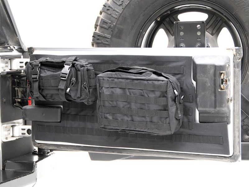

Got a backpack for the cruiser. Should be easier with all the recovery gear ready out back.
I am going to have my in-house upholstery guys try to make an alice style pack for our APC's and at the same time a couple things for my Jeep and Isuzu.
