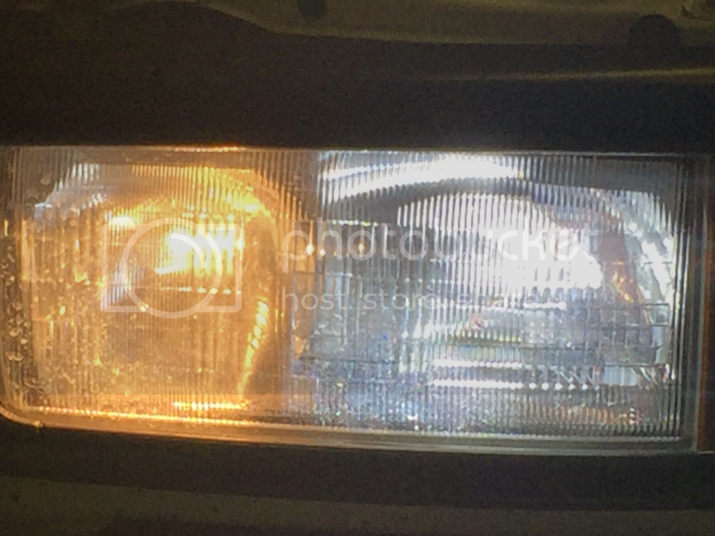

Are you not better off just getting the new generation of leds?
Only if you can find a new LED bulb that emits its light from the same spot as an original halogen. Otherwise the internal reflectors do not work as originally designed. This is why the HIR's work so well as the filament is in the same spot as the halogen you replace.
They are starting to come with a metal hood over the LED to fix that issue. Once you try these you will wonder how you got around without them. I don't get bright lighted, and they have a decent cut off on low beam. The high beams kind of spashes light around a bit, but I only use that offroad or on desolate highway anyhow. I've even had mine underwater a couple times and they still work. Amazon.com: MOSTPLUS 80W 9,600LM 6000K White Plug and Play H11 (H8/H9) CREE LED Headlight Conversion Kit Bulbs 4,800LM Per Bulb with 3 Year Warranty: Automotive
They are starting to come with a metal hood over the LED to fix that issue. Once you try these you will wonder how you got around without them. I've even had mine underwater a couple times and they still work. Amazon.com: MOSTPLUS 80W 9,600LM 6000K White Plug and Play H11 (H8/H9) CREE LED Headlight Conversion Kit Bulbs 4,800LM Per Bulb with 3 Year Warranty: Automotive
That's....... actually not bad at all. The LEDS are only 19W too apparently so less stress on the battery and harness.
You can leave them on while setting up camp and she'll still start in the morning. I have two LED light pods that I thought were nuclear bright before, now I can't even tell they are on. Really, if you run these in both low and high beam you will not need aux lights. Maybe if you have an LS swap and good suspension, but at 3FE speeds you can't outdrive them.
I now know how the first electric bulb users felt after switching from candles.
