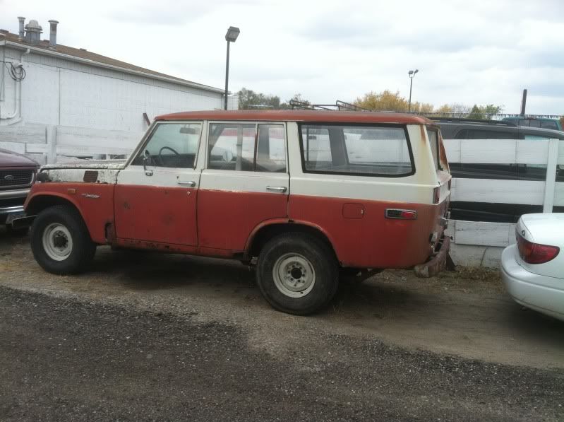

I think I owe you the beer, let me now when you tear into it. We have some motivated people here in iowa.
Yep, I think you do...You probably dodged the bullet when I bought it before you did. It had to be drug onto the hauler. The wheels would not turn, not sure if it was due to the tires, brakes or locked up axles. It will be going on the hoist today....I am nervous to see what time and exposure has done to it.
Doc

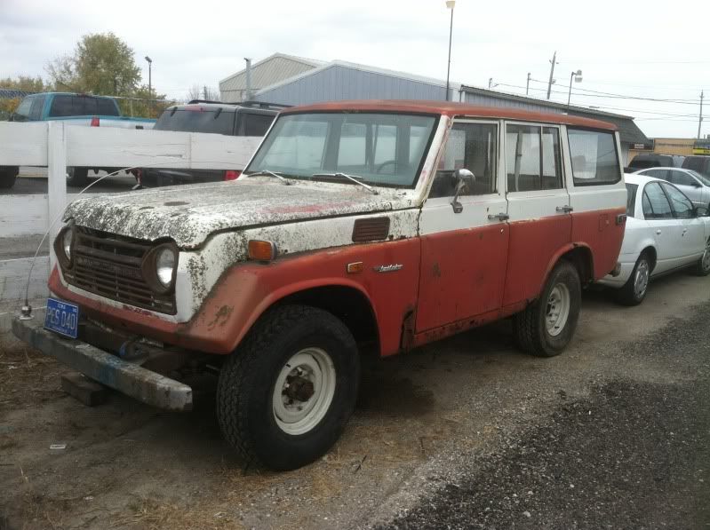

That tread pattern on your spare tire is exactly like my original stock spare. Looks like it's been sitting under that rig since it came off the factory floor. You have your work cut out for you!
Even the original spare tire...Nice ;)

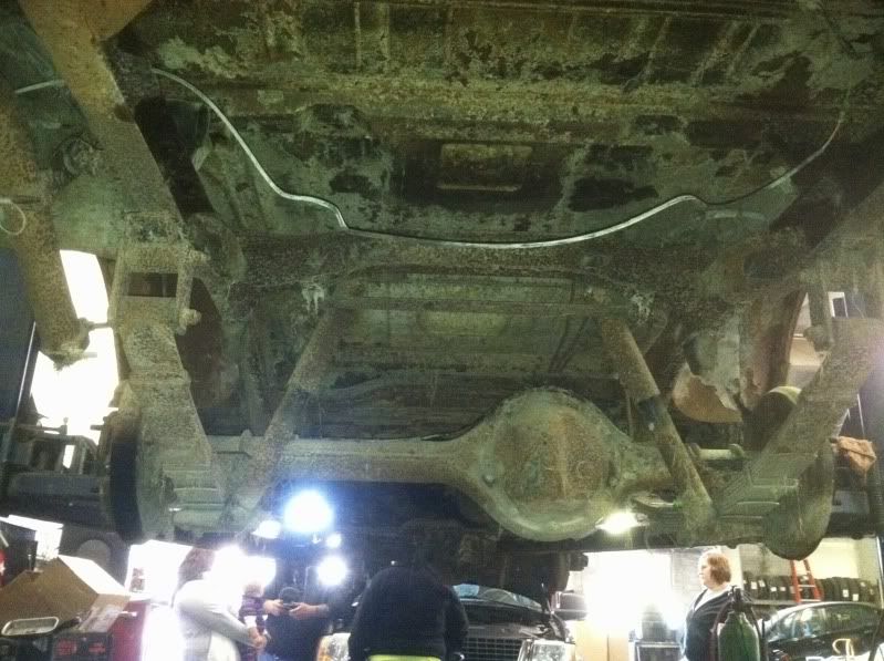

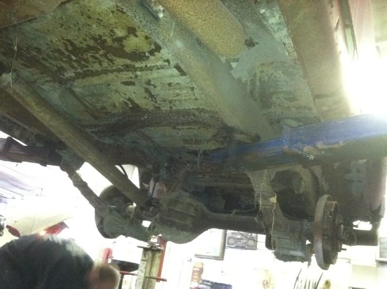

More pics...she is not looking too bad underneath.
Everyone at the shop is amazed that the old girl started up on the 4th turn of the motor after 20 (ish) years :bigthumb:
Doc
