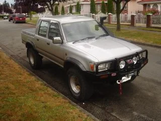

Hey any of you aussie guys have pics of a bobbed 1990 Hilux crew-cab pick-up.
Been trying to figure out if i should go bob it or do a flat deck...

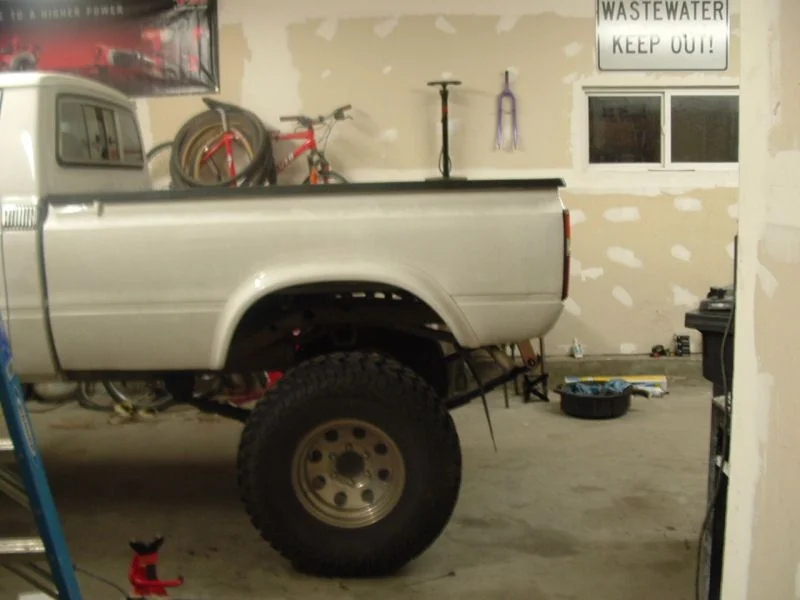

Here is a pic of my '82 bed that I took 14" out. The top lip is not bad just build up you weld and grind it smooth :cool: . For the cut across the bed I drilled a small hole through the outside sheet metal right above the floor of the bed on each side, ran a string across and pulled tight, and then lightly spray painted the bed over the string. Remove the string and you have a nice straight line to cut on. I agree with extremetoy1 measure, check, double check and cut. Take some pics and do a write up would be great to see it done. :grinpimp:
AWSOME job! looks good-the rocker/rear roll pan area looks good too!
