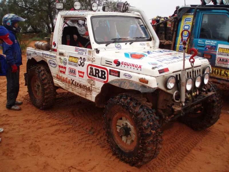

The best way to get a fast winch is to get a PTO. Check out the vehicles competing in the Malayasian Rainforest Challenge. The winner of this years Australian Outback Challenge had a PTO fitted to his Suzuki. It winched quicker than it could drive and believe me it was fast.

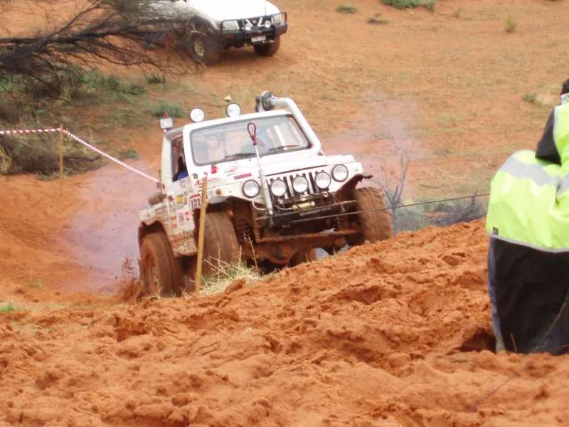

The suzooks from the outback this year ran datsun 120y diff centres driven by the pto so they were stepped up 3 to 1 in speed.

The suzuki in the OBC has a farken fast winch!!!
http://www.youtube.com/watch?v=XEvjxUt4gbI
That was awesome to watch in real life. The course up until that winch was cool too. There were a heap of tight hairpin turns that all of the full size rigs had to do three point turns around. The little Zuke had cutting brakes on the rear wheels and just slid round the corners without backing off the throttle:cool:

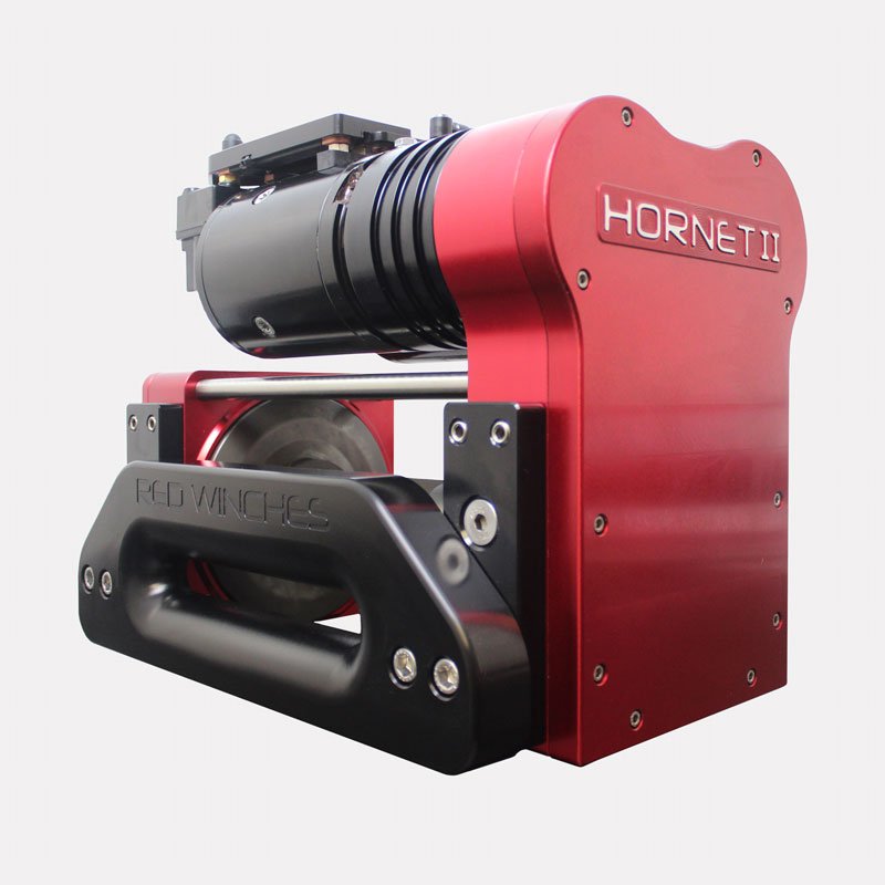

If you need a high speed and high power winch for racing , I think you must look into racing equipment only .
Forget the consumer base products.
I remember an Australian company red winch that does these kind of winches .
As a professional product you can choose the ratio /speed , drum size , capacity of the line ecc.
Not cheap , but if you are in racing nothing is cheap .
