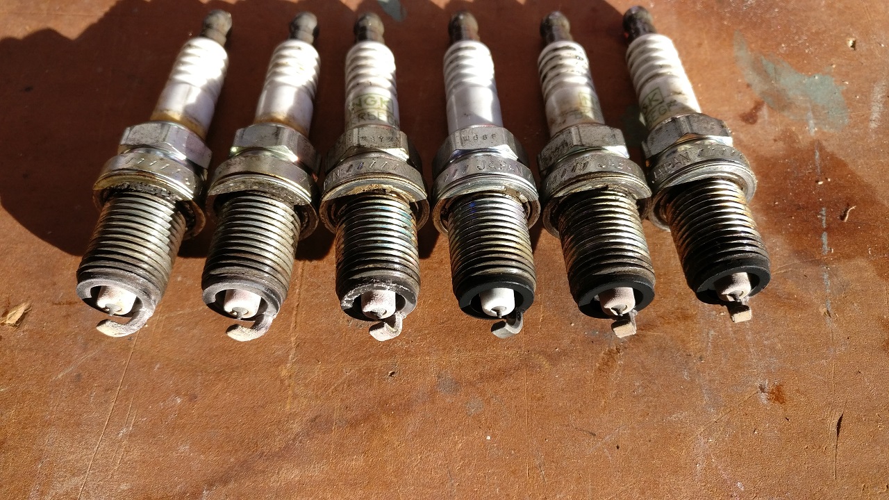

Shot of the plugs, crazy discrepancy on the gap. All were over .031, two were over .04. 2,3 and 4 were not tight at all in the head.
6 --> 1
