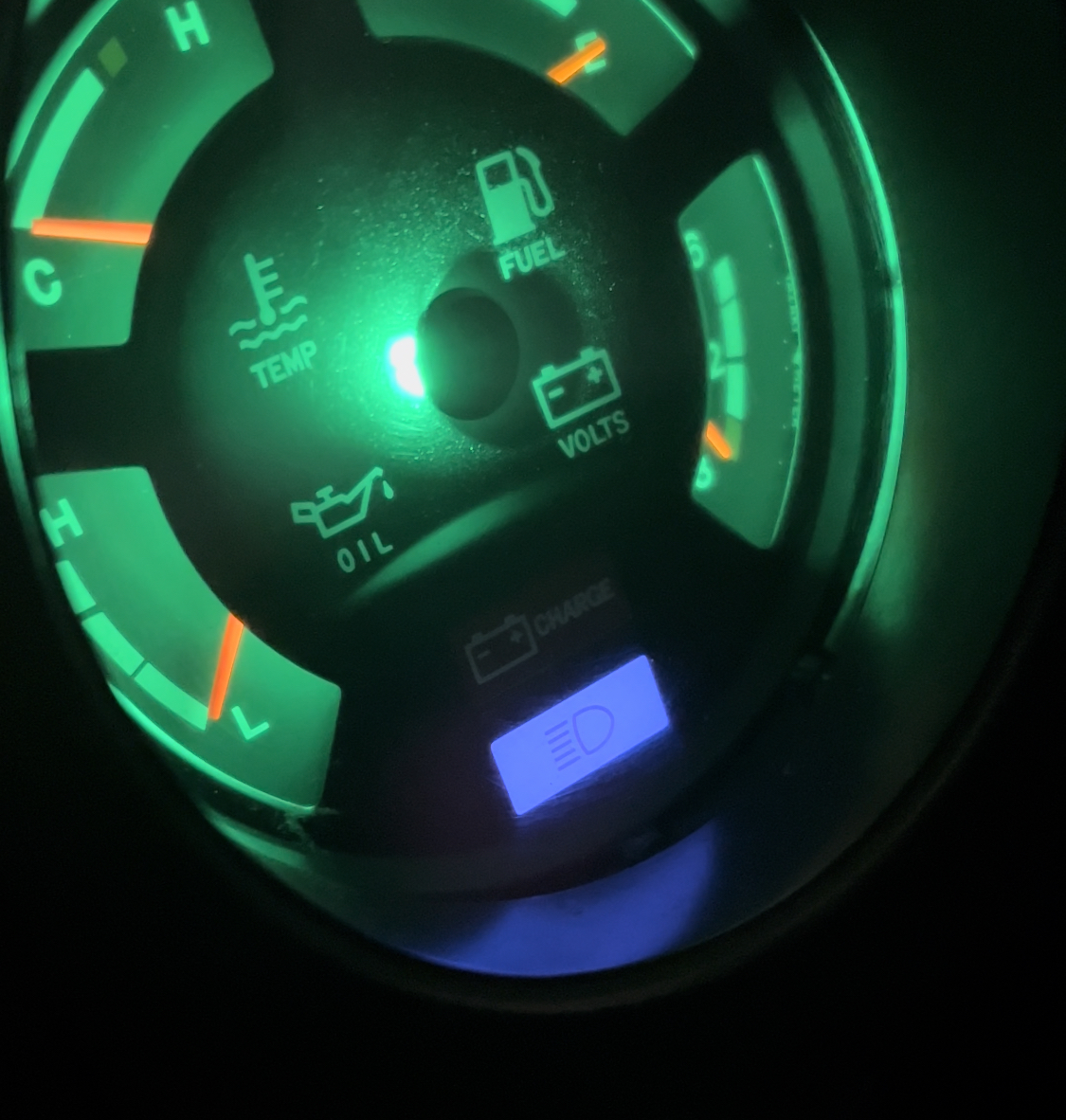

Tentatively have the solution. I tested with the incandescent bulb in my indicator and it worked perfectly, but still need to test with an LED. Once it’s vetted I’m going to figure out an elegant way to package them. I should be able to manufacture this as an affordable solution to the Koito Headlight Hi-Beam Indicator Problem.
Once the module is ready I would like to test it with other upgraded headlight harnesses. It may work - most of the harnesses seem to be wired the same way and the Toyota wiring in our trucks is a given. It may work for 4Runners, Pickups, and later 40s if my theory holds water.
FYI in the photo above my gauge cluster lights are 194 LEDs that are pretty bright. The high beam indicator comes on nice and strong.
