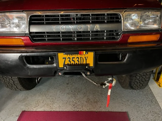

Ended up following your lead. Picked up a universal winch mount plate, cut it to fit, bolted my WARN 8000s onto it, and re-installed the Bumper. I notched the bumper at the bottom to accommodate the hawse and mounted the controller under my hood. Easy job and only ran me $40 in the end. Thanks for the idea!

Nice job on this. Do you happen to have pictures of how and where you mounted the controller under the hood?
It is still attached to the winch. The Smittybuilt has it offset to the passenger side.
Ah, I misinterpreted your original post. I thought you had moved it up into the engine bay. Makes sense now, thanks.
sorry for the long delay - I have been off of the forum pages for a bit. I made a bracket and mounted it on the DS fender where there used to be a bunch of vacc ine tubing garbage that I pulled out when I de-smogged her.

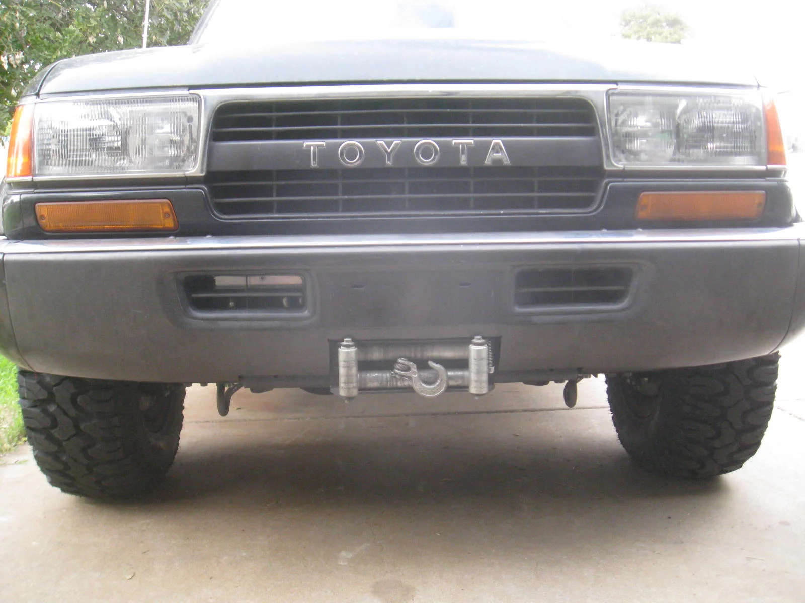

For those wondering what a finished hidden roller fairlead setup would look like if they didn't use a Hawse fairlead
So clean. What did you use for the fairlead cover? Also, how did you wire up your controls?
The front hidden fairlead cover came with the winch when i bought it, sorry to say Ramsey no longer offers it for sale, As for the controls, i didn't like the plastic solenoid box that came with the winch, it was just to big so i made a more compact one out of aluminum sheet metal to house the solenoids
