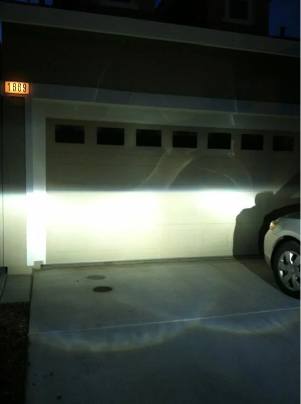

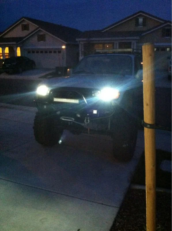

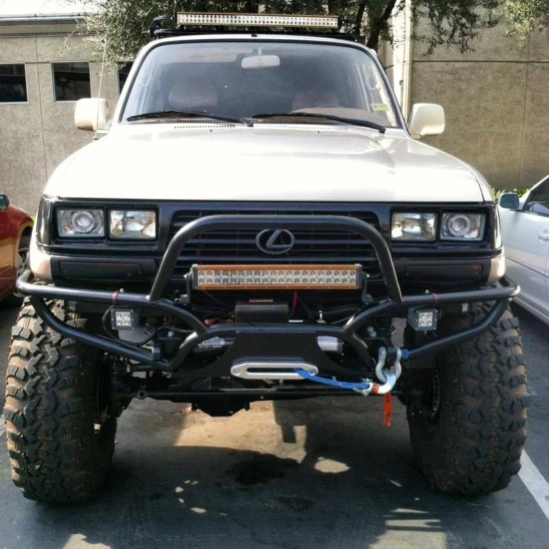

Here's the dapper with 35 watt 5000k
what a beauty .. !

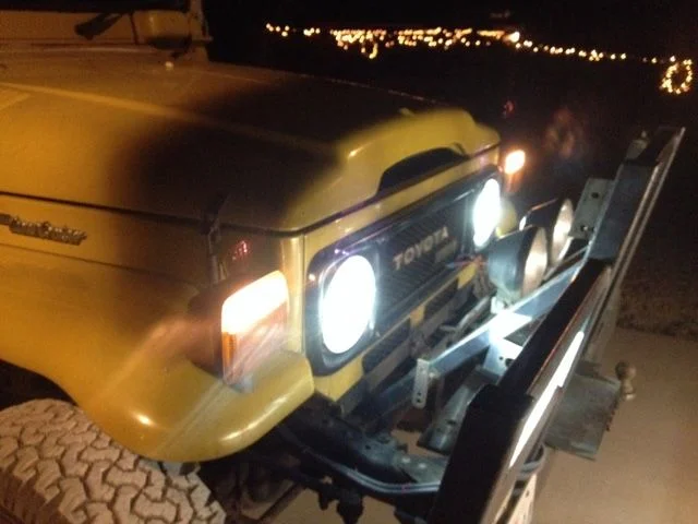

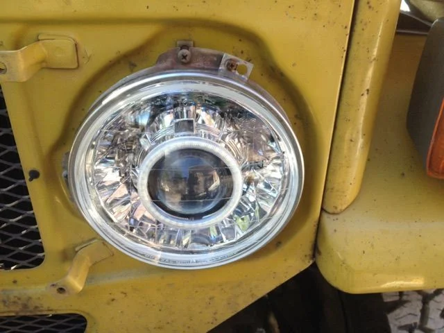

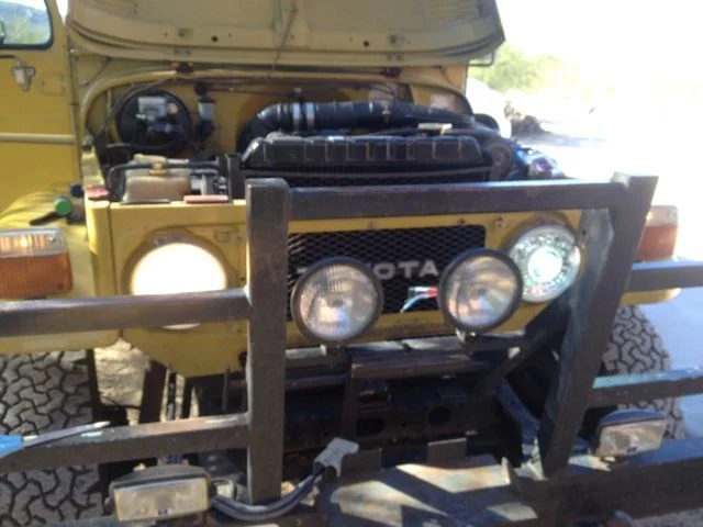

I couldn't decide between Dapper Lighting and HID Projectors, but needed projection headlights before thanksgiving, so my bro could install it for me and teach me some electronics along the way.
Prices were comparable from both companies for the HID w/halo, but Dapper is located NorCal and could ship to me quicker.
Ben from Dapper was helpful and helped me choose the Classic V2 with 35w bulb for my troopy.
We noticed the halos were not on and read that it can be connected to the parking lights. Off to the store to buy spade connectors and T-tap connectors.

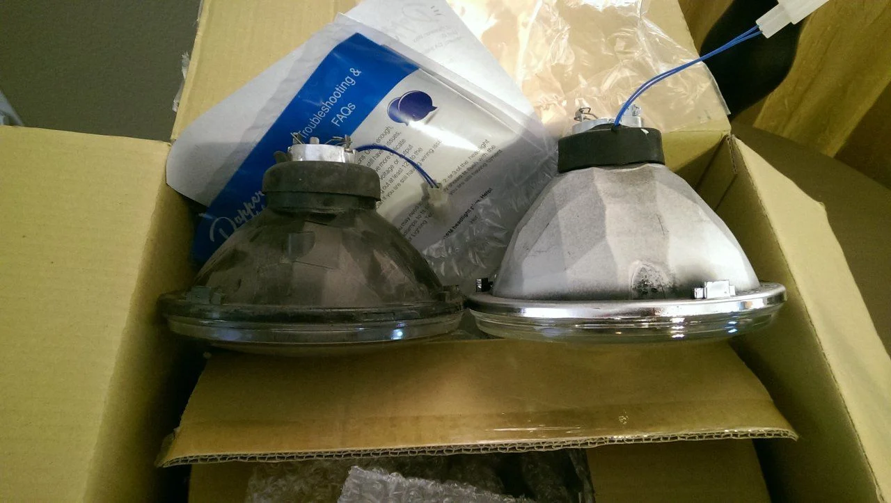

I picked up a set opf the new 7" V2 lights to compare. The projector is significantly bigger than the Versions I currently have. Also, the V1's have air vents in the housing itself. The V2 do not seem to. So @brokenparts, it sure seems to be more likely that the V2 7" projectors will fit your needs better.
Also, they put out more light. (Those pics will be posted tonight!)
The back side

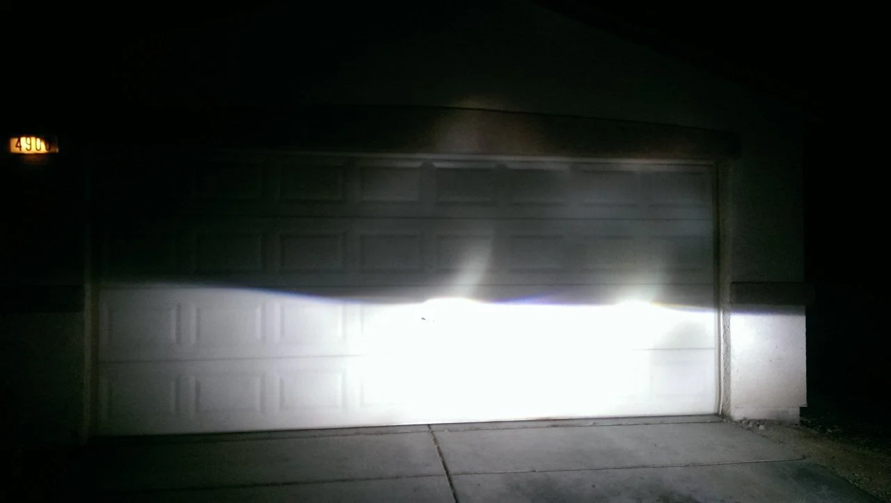

So, a couple comparisons..

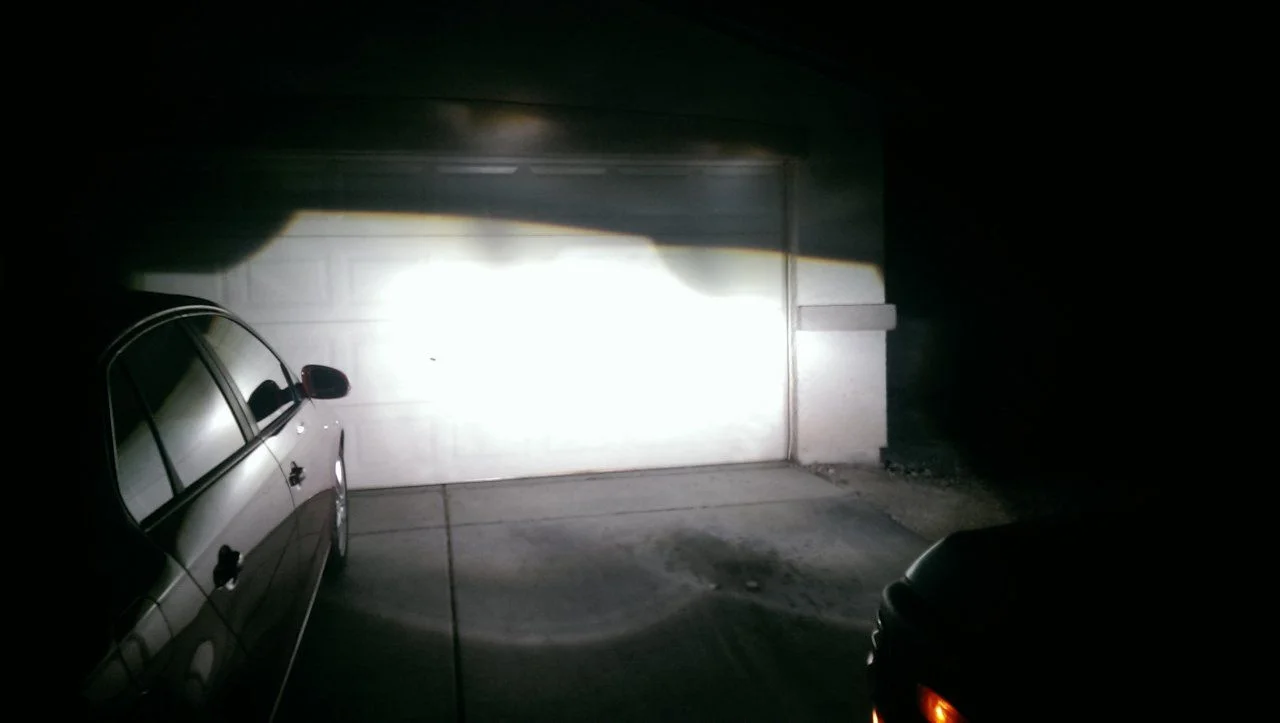

V1 lights

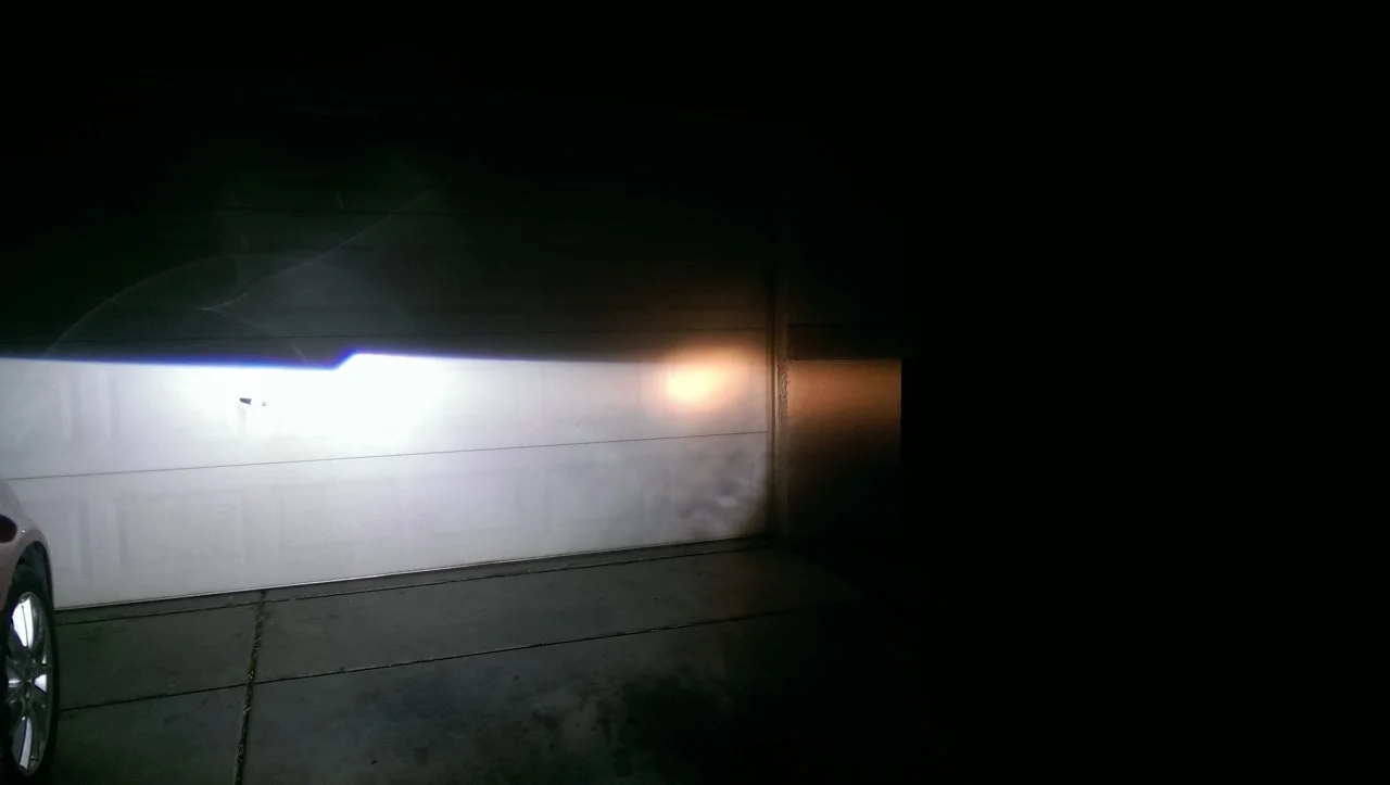

V2 compared to the sealed beam halogen head lights

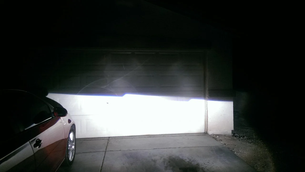

V2 vs V1
not half bad really, but here is the V2 on both sides
Cut off is better, and light output it increased..

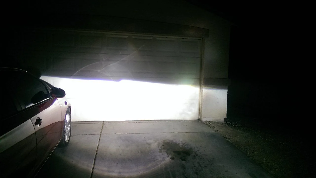

High beams
All light output is increased. I do need to spend some time adjusting the headlights, cause they are really bright!
BTW, this comparison is using the same HID bulbs. I just swapped out the reflectors..
Amazing the difference..
The cutoff in the V2 lights is significantly better, which is a very good thing.
The difference between the high beams and the low beams is a physical shield that moves up and down.
