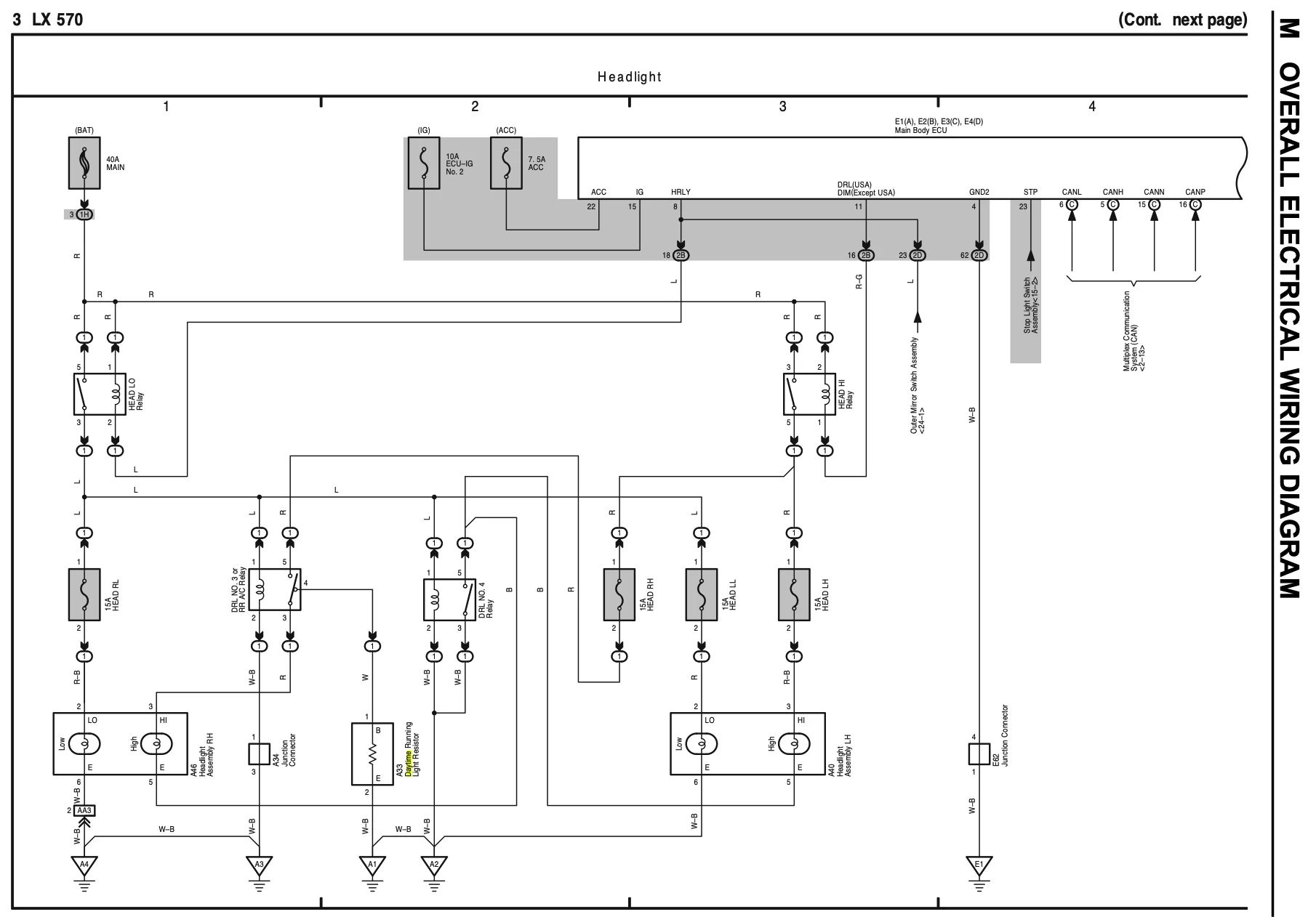

Hey all...posting this in a new thread as I am at wits end (getting old ain't for sissys) and really flustered....hope someone can help.
Use case: Toggle lightbar on '10 LX570 (DRL enabled) via hi beam stalk, all else OE. Truck lighting config is such that DRLs (fuse #55 for example) will trigger the relay coil (lightbar would be on ALL the time) so I need JUST the hi beam ground. Using only a cabin switch for the lightbar is just not practical/safe.
Thanks to @marques write up the coil side of the relay is to be connected to the lo beam 12V (the easy part)..... the "other side" of the coil would be connected to the hi beam switched ground.
Identifying "where" I tap the hi beam switched ground point is the ask for help. Where physically does one tap? What wire?
Alternatively, is there a "place" to tap the hi beam stalk itself?
Yeah, I know I could disable the DRLs and just use the fuse out, but I like the "safety" of the DRL's.

In this schematic, we're talking about pin 1 on the high beam relay. It would be under the relay itself. This wire doesn't go out to the headlamps, but rather to the main body ECU.

Many thanks, really appreciate the assist - no worries that pin one is "internal' and feeds the ECU? This is how you wired your aux lamp(s) correct? I get "sweaty" just thinking about anything with ECU in the same sentence!

UPDATE - wanted to close the loop with the somewhat surprising outcome of my lightbar install. I pulled +12v directly from the HB3/9005 connector - right at the HB3 connector. I ran the other side of the coil to an illuminated switch, circuit then terminating at ground in driverside kick panel. It appears that the DRL voltage is not enough to trigger the coil.
So, net /net:
1) switch off - everything functions as normal
2) switch on - everything functions as normal EXCEPT light bar toggles w hi beams. The switch illuminates the foot well area as a reminder (like you need to be :) ) the light bar is engaged
