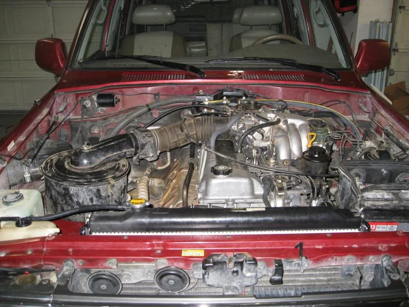

HG replacement in Elk Grove is underway

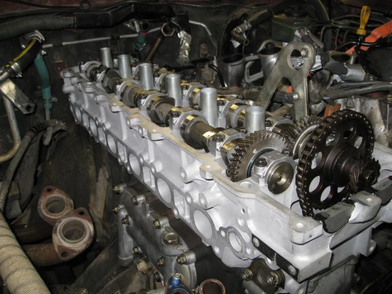

Looking at picture #2, the gaskets are still on the block! They are black and pretty thin IIRC. I am sure you figured that one out when cleaning the block.
:cheers:
Steve
Haha....yes I did. I edited that post for "accuracy." It was stuck on there but the two gaskets were missing from the cooler to cover which was most likely contributing to my "gunk" on the radiator cap that I could never get rid of.

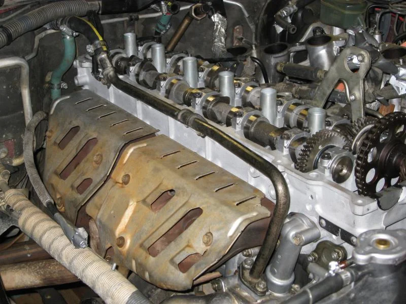

head's on!
On the downhill side of the job. With some acrobatics and pilates - got the head on and snugged down. The 2 90 degree turns make a man out of a 'girl' wanna be mechanic like myself. Hard to get leverage on all 14 bolts. After the head turmoil - went with new head bolts (OEM). Exhaust side is complete and tackling the intake tonight once the kiddos go to bed.
I've also spent a considerable amount of time cleaning blue RTV off of every connection / gasket surface from previous owner's head gasket job. Doug's tips/tricks are very helpful (exhaust reinstall) to save time but are eclipsed by all the clean-up and "while I'm here stuff." I also have my very own "Mr. T hologram" nameplate which was missing from that reman'd head before. Complete OEM head - "street value" of the truck just went up like $3000 I'm sure! :-)

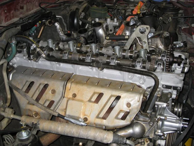

exhaust complete
More pix. #3 is the best part of the job....Isn't that part of Step #6?
Wow, great job. Is any particular type of assembly lube spec'd for the cam shafts etc?
Nothing as part of the reassembly, per se outside of oil on the thrust surface portion of cams per FSM and oil on the valve shims for the lobes to ride on as mentioned in Doug's DVD. That being said - with my complete valve job, Del's used lithium grease (IIRC) on all the moving parts and surfaces (bearing caps, cams, etc).

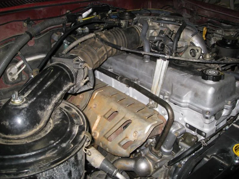

HG DONE!
HG job complete.
Had a good fight with the EGR valve and the distributor ended up a tooth off but she's all back together. Took for a test drive and no CELs.
I still need to set the timing and probably readjust the throttle cable since it's currently idling at 1400 RPMs per the Ultragauge. Once complete I'll put the hood back on; don't want to jinx things.
