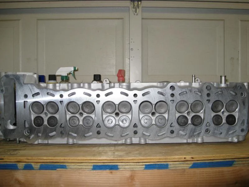

I sourced a used, uncut head in the bay area earlier this week and has passed inspection at the machine shop (Del's). Based on original measurements of my original head, my HG didn't fail but my head did, being warped in a rainbow fasion which would explain the coolant seap I found between 3-4 on the intake side. Getting the "Full Monty" valve-job done, including adjust so we'll see how things turn out (approaching CycloSteve $$$ territory now). Shop needs to source some new guides which will be putting the job a day behind. Hopefully I'll have the head by 7/25.

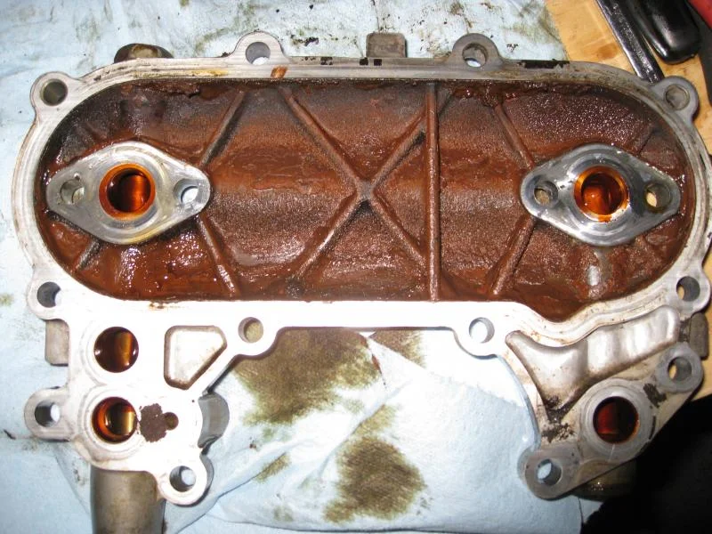

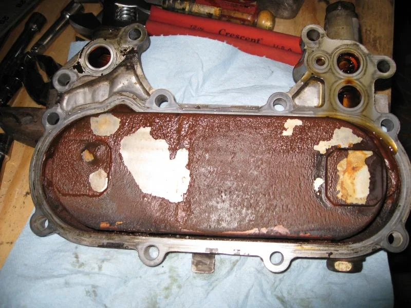

Oil Cooler neglected. Not only was it neglected but there were no gaskets for the oil cooler tank assembly (two) to the cover. Here are the before pics (no afters but it's pretty spotless now).

Head is back from Del's and had a good experience; a lot lighter in the wallet but good guys to deal with for a newbie :banana: mechanic like myself. Complete valve job, new intake guides, seals installed from grind kit, pressure test, straightened, valve adjust. They're only comments were "hard to source the guides" and "longest part of the job was the adjustment." They delivered on-time of their estimate even with having to go out-of-state for the guides.
Head is going on tomorrow night.
Pix of the fresh head
pix of the head....
Oil Cooler neglected. Not only was it neglected but there were no gaskets for the cover nor the oil cooler tank assembly (two) to the cover. Here are the before pics (no afters but it's pretty spotless now).
Looking at picture #2, the gaskets are still on the block! They are black and pretty thin IIRC. I am sure you figured that one out when cleaning the block.
