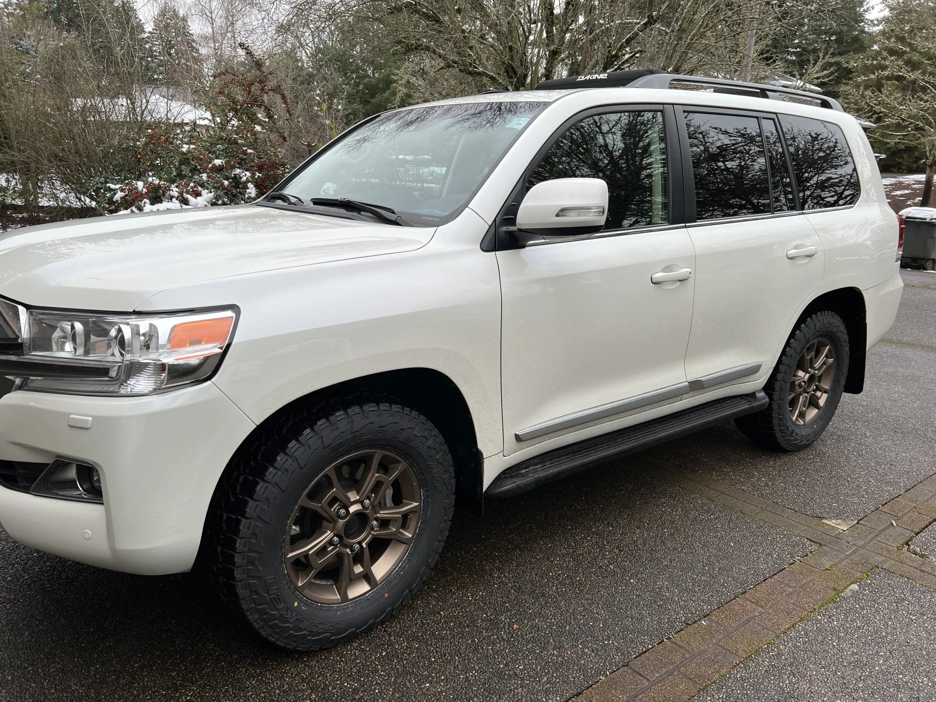

Hi so I got a set of heritage edition wheels on my 2017 land cruiser yesterday and wanted to ask a couple of questions for anyone else who has managed to get these wheels :
1. Are the heritage edition wheels supposed to come with the Toyota center caps? Mine did not. I’m checking with the dealer why but wondered if anyone else’s did.
2. Do the heritage edition wheels come with black lug nuts? The dealer just reused my existing silver ones - should I have expected new black lugs to come with the wheels ?
Pictures of the wheels installed attached.
Also my TPMS sensors are not working on the new wheels and tires. Tried hitting the TPMS reset button under the steering wheel but that didn’t fix it either. Not sure what the dealer did wrong. They installed 4 new TPMS sensors so they should be working.
Tpms sensors have unique ids. If the dealer didn’t use techstream to replace the previous ids, the new ones won’t register. They could have used non oem tpms, which have programmable ids and cloned the previous IDs, but if so it would be working.
The covers and lugs are definitely different parts. If you didn't order them as well, then you wouldn't' have gotten them.

Also my TPMS sensors are not working on the new wheels and tires. Tried hitting the TPMS reset button under the steering wheel but that didn’t fix it either. Not sure what the dealer did wrong. They installed 4 new TPMS sensors so they should be working.View attachment 2878162
1. No
2. No
Find out what kind of TPMS sensors they used.
If original toyota, you need the sensor ID of each one. With that information you can use carista pro or techstream to reprogram your vehicle to receive info from those IDs. Toyota or pacific industries (denso reboxed usually) are not clonable, but last much longer and have less faults than the aftermarket parts.
If they used aftermarket clonable sensors, you’ll need someone to get your original IDs with a scanner, or use carista pro or techstream to read the IDs from the vehicle. Then someone with the correct TPMS programmer tool can clone the new sensors to your old IDs, and the vehicle interprets them as if they are the original ones. The catch with this is the old sensors need to stay a few hundred feet away from the vehicle or it will get confused by multiple readings from a given ID (the clone and the original)
Black lugs can be sourced.. search around in this section.
Edit: the TPMS reset button is merely to set a new default pressure into the computer. Stock is 33, but many other tires will need a different cold inflation pressure. If that new number is say 40psi, the old low pressure light trigger number won’t be correct anymore.

TPMS parts they used are
42607-48010 which I believe are Toyota OEM parts.​
Good tip on the distance of existing sensors. I will bring that up with them.
Sensor distance only matters for clones. OE ones transmit with a different ID that is programmed into the vehicle so the computer can deal with that just fine. Same as a Toyota vehicle sitting on a dealer lot, or near other Toyota in traffic.
You just need the IDs from those new sensors and a method to program them in.

If they put 4 new Toyota sensors in, then you don’t have to worry about distance. Those sensors will need to be programmed to your truck. They may have just forgot to do it.
