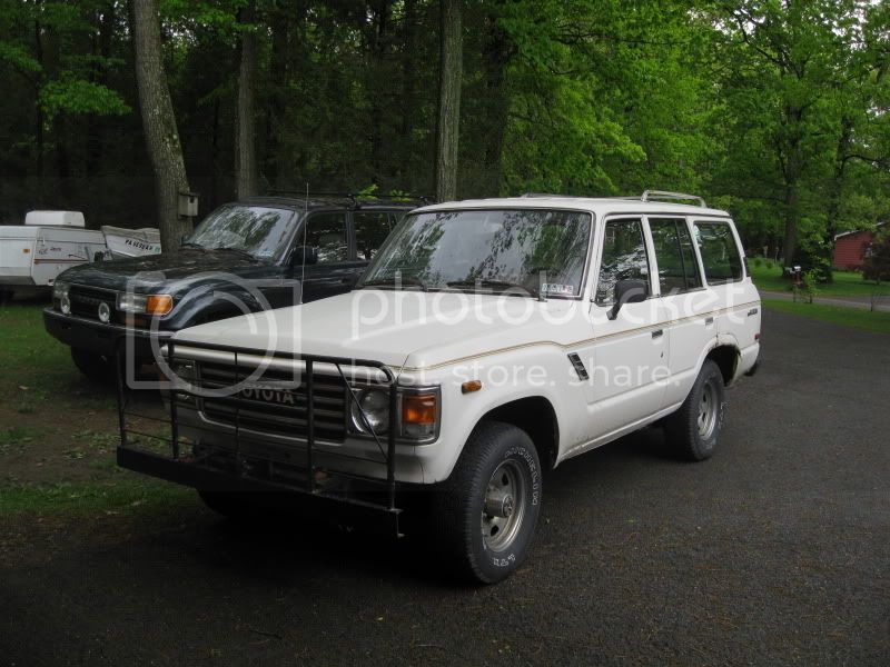

I just picked up a 83 FJ60. I really like it, carbed, manual choke, 4-speed, but its gonna take a little getting use to. It rides a lot like my old 67 Dart, kinda floats along on the road. I think the steering and handling needs some improvement.
It has a few issues,
rusty 1/4's and lower tailgate
fuel gauge doesn't work
Tach doesn't work
leaf springs are weak

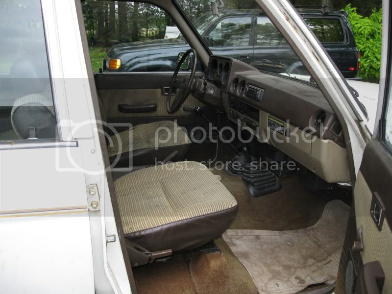

Shifter seems to be "sloppy"
Is it normal for the steering to feel "loose"??
How about the play in the shifter?? Its shifts ok, there is just a lot of play when in gear. Is there a bushing kit or something to "tighten" it up??
I would greatly appreciate any help, tips, ideas, or suggestions from anyone that is familar with the 60's.
Here are a few pic's of the "Crusty Cruiser", the wife named it that tonight during here first ride in it. :rolleyes:

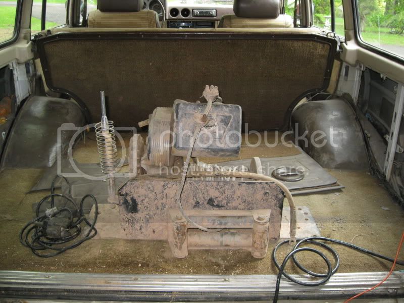

He also gave me this Warn winch with it.

As far as the shifter goes, there is a bushing in there and it wears out over time. SOR (specter off road) sells a neoprene replacement that should last longer and stiffen it up a right.

Sweet, and a great winch to boot. let me know if you want to sell it.
do I see spray foam filler in the drivers side rear quarter?? :) I really, really , really wanted to go back to a 60 series but, I had to settle for something else to keep the peace....

That green 80 looks very familiar!

Yes, that is spray foam. :doh:
I'll gladly take the hatch off your hands, thanks.
