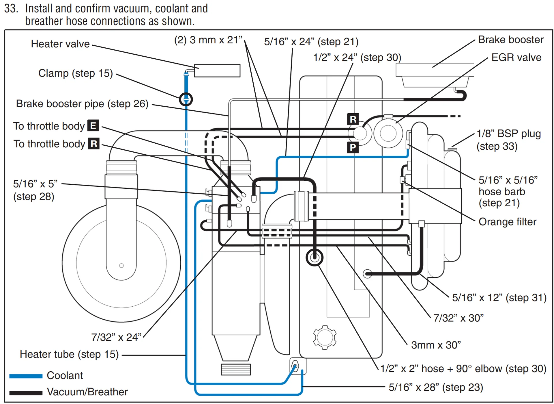

E eric90503 10 Year Joined Feb 25, 2012 Threads 34 Messages 252 Oct 4, 2023 #1 Does anybody know where this brass elbow hose is supposed to go to?
doc_random 10 Year 15 Year 20 Year Joined Aug 1, 2005 Threads 4 Messages 235 Location Chandler and Prescott, AZ Oct 4, 2023 #2 Attachments Supercharger installation.pdf Supercharger installation.pdf 3.3 MB · Views: 125
