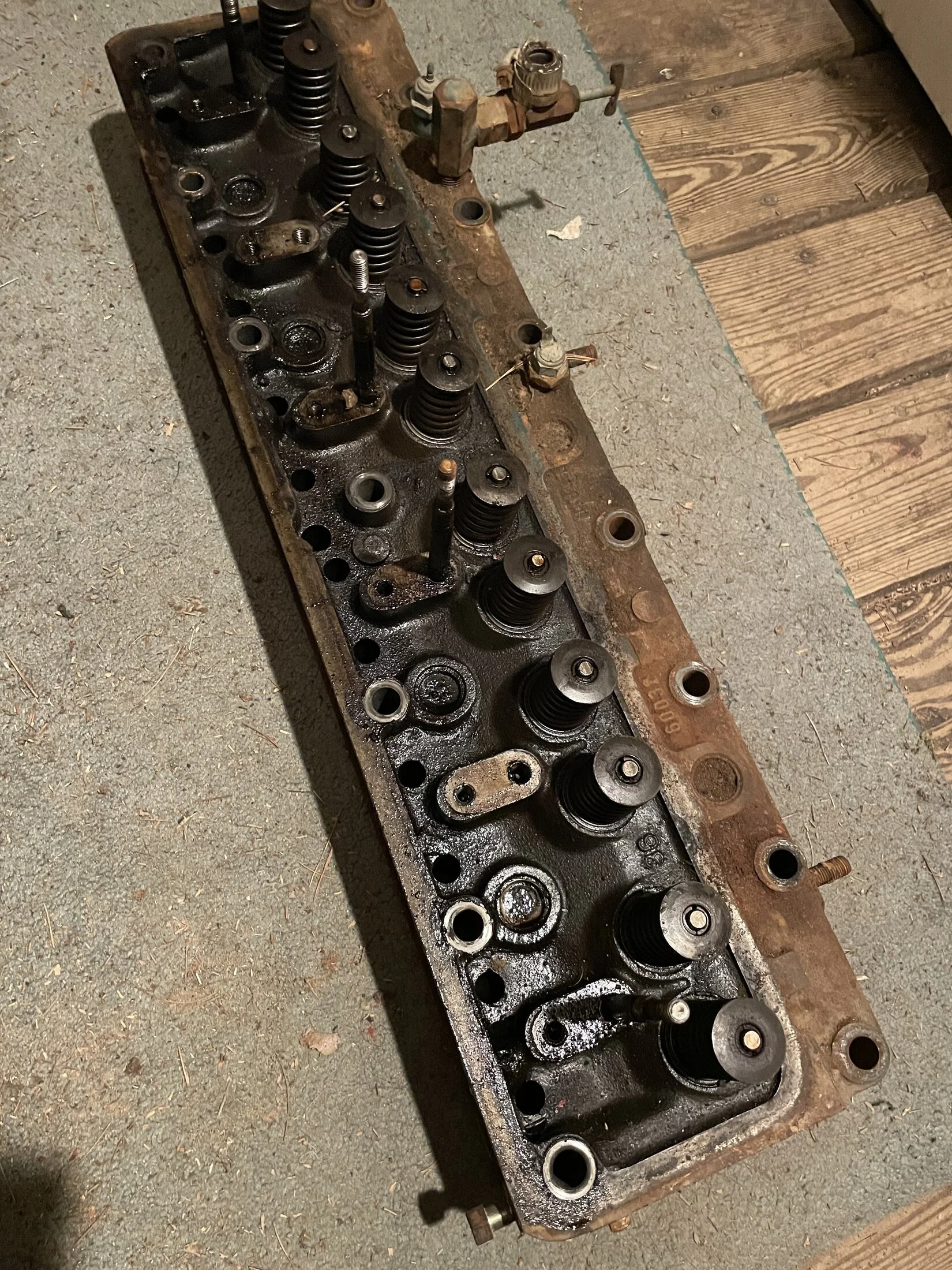

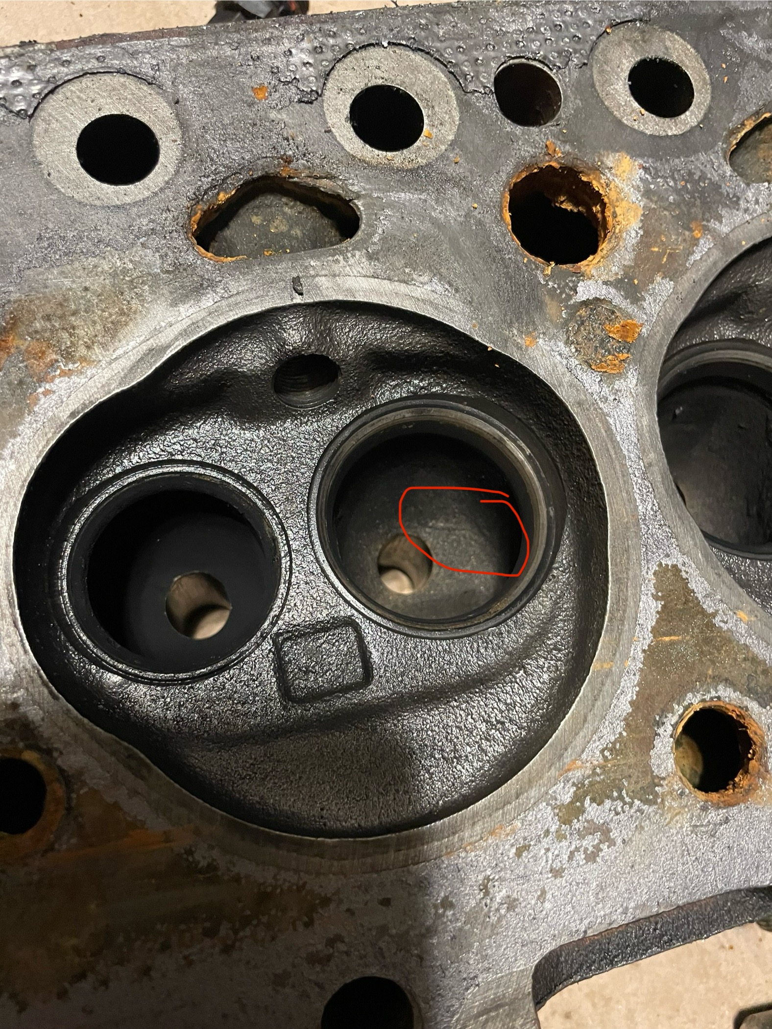

So, my 72 has a crack in the water jacket on cylinder 5 valve area (pic). Its casting is 60050. I have an extra rebuilt head with casting 60030 that came off a 1969 engine. Can I replace it with this one? Thx.

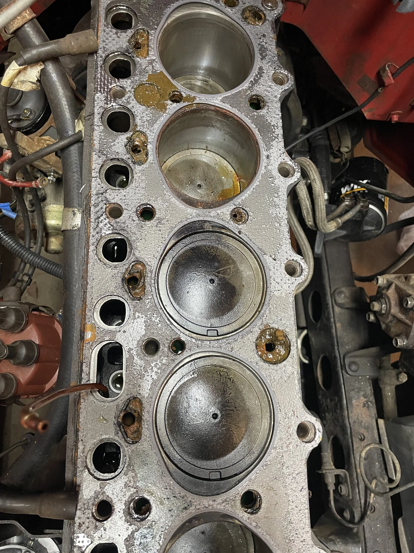

Thx Mark. The pistons are domed. Heres pic. One can tell how Cylinders 5&6 were affected by the cracked head.
You will have a slight loss of compression with the 60030 head. Also you will lose the end holes where the exhaust bolts up, which is more significant with a header than a stock manifold. And you lose the third mounting boss at the forward end of the passenger side, where the tow hook goes.

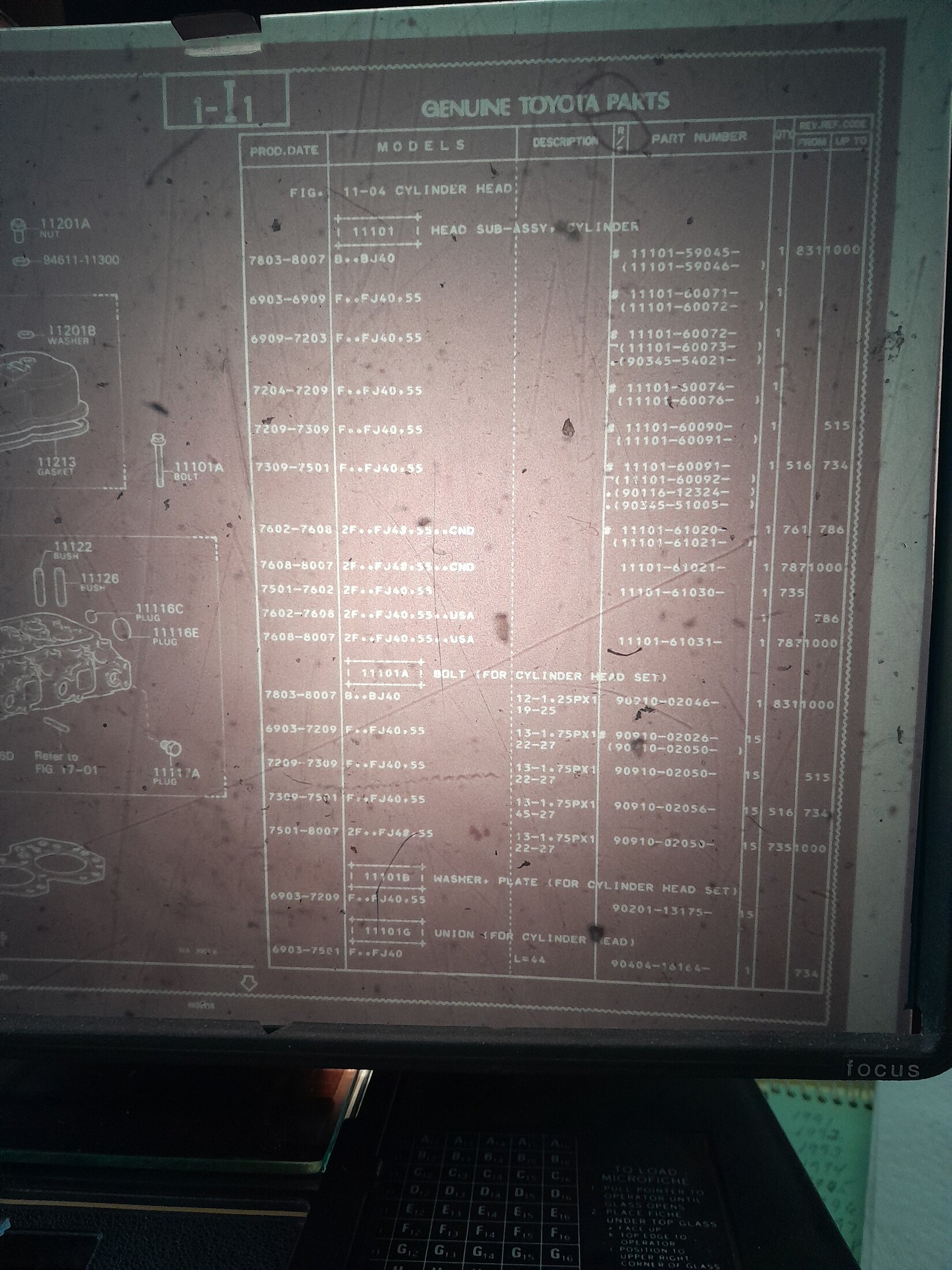

I think I'm seeing three different p/n's for the year 1972 depending on the month of build. I just don't know enough to comment on the p/n's you posted. The microfiche pic covers the US and Canadian markets for the period from 03/69 to 07/80.
I was going to tag YOU on this, just because you have ready access to the microfiche. Thank you!😊
Unfortunately, the microfiche numbers don’t match the original casting numbers, so we’re still left to my anecdotal observations.

The 60050 should have a third hole under the fourth rocker arm stand, making it an F.5 head.
Wow thx for all the help! The microfiche is awesome; it coincides with what I’m seeing on the different 1F engines I have. I have a 74 engine at home and will have to see what the head casting is on it. Looks like the head on my 72 got replaced with a 74 head.

They are on the driver’s side, topside, between the second and third head bolt.
While not as easy to identify there is a date of manufactured on the left side of the head as well.
