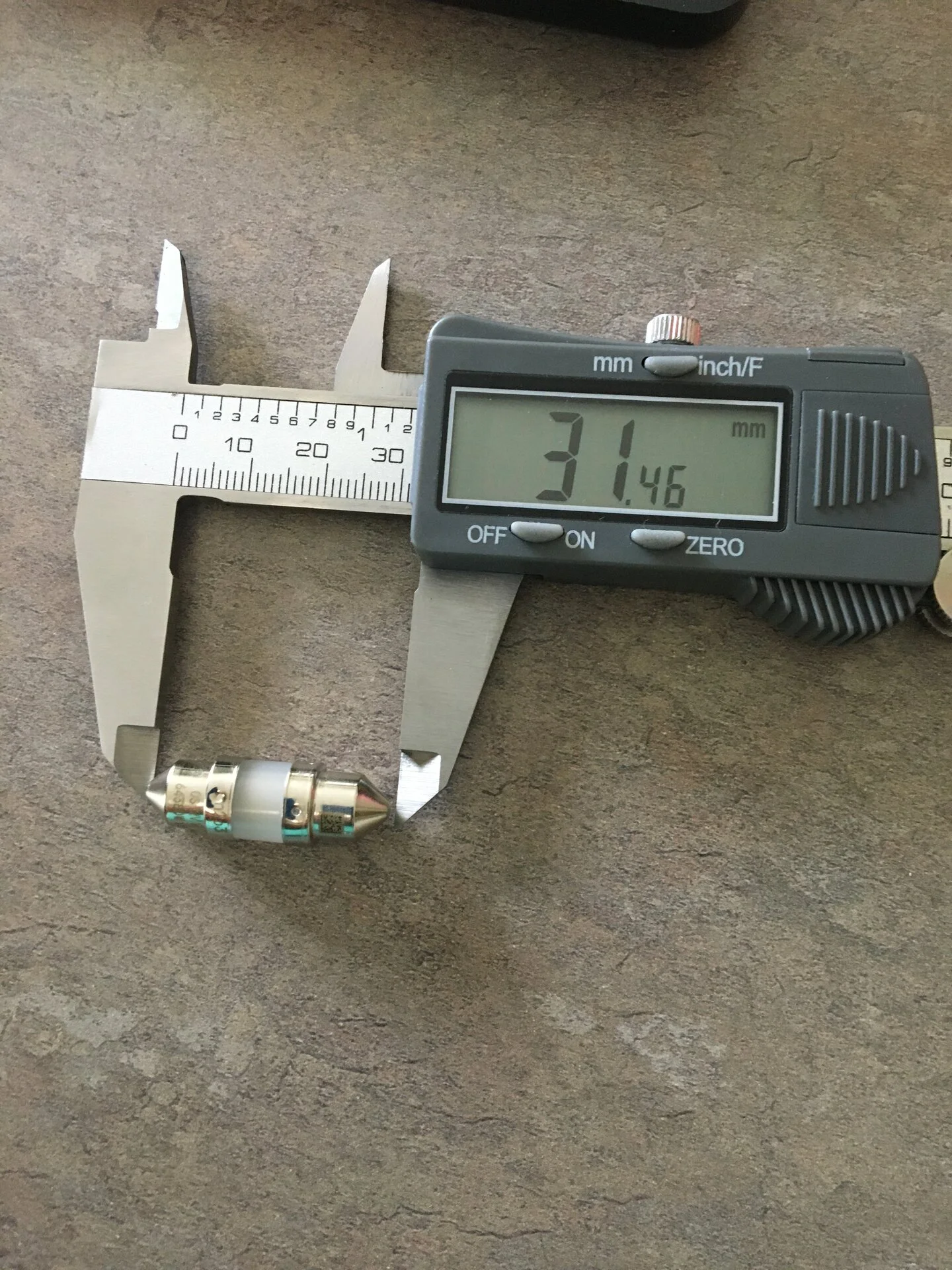

Does anyone know what the number is for the bulb in the ac/heater control panel. The old bulb only has 12V2W on it . I went to three auto parts stores and no bulb comes close to it. I replaced the bulbs in the instrument panel with LED's. I was told 3022-WWHP4-V2 was the correct but it's too long.

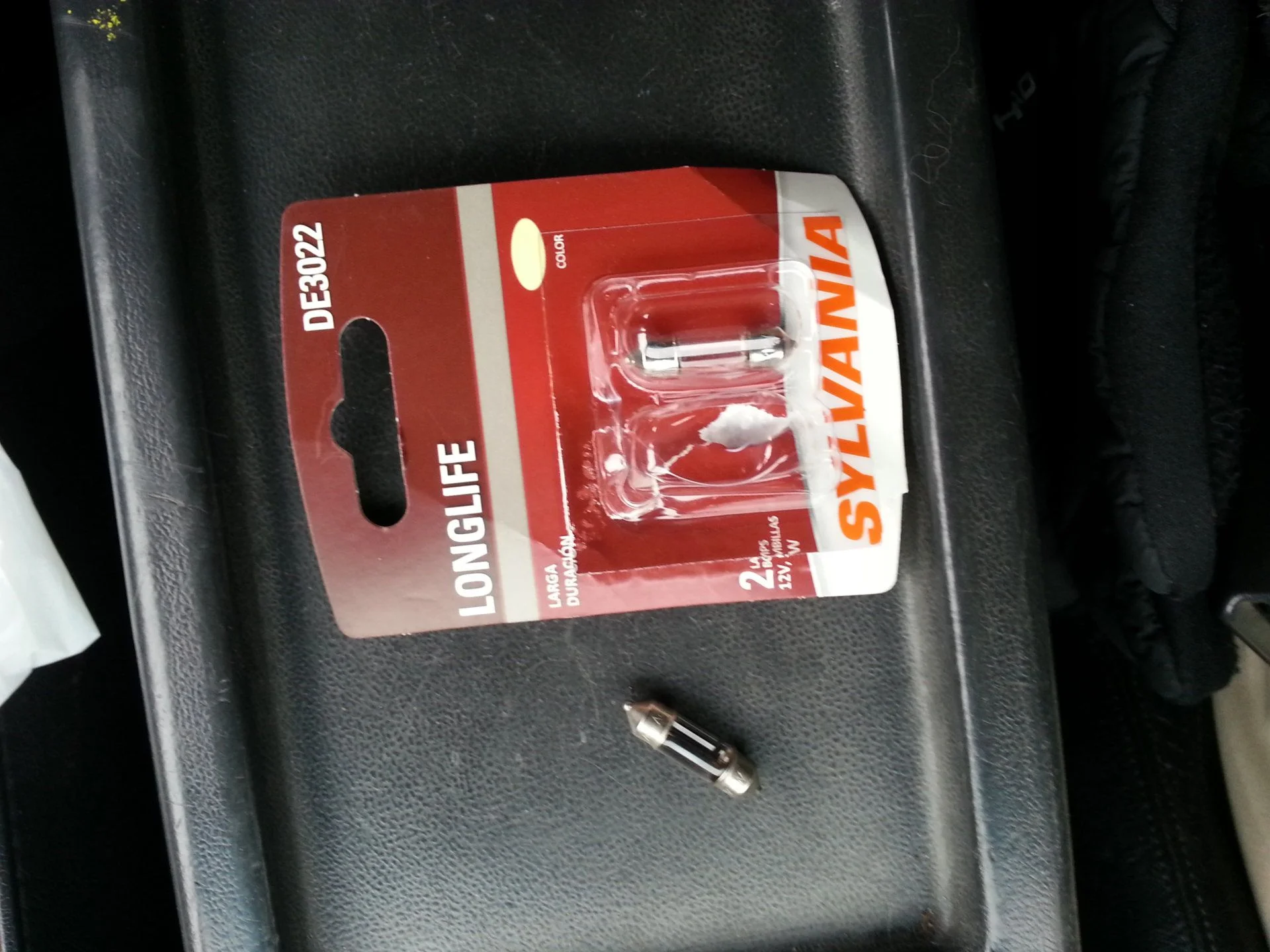

Found this one at a local O’Reilly. 3022 12v5

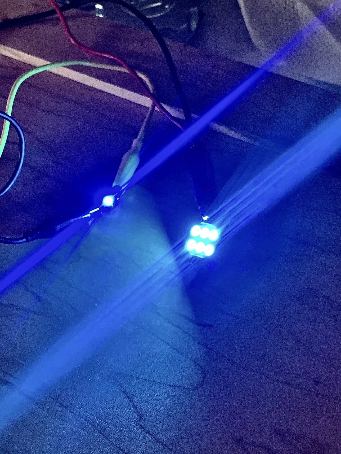

Working with my folks in South Korea whom i have been lucky enough come across long before idea of having a family run online parts store , recently sent me my first special-order custom-run of matching Color Temperature Lumen LED bulbs i spec'd to do what i like to do and what i feel will update in a Period Correct way to bring that very savoy translucent plastic selector levers face-display and its 2 stand alone transparent bottom facing illuminated directional Switch Panel lenses into more then a present day standard .... :cool:
tech. photos here in a moment

below TECH. photos are my personal FJ62LG-PNEK
NO mods
plug and play
specially designed and kustom made to my spec.s of : color temperature lumen spectrum to match the FJ60 / FJ62 HVAC selector levers panel in the nicest possible way was my objective here ...
- this IS a KIT form product offering that ALSO includes the correct LED diode infused bulb for the BLUE A/C little round push button selector switch it self too ....... 🔮
- as someone who wears prescription eyewear , i personally find it much safer to drive at night , when i can actually see out of the corner of my eyes the much crisper and brighter modern lumen factor in every possible way , and NOT have to take my eyes off the road in front of me for i single metric second , when making a tweak to any of the HVAC panel levers and switches .....:D
and this is a good thing ...:idea:

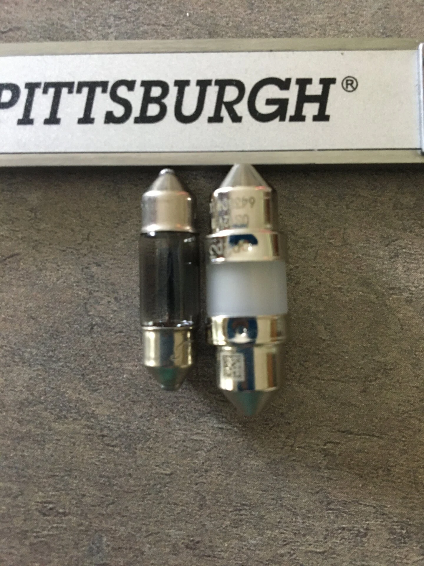

I saw that one today at Oreily’s also but I was afraid to put a 5 watt bulb in . The original bulb was 2 watts so I ordered the same bulb in LED.

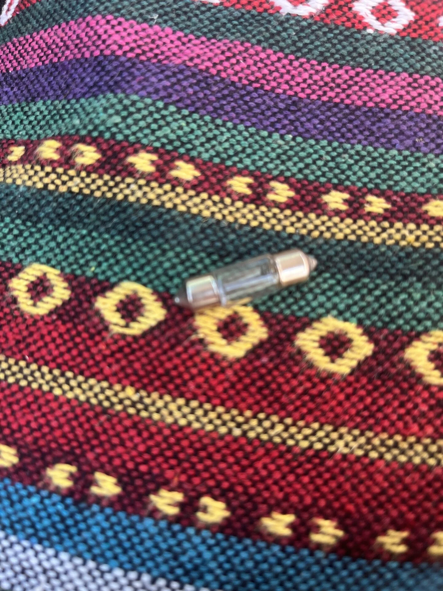

I used the 5 watt bulb 4 years ago...never had a problem . this one:

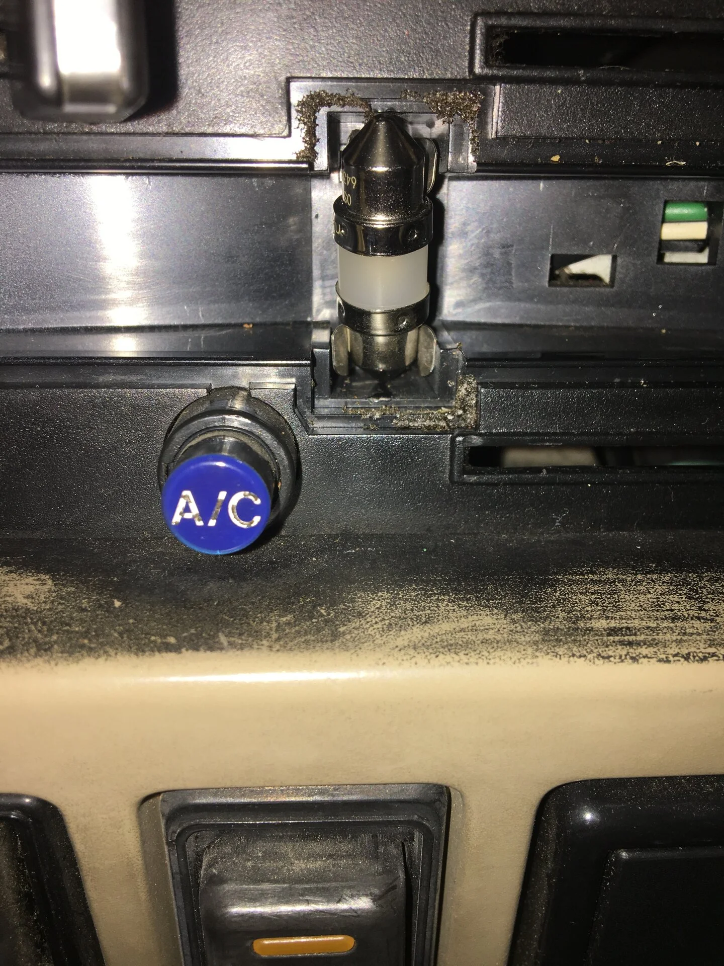

20190210_141247-jpg.1920020
