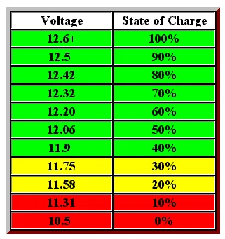

Your battery is too far discharged. Anything 12.5V and lower is bad. I would suspect a bad battery unless you know you have a drain on it.
I've had NEW batteries that were bad.
Have it checked.
Not as bad as we might have expected... I'd recommend pulling back the electrical tape on the connections and see how things look. While the tape is off clean everything up as @BILT4ME suggested.
While you are cleaning it up plug the battery into a charger and see if it will take any more voltage. Once everything is clean and the battery is charged reconnect each of the accessory wires while the multimeter is connected to the battery and see if the voltage drops at all. This will allow you to track down any parasitic loads, if you find one let us know.
