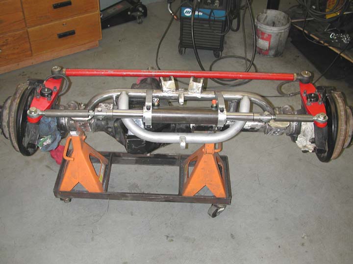

Hydraulic Assist Tech
I think I will use the 1.5x8" trailgear job as I can go to their warehouse in person to take stuff back.
Trail-Gear Inc > Ram Steering Kit
also considering this

Port went well. it was so easy I wouldn't call it hardcore. put it in the general 80's tech. https://forum.ih8mud.com/80-series-tech/212244-80-series-steering-box-porting-hydro-assist.html
