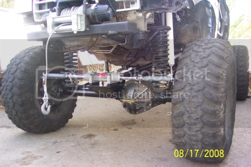

and now the tech.
my truck dont stop

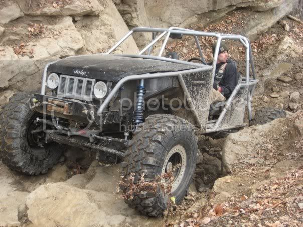

All you need is larger bore M/C to match the larger bore of your 1Ton brakes, doesn't matter whether it is a chevy or Toyota one. I want to say the largest Toyota bore I've heard of is around an inch. A buddy runs a E350 van master on the buggy below with a D60/14b, stops great.

thanks man you've been a big help. that is a sick jeepish like thing. lots of those e350 MC conversions on pirate

ok i just finished turning the pinion down so the pinion flange and the tcase flange are parallel and no vibration at 60mph
but there is another problem. the d60 in front has made this horible grinding sound from day one when coasting. its in the diff somewhere. at first i thought it was in the knuckles like if one of the axleshaft yokes was hitting the inner c. i thought this because when the axle was up on stands and the shafts were in i could feel a little bind at a certain spot when the shafts were turned. even when the lockers were locked. so a checked the c's and its not the yokes. with the axles are locked i can put either shaft in and get some of the same bind.
again i only get the sound when coasting. i can be accelerating at 60mph and the axle is smooth as glass but when i coast i get this nasty sound.
nelson, the guy who set up the axles thinks it may be the spider gears in the d60 arb but why is the noise there when the axle is locked if this is the case?
the noise is there without the front drive shaft too. the pumpkin doesn't get hot after a highspeed run
it doesn't bother me so much when wheeling in low range because im going so slow but i want to go fast. dont wat to trailer her now that the vibration is gone
if i cant figure it out im going to have the axle tore down and start over
