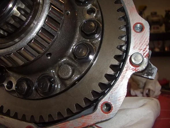

finished rebuilding the tcase with the marks gears today. not a simple job. i could do the next one in a fraction of the time.
key difficulties of the job:
the marks instructions are vague in several places. the most frustration is with where to cut the case to fit the larger gears. it is necesary to trim the oil shield slinger thing as shown in my pics. you also need to make one cut to the aluminum case itself like shown.
those that fantisize about making a lower gearset for the 80 case should stop. you cant get a larger low gear in the case. it wont fit.
this first pic shows the 2.45 low gear sitting atop the installed 3.1 low gear. not much difference
but enough that it barely fits in the case
the last pic is of the shift fork shaft support hole. of the low gear gets any larger that the marks 3.1 gear it will compromise this shaft support
