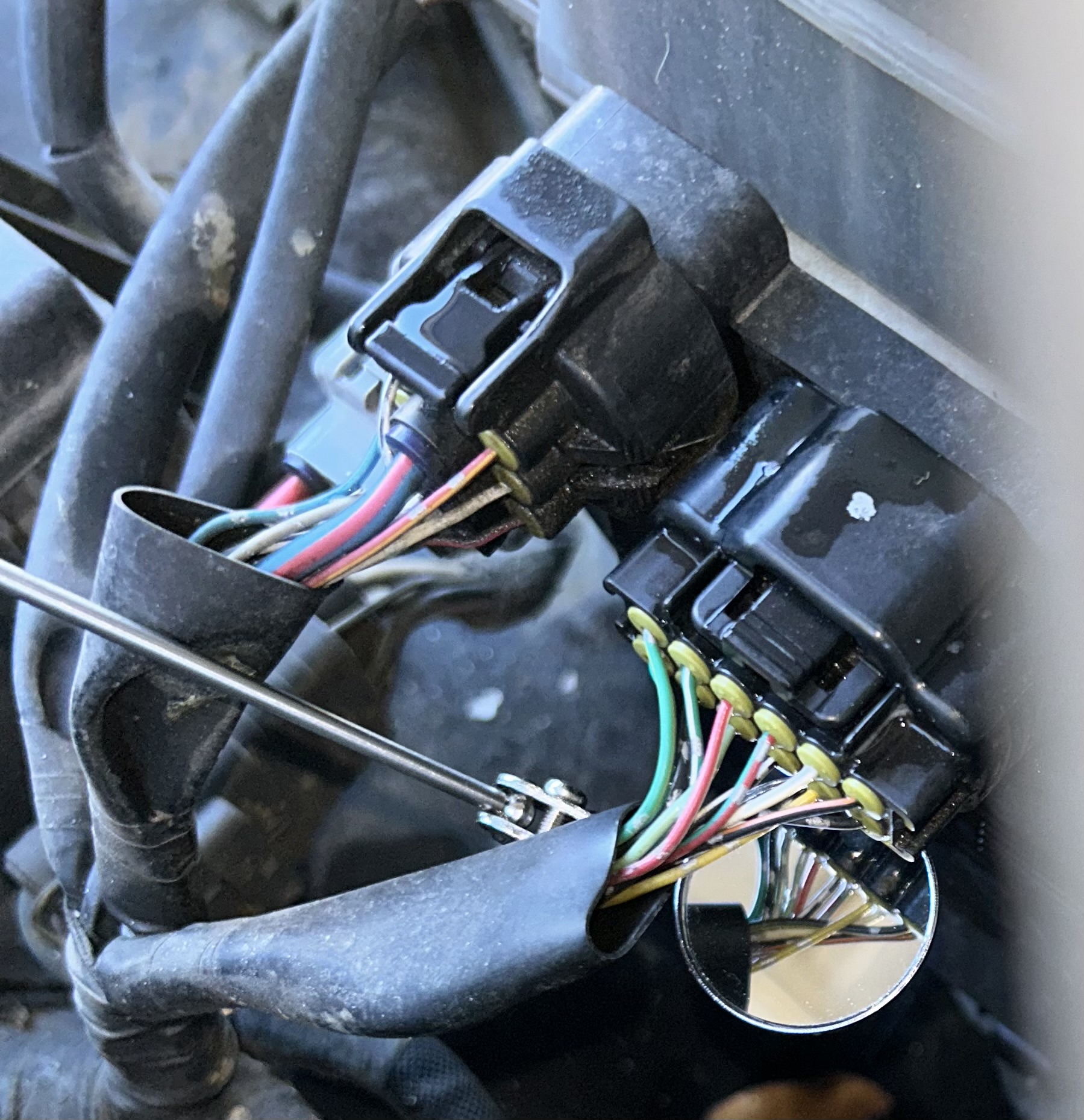

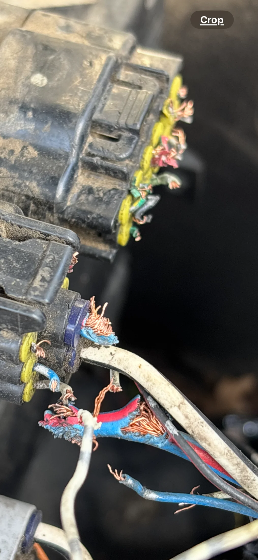

I am about to repair my wife's 2007 LC wiring issue and would love a pictures to match wire colors. Its the harness that attaches to the Brake Booster (between the battery and the Driver. See below... Thanks.

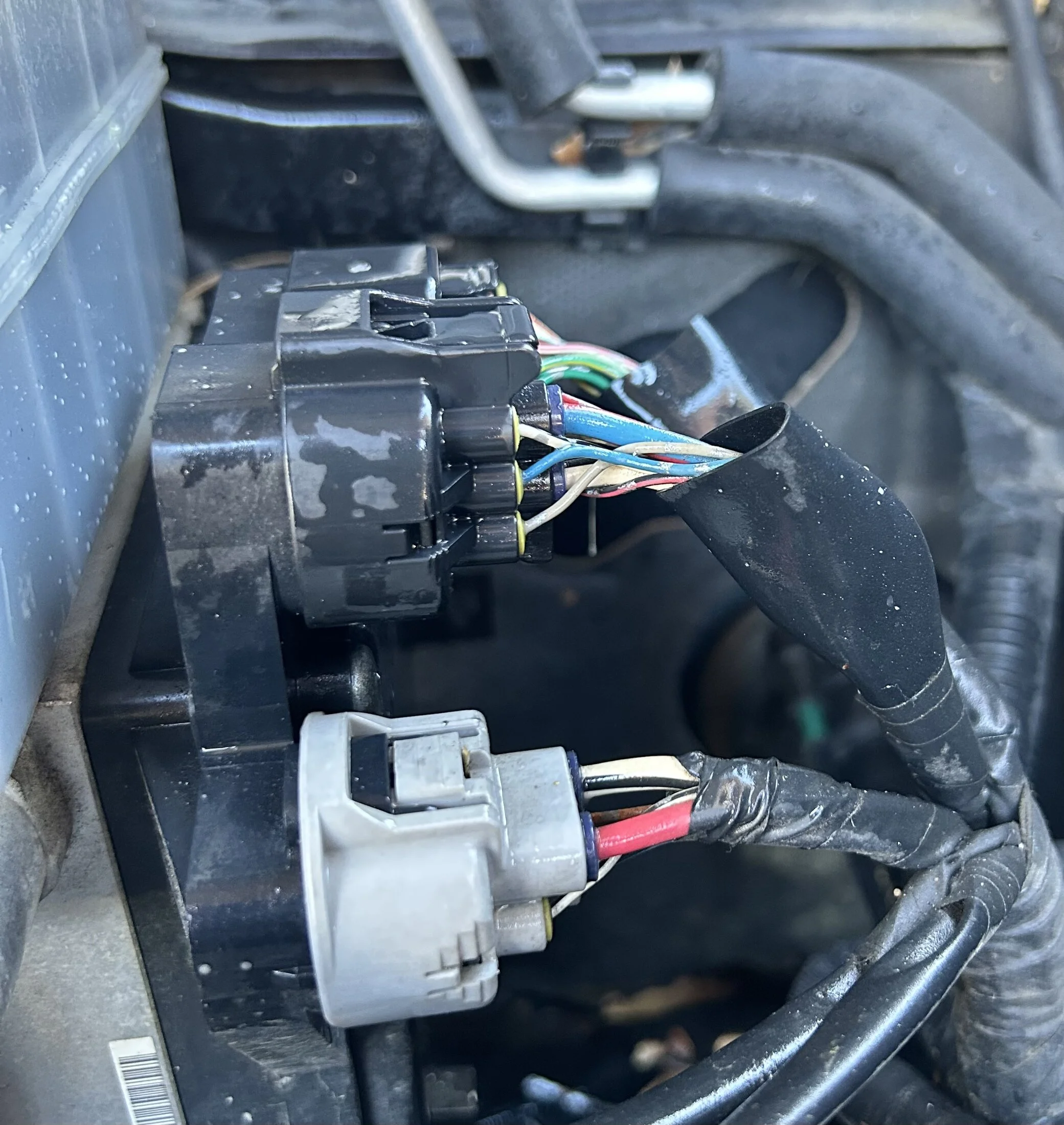

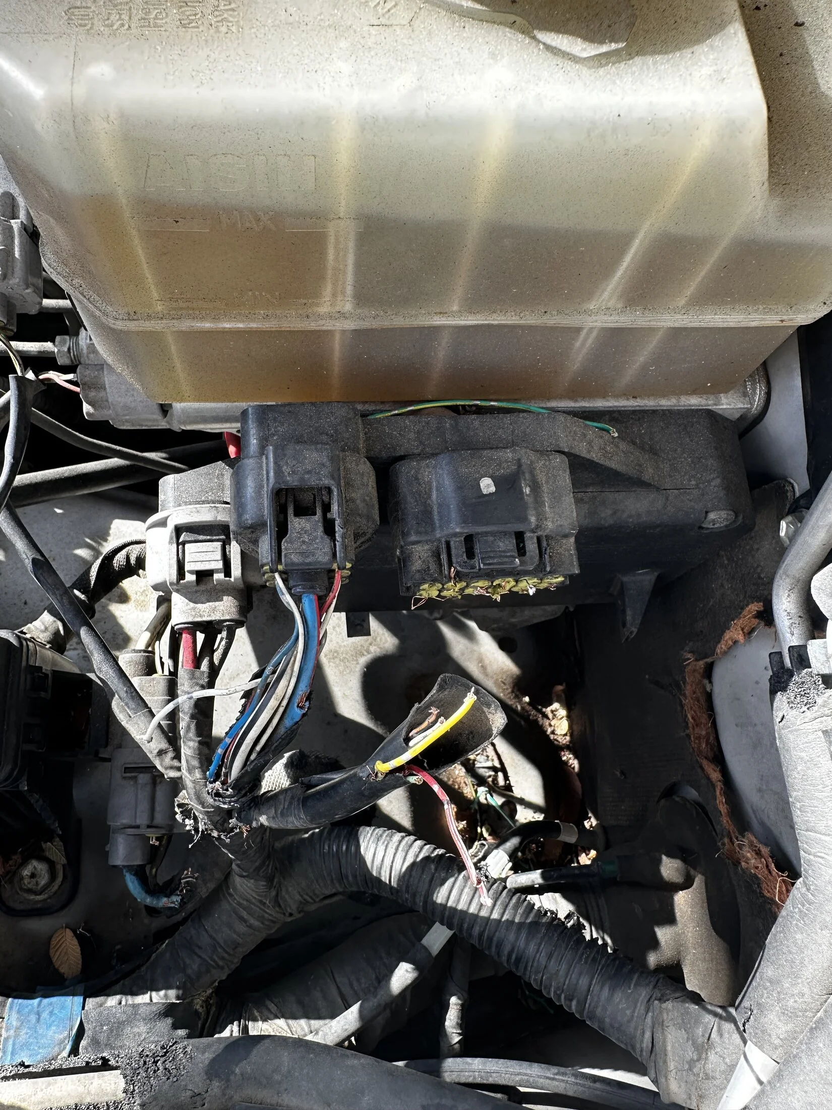

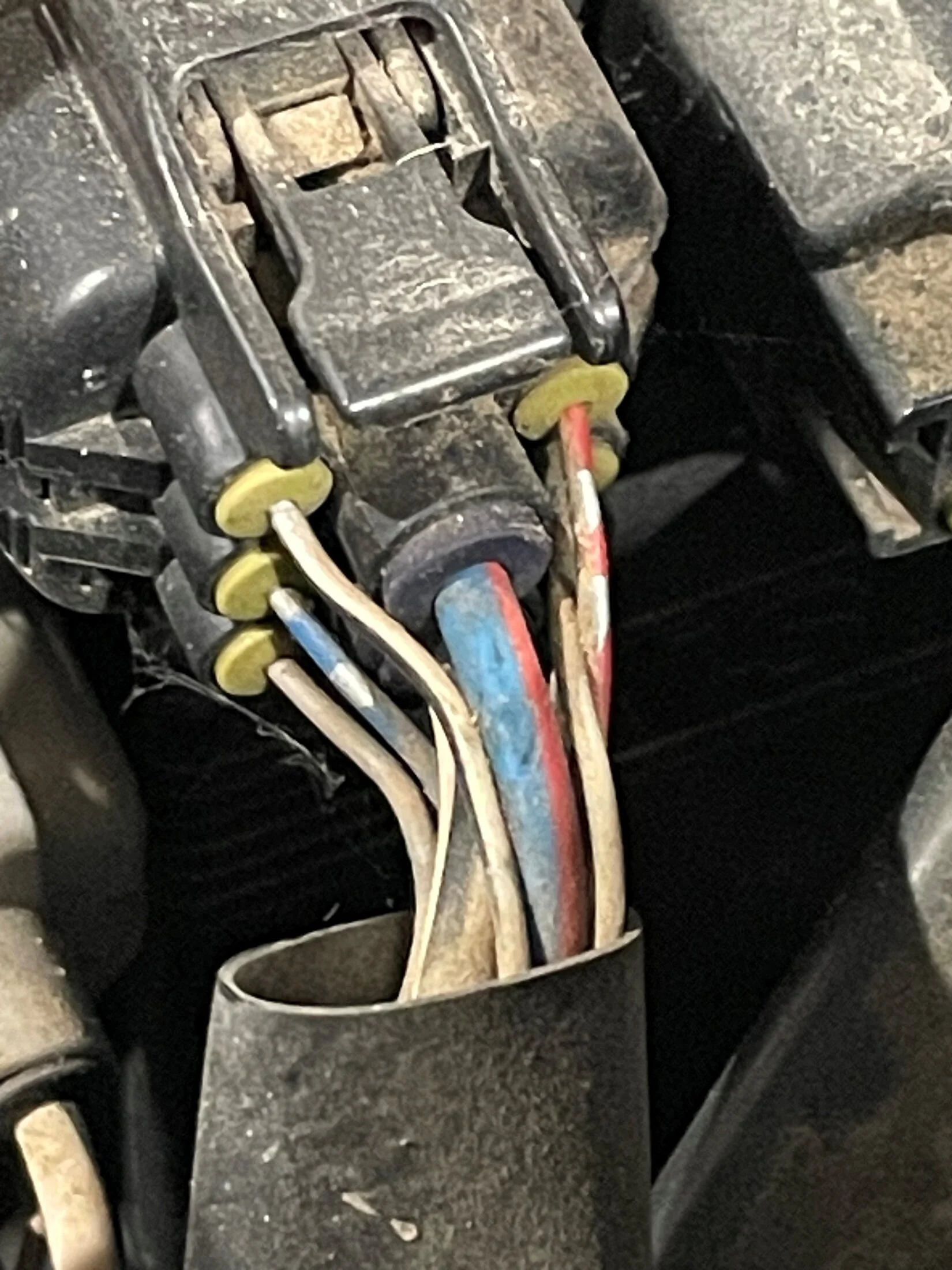

I have an Factory EWD for a 2006, it has 10 pages of photos for the wiring, if you think that is close enough message me a cell number and I will take photos and text them to you. Looks like quite a project.

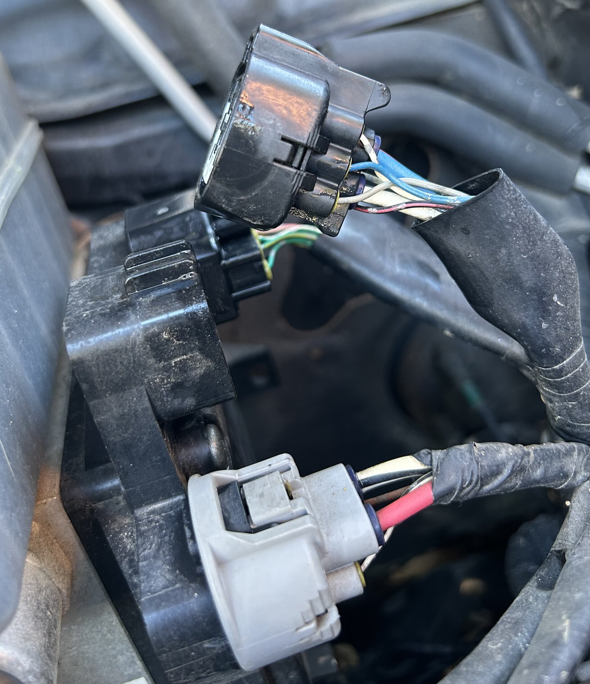

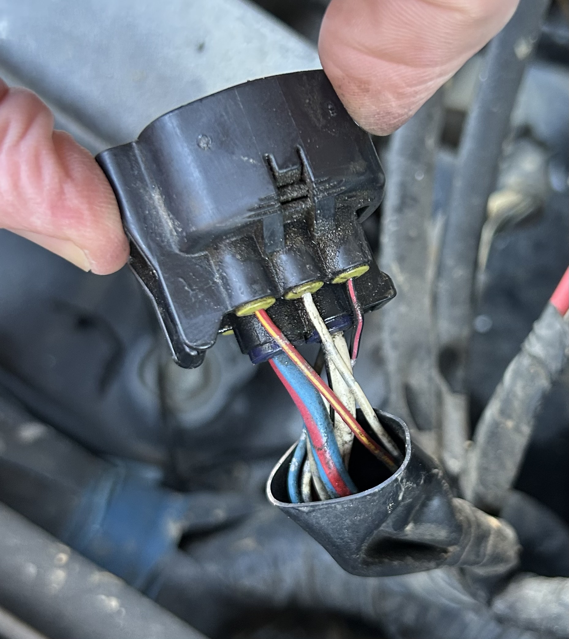

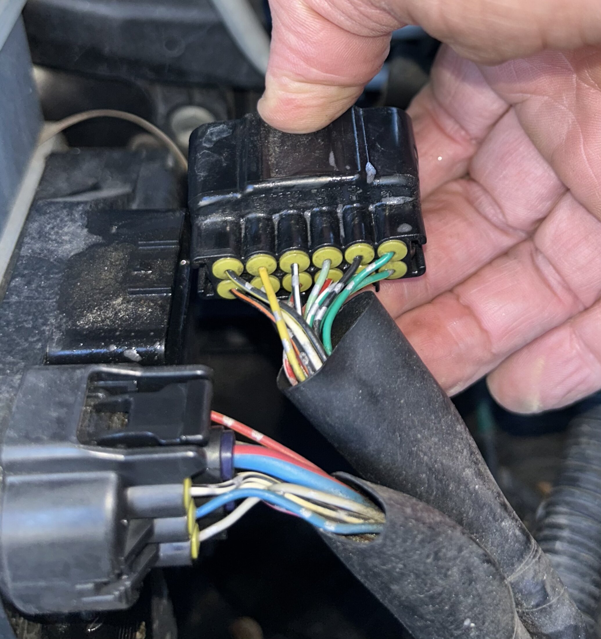

I have a 2006; but they should be identical. I think I got all angles; tried to keep the clip visible to help orient the plug. Bonus points if you find the mirror ;)
The bottom side of the bigger plug/harness
Small plug - this side faces the front of the truck
Small plug - this side faces the back of the truck
Amazing, this is perfect and the colors appear to match!

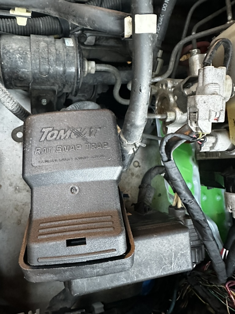

The day I saw the bird (yeah, not a rodent) tracks in the snow near the 100, I saw rat poop in my shop - part of my garage... where my '84 Pickup and my wife's car sleep. So, now it's on! I'm in a two-front war against the gray bastards:
  • Peppermint rodent deterrent spray on the backside of the tires/wheels. Bonus - the garage smells fantasic.
  • Traps. Three days in: Rats - 0, Me - 2
