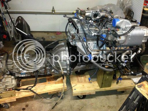

Would someone please tell me what I'm doing wrong/missing?

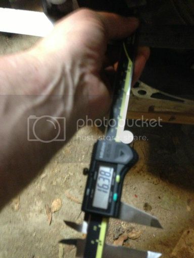

I'd been unable to bolt the transmission to the engine (~1/2" gap) so I finally undid everything to check dimensions. FSM says to confirm the torque converter setback is more than 15.7mm -- 16.38mm seems fine (sorry for the dark photo):

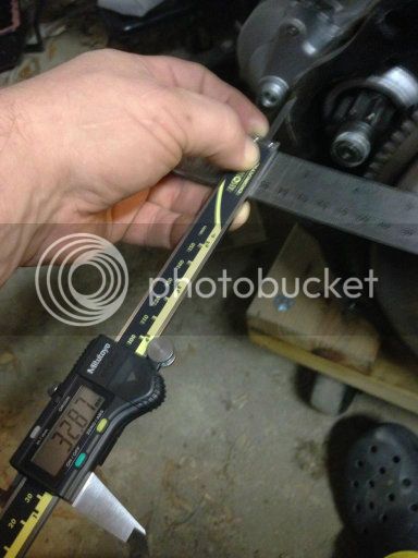

I can't find flex plate extension specs in the FSM, but I'd expect it to be less than 15.7mm -- 32.87mm seems excessive:

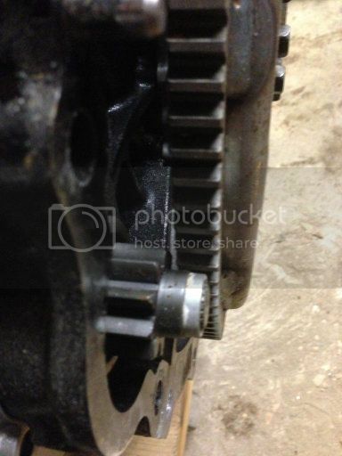

However, when I place the starter in situ it certainly looks like it lines up properly:

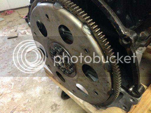

I'm stumped. Have I assembled the flex plate incorrectly? Am I wimping out torquing the bolts? I admit it's been a long week at work, but I simply can't figure out why it's not going together. Thoughts?
