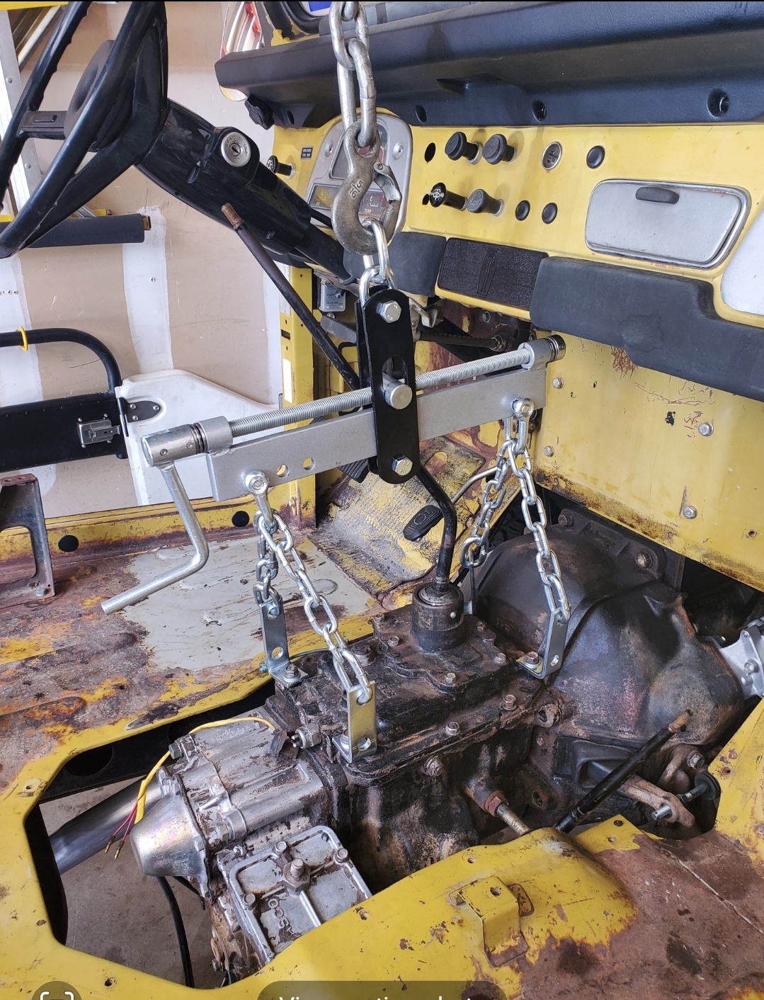

are you using a lifting device? trans may need to angle up, down or sideways slightly to align

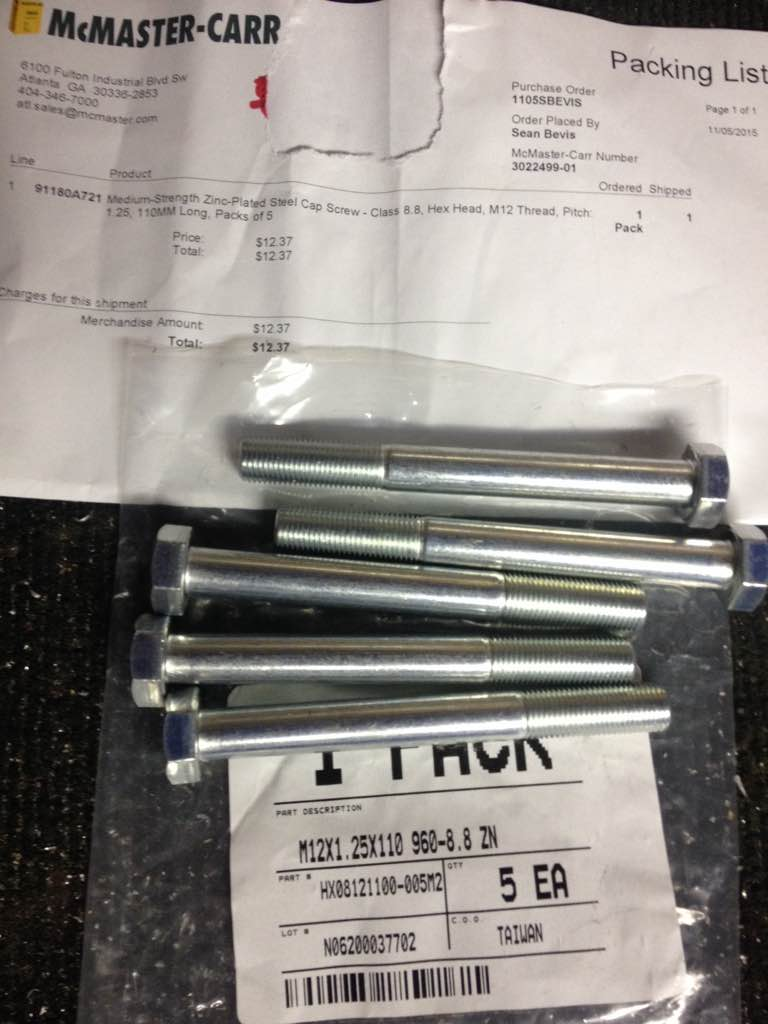

The transmission to bellhousing bolts are M12x1.25 and there are 4 of them. I think I got them 6" long.

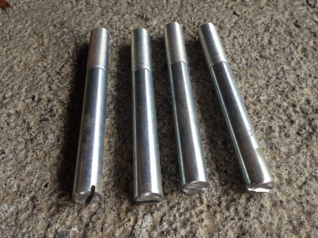

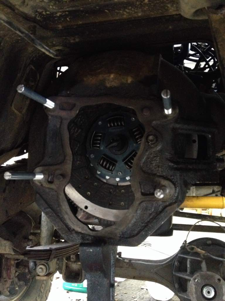

I went to home depot and bought 4 of them and cut the heads off with a cutoff wheel and put a chamfer at the ends. At this point they are long guide pins to insure the transmission +tcase don't tilt / pivot. Slide in the transmission input shaft through the throwout bearing and wiggle it side to side and up and down. At some point you get about 1/4in away and that means the tip of the input shaft is at the pilot bearing or in it. Now remove two of the studs diagonally from each other and use bolts to draw them in the final amount.

The guide dowels are a good idea. Cut a slot in the rear so you can remove with a screwdriver.

Why I am using the dowels as guides.
The 4 long studs will give you a much finer alignment prior to engaging the 2 small short dowl pins that are in the bellhousing. That's its only purpose to give you a better fighting chance.
