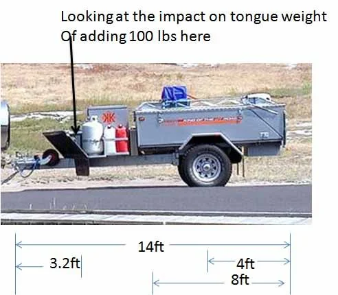

I am modifying my Kamper putting some more weigth ahead of the axles.
If I add 100 lbs 3/4 of the way between the axle and hitch (closer to hitch), how much does this increase the tongue weight?

Thanks, that part I understood. Found some sites link from expo that discuss first finding your center of gravity via several equations and determing your draw and type of hitch and claculating that out to determine the effect of placement (location and weight) on the tongue weight.
Or I could measure the tongue weight, add the same approx weight and re-weigh. It's not a one for one increase.

The gross weight is 3500 lbs
The water tank stradles the axle
I am removing about 25 lbs of fixture meant to hold an outboard boat motore
I am adding a steel box and a second 70lb battery.
Trying to decide between the smaller 25 lb box or the larger 55lb box. But the larger box will also hold more gear so add another 20 lbs
Box is to hold dual batteries
So the real question is if I install about 120 lbs 36-46 inches back from the tow ball, how much of an impact on tongue weight is that?

Formula: force * distance - force * distance = 0 (forces cancel equally)
10 - 3.2 = 6.8
X * (10) - 120 * (6.8) = 0
-> (solve for X, the unknown force)
X * 10 = 816
X = 816 / 10
X = 81.6 lbs of added weight on the tongue.

Thanks, I appreciate it. Just what I wanted to know.
I am going to use a smaller box that just holds two batteries, so really just adding a battery as the box weighs about the same as the outboard motor mounts I just cut off
70 lb battery would add about 46lbs of tongue weight. That shouldn't be an issue.

Ken,
Have you actually weighed your KK? FWIW: James has weighed his fully loaded and its generally in the 2,500-2,600lb range with water and fuel but sans the extra canvas walls.

I think I would be tempted to put them in the storage area under the bed...closer to the axle. Is that where you just put the heater? One of the things you have to careful of is to provide a battery cover so nothing could come in contact with the terminals. Are you using AGL or lead acid?
It's hard to tell how big the steel is for the frame, but if was designed to hold a boat motor (what size?) then maybe from a weight standpoint it would be ok.

I haven't weighed it, the tag says 1500kg and I think thats 3500 lbs GWR. The weight you listed seems more realistic

I am using AGM batteries. Not sure what size motoe, but the brackets I just cut off were pretty beefy.
You know that by adding weight aft of the axle you can counter-balance some or all of the added tongue weight.

If the weight is only 2.5k lbs and you're adding 80 lbs of weight, that's actually quite a bit, over 3% of the total trailer weight. From everything I've read, you want the tongue weight to be around 10% of the total weight.
I would weigh your trailer, then weigh the tongue and see what the tongue weight is. If you're going to be way over that 10%, you might want to look at other options.
