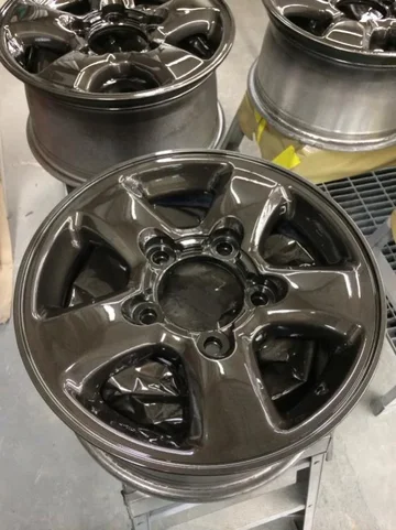

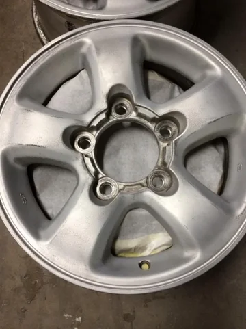

Got them painted today! 320, red scuff pad, blow them off, wax and grease remover, one coat sealer, two finish coats with single stage.
They look great! I did all the prep work, my buddy at the paint shop sprayed them for me.
They weren't dry yet when I left, so hopefully they look good next to the riverock mica...
Prepped and ready to go:

Bam!
Was wondering why you pulled the wheels to do a slider job! Wheels look great!
