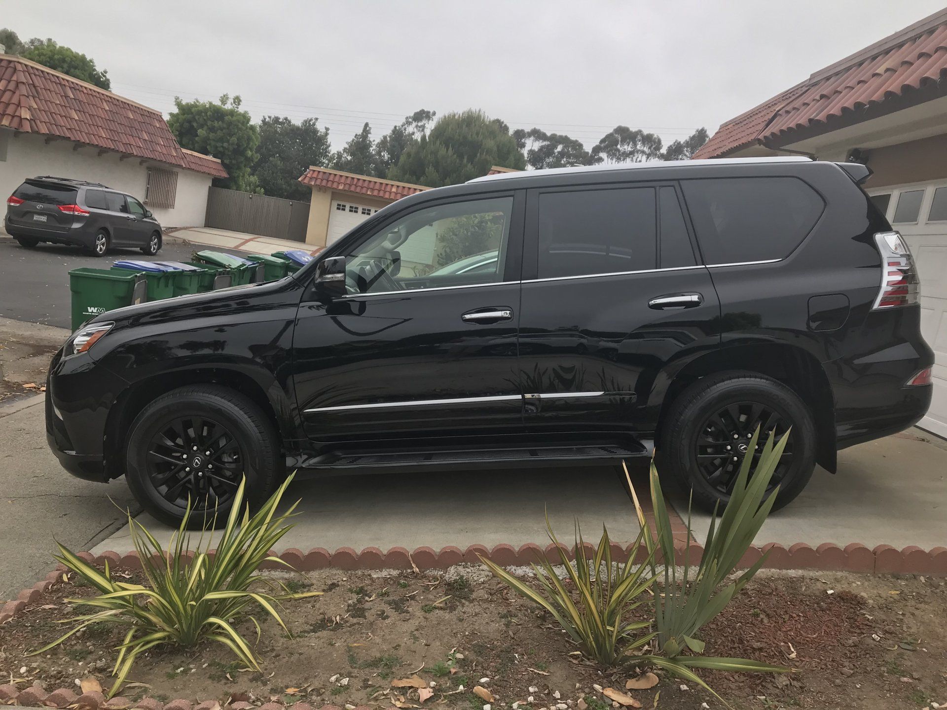

Hey guys,
Now that the GX is home, I need to de-mommy it. I'm looking to keep the stock suspension for now but I would like to put on the largest AT tire I can fit without rubbing. The only caveat is it has to be snowflake rated. I've always had BFG AT/KOs, but I'm wondering if I'm missing out on better tires.
Location: So Cal, but will take trips to Big Bear, Mammoth, etc.
Use: Road trips, DD, Light wheeling, Camping
-I've always had trucks with E rated tires. Does it matter if I don't get E rating? Is there a big difference in ride?
-What size tire would you run below? From my research, all of these should fit on stock suspension with minor fender massaging
-Any tires I'm missing? I hated my Duratracs on my truck, so that's definitely out.
