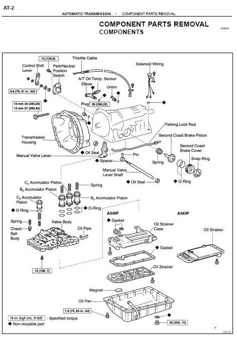

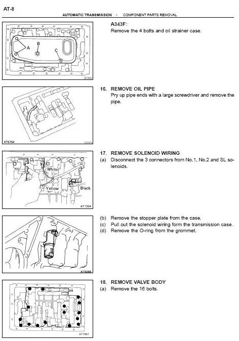

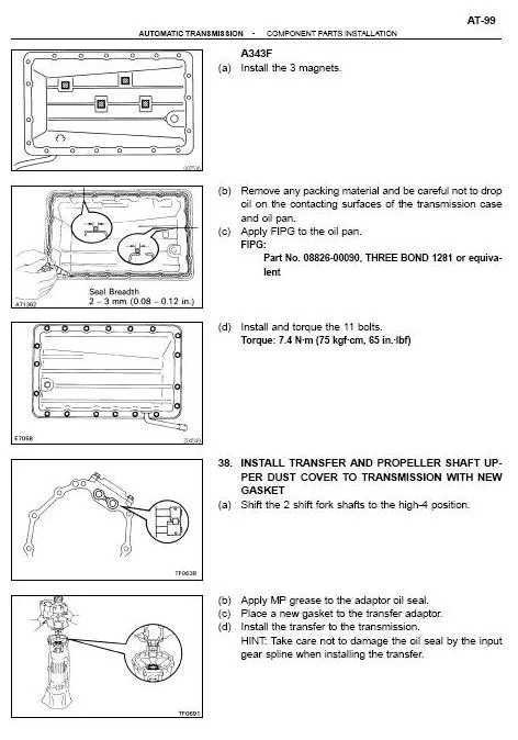

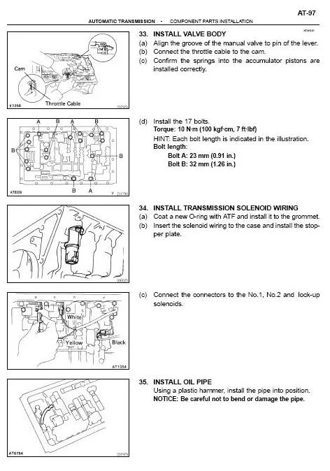

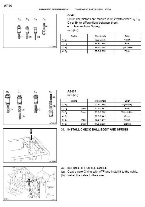

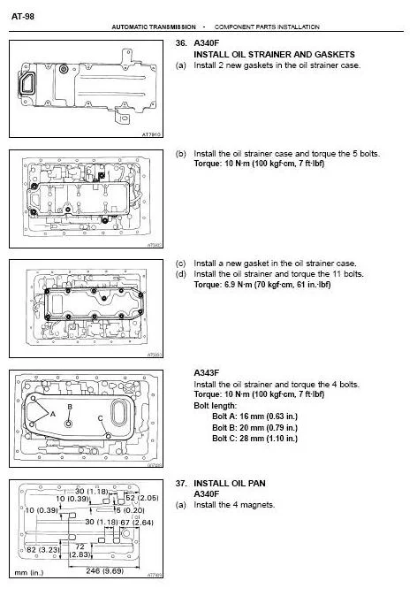

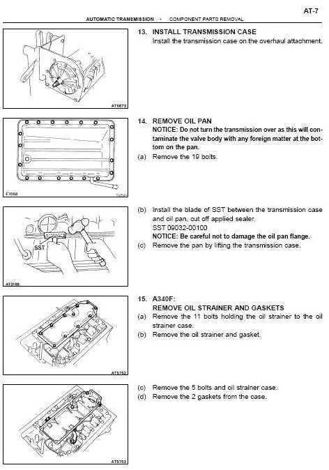

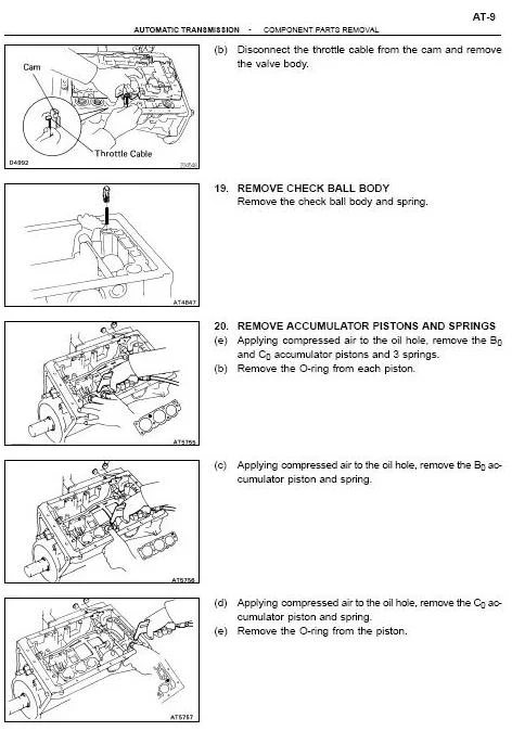

I think you need to pull that pan and valve body back off and CONFIRM that you have everything installed correctly.
Although I have never had this transmission apart I have had others and there are often lots of little bits to lose or misplace in the reassembly process.
Get yourself a transmission manual for your truck. It details the removal process of all these little bits.
Examples from the 103 page manual.
Chris
Re:
Dude, thank you! I'm a fairly busy person, so I have to do this in my spare time and the weekend, but I'll be posting back when I figure this problem out. Again, thank you for the manual pages!
Re:
Will do. Hopefully that helps holding the accumulator in place. I was wishing I had about four hands when I put it all back together the first time!
