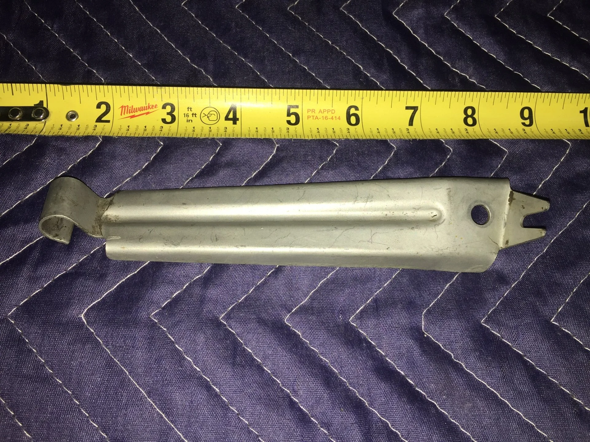

help identifying this misc. bracket
May 31, 2020
7
50
Boise, ID

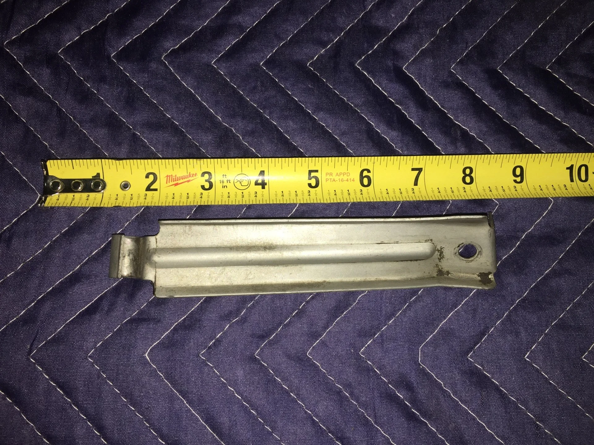

When I purchased my cruiser the PO gave me a box of misc. parts, including this bracket. Hoping someone can help me identify it so I can reinstall if necessary.

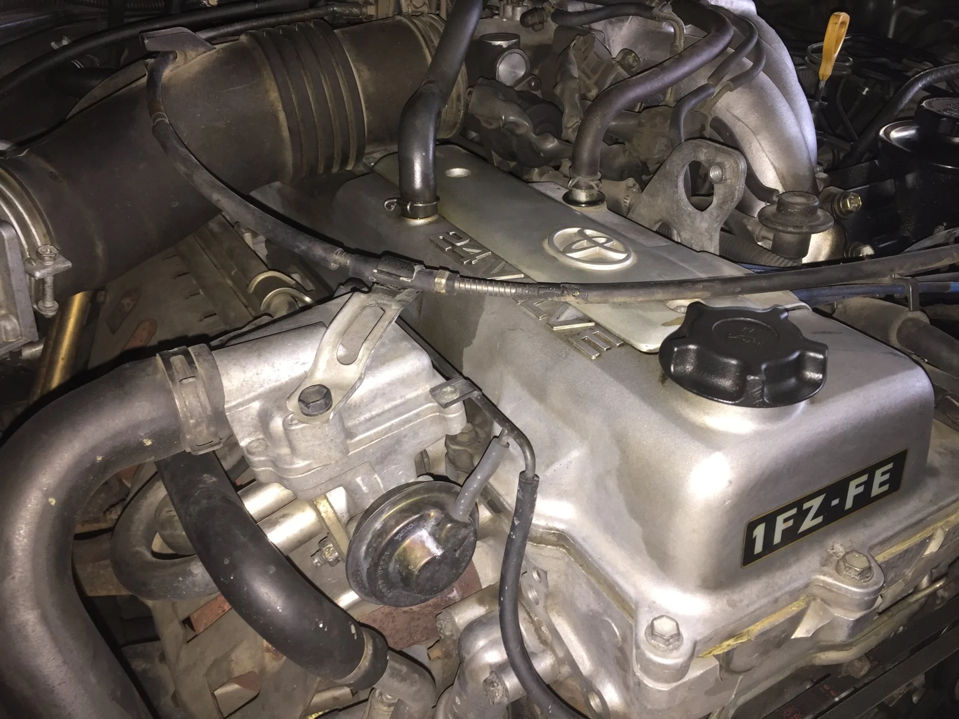

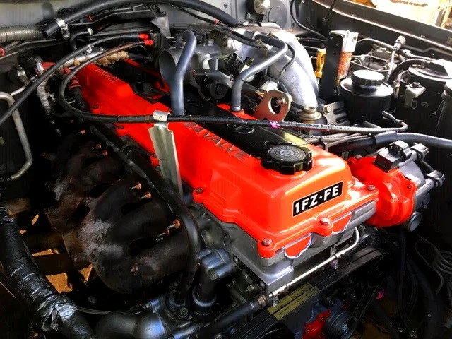

Yep, later model throttle cable support for post 93/94 1FZ-FE without PAIR. Makes a PAIR delete cleaner.... :cool:
Jason
Ah… something I haven't looked into. It runs like a champ at this point so I haven't ventured to eliminate anything as of yet. We have emissions testing here – so may not be an option for me regardless?
Yep, probably just let it be if it's running well and you have emissions.
