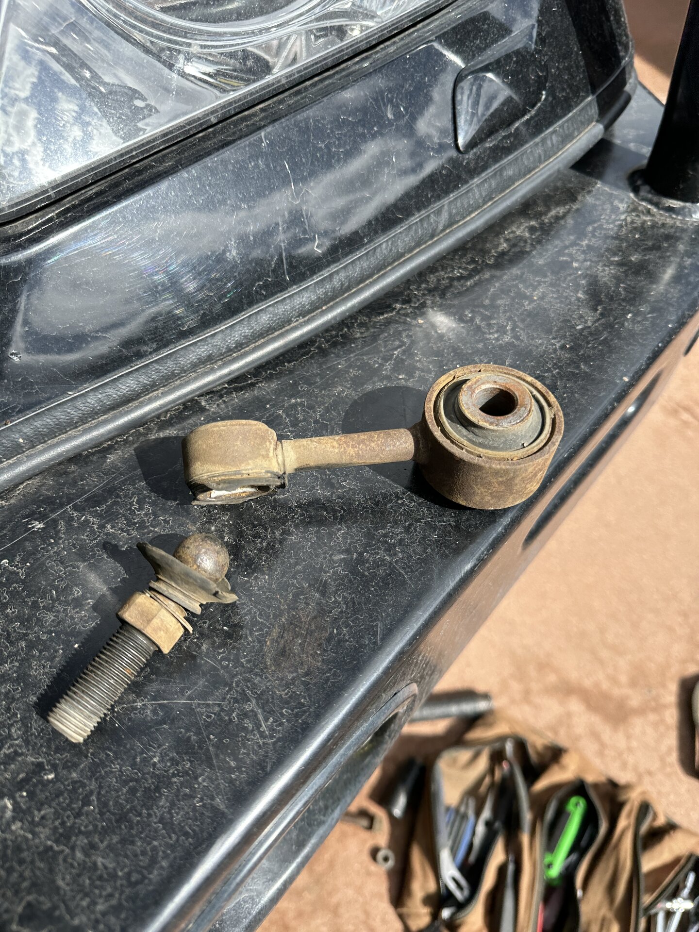

Hi all,
Looks like I found the issue. I am now confident it can be one of 2 things
1) - Swaybar end links, Driver side end link shows the metal ball exposed and exposed to dirt, passenger side looks the same as well - I will be replacing both
2) - When I went to get an alignment I noticed the techs struggling because my LCA alignment bolts were seized and while they were able to free them both (rear) front lower control arm bushings (P and D) are torn. The pattern looks like it was torn clockwise.
So new links ordered. I am waiting until my LCAs get worse and then I will purchase 2 new complete arms as they include the LBJs.
Hi all,
