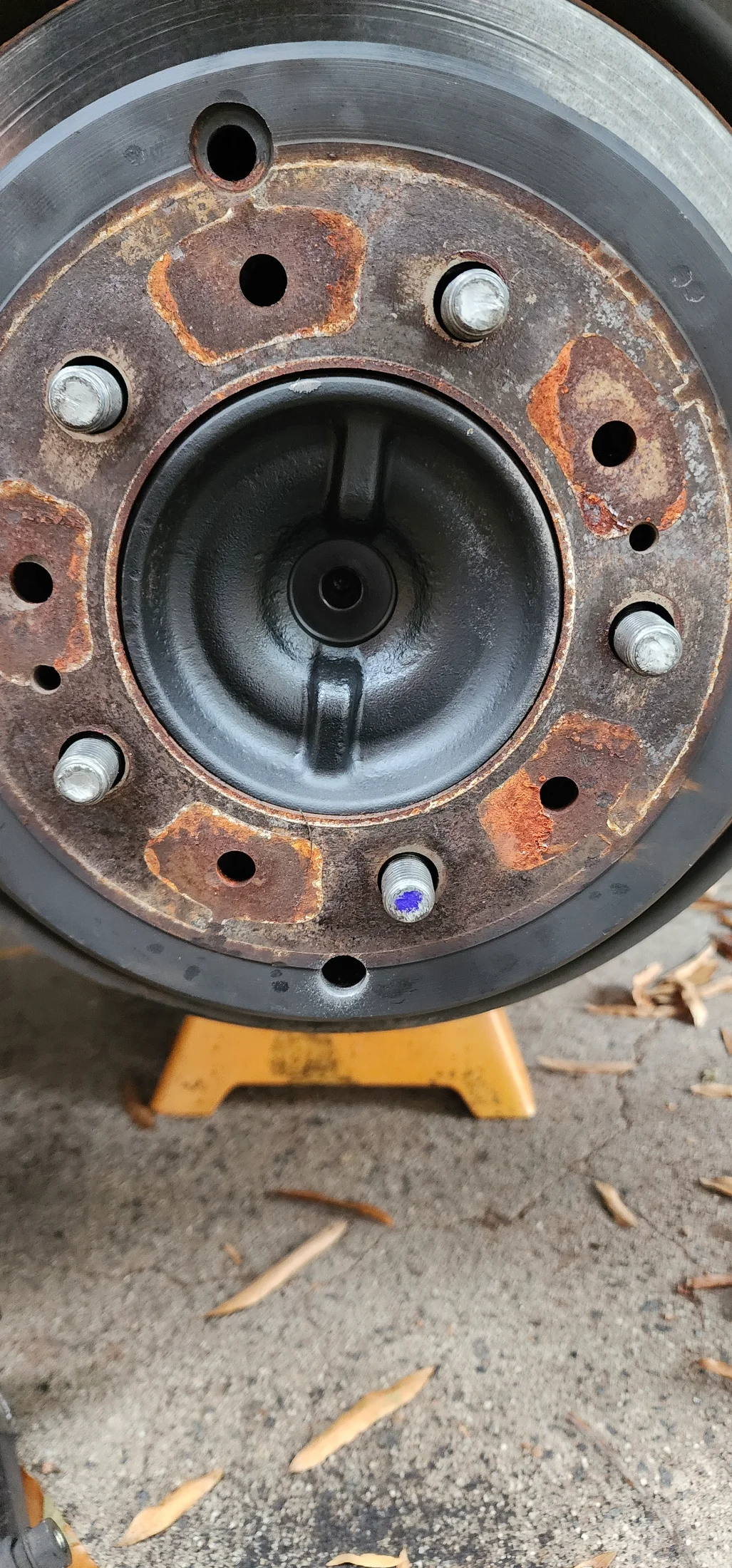

Hello all,
I was having a devil of a time trying to remove the rotors so I used bolts in the threaded holes on the rotor to pull the rotor from the hub. I didn't think through it and just ran the bolts through and tightened them against whatever was in the hub (I'm assuming the parking brake hardware). That worked pretty well for a few millimeters, but then I heard a Ping noise and something come loose inside the rotor. That's when it dawned on me that I never backed off the parking brake shoes...
Now the rotor is totally locked, and it will not turn at all. I even tried reinstalling the wheel to spin the hub to get to the access hole... It won't budge.
Any ideas on how to overcome this? I feel so stupid...

I don't see an access port on the back, it's solid. I wasn't trying to replace the parking brake, I was just replacing the rotors because the passenger side went metal to metal on the pads.
How are the threaded bolt holes SUPPOSED to be used in remove the rotors? Are you supposed to use a pully that threads into the holes and presses against the center hub or something?
access point to adjust star washer is on outward face of rotor. The access hole needs to be at the 6 o'clock position

That's the situation I'm in right now... I did not loosen the star adjuster to retract the shoes before I used bolts in the rotor. Like an idiot I just threaded the bolts in until the hit resistance, and tightened away. The rotor did back off the hub, but I heard a pinging noise, something came loose, and then the rotor was basically seized at that point. No more backing off the hub, and it will not rotate AT ALL...
I'm just guessing right now, but I fear the bolts were pressing against the brake shoe hardware and I knocked it loose and jammed the shoes to the inner rotor hub.

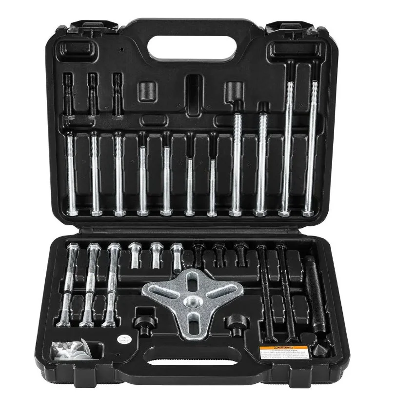

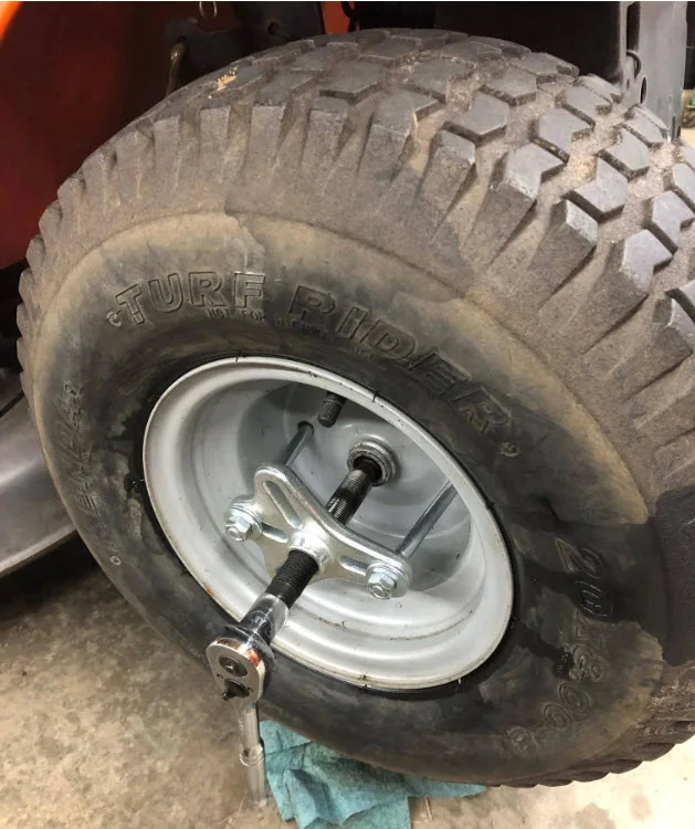

The only thing I can think to do is use something like this to pull the rotor via the threaded holes. It'll wreck the parking brake pads, and likely the hardware, but I'm not sure of any other options.

Thank you, that's a good idea. That would be the best, and least destructive, option right now...

You can drive a nut through the threaded hole to pull the rotor out. use two nuts on both holes to pry it off while turning the bolt clockwise.

Yes, that's what I did, however I failed to loosen the ebrake adjuster prior to doing that and I have apparently jammed it against the rotor. The rotor will not come off, nor can I rotate it around to get the hole aligned with the star adjuster.
Next step is to drill a new access hole in the rotor to access the star adjuster.
There IS a round rubber gromet on the outer surface of the rotor mounting flange near where the studs come thru to access the star adjuster. Unfortunately you'll need to rotate the hub until the access hole is at the bottom to be able to get to the star adjuster. Pry out the plug with a small screwdriver to remove it.View attachment 3999114
Yes, thank you. The issue is that I didn't do that BEFORE I backed the rotor off using the bolts. Now I can't rotate the hub so I'll have to drill a new hole.
Drilling rotor at 6 the o'clock, is a great idea @leveeguy . To allow access to the star adjustors, when roytor can't be turned. ;)

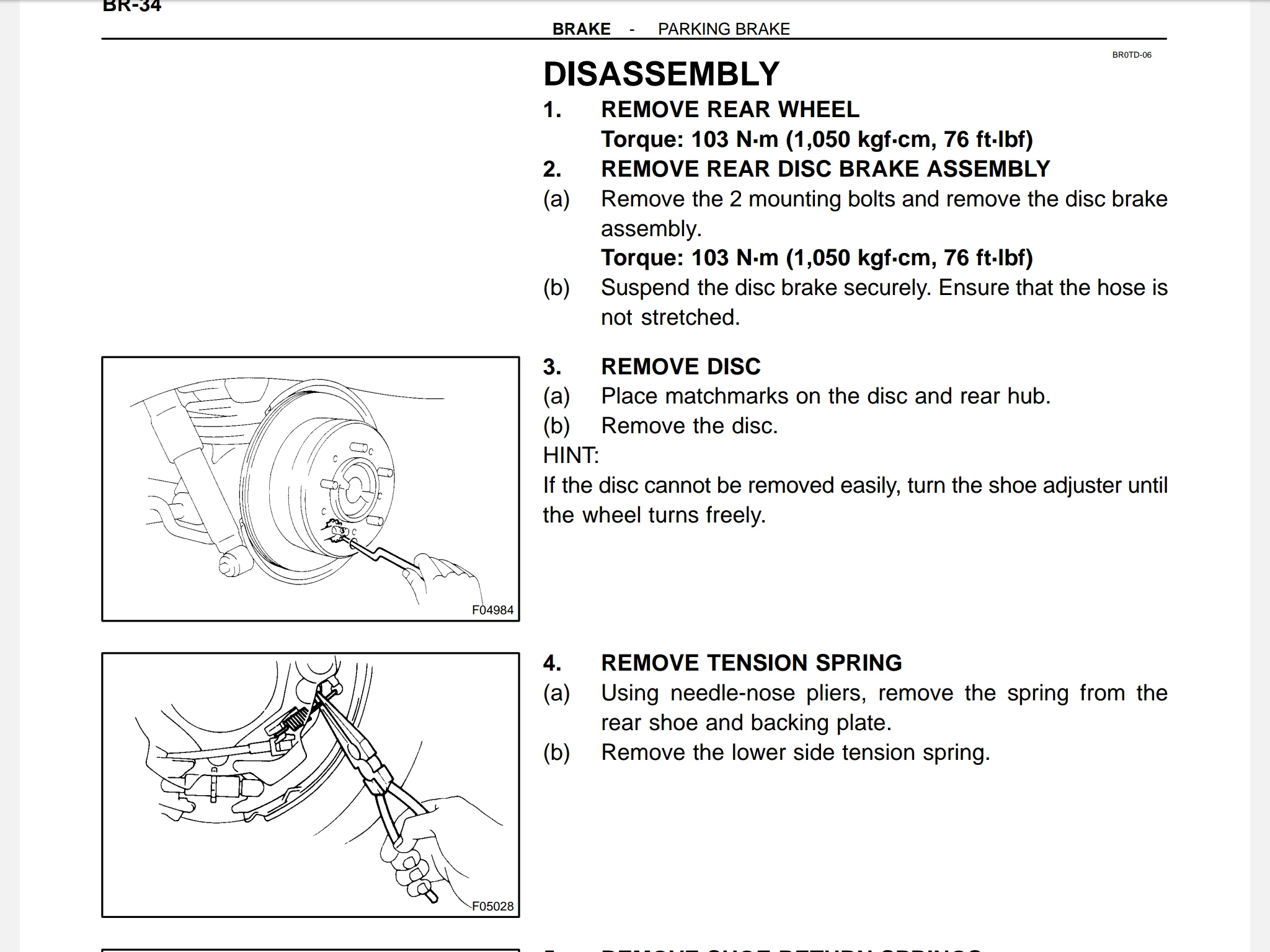

Just to be clear, which the FSM is in "most" (not all) of brake job.

  • We must back-off E-brake shoes. Not only release the E-brake handle, but back-off the shoes by the star adjustors.
Failure to back off shoes. If they then hang-up on rotor. Shoes will be pulled outward with rotor.

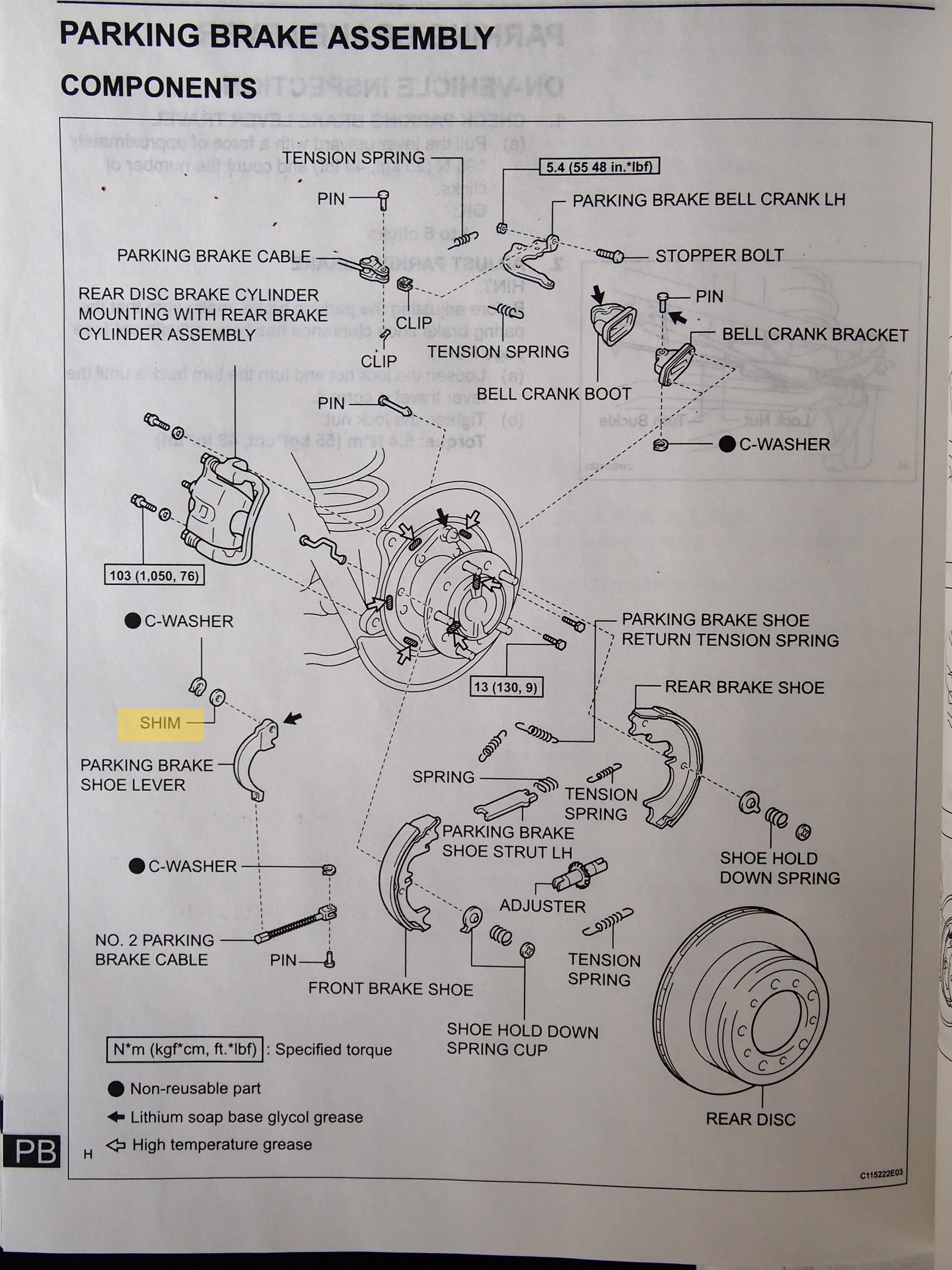

The shoe are held against brake dust shield, by two heavy gauge wire pins. One pin, has a bend the other straight. These wire pins, are install through the rear of brake dust shield. Pull to hard on them (pins), can rip them through brake dust shield. This may enlarge the hole in dust shield. If so, you may need to add a "thin washer" to new wire pins, during assemble. So that they don't pull through, brake dust shield on their own. You may be able to reuse straight wire pin. But the bent one will likely get elongated and need restoring or replacing.
Shoe are secondarily, held on by spring tension, on tension spring retainer and hook into shoe by forks of struth. So when hung up on a rotor, and pulled out. Shoes, roll outward at side/middle area, pivoting from top which is held in. This compresses shoe on tension spring retainer (which is attached to brake dust shield) and rotor. Simulary held in at bottom, by adjustor forked ends. This results in shoes getting cockeyes and wedging into rotor. Not only lock rotor on. But many parts, may get damaged.
All parts of E-brake assembly. Will now need very close inspection. Any damaged, either need restoring or replaced.

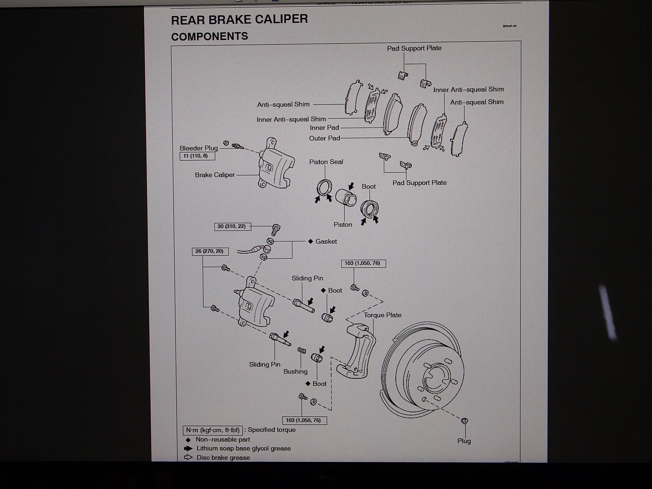

I recommend a medium strength threadlocker on caliper bolts. Reduce the torque from the 76ft-lbf factory spec, by ~ 20% Since lubing threads. I use ~62ft-lbf on these lubed caliper bolt. These are the bolts, which hold on Torque plate to rear axle housing.

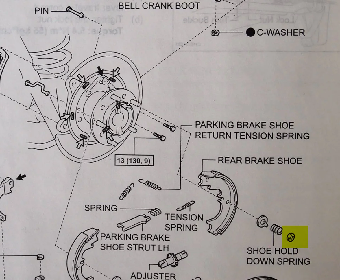

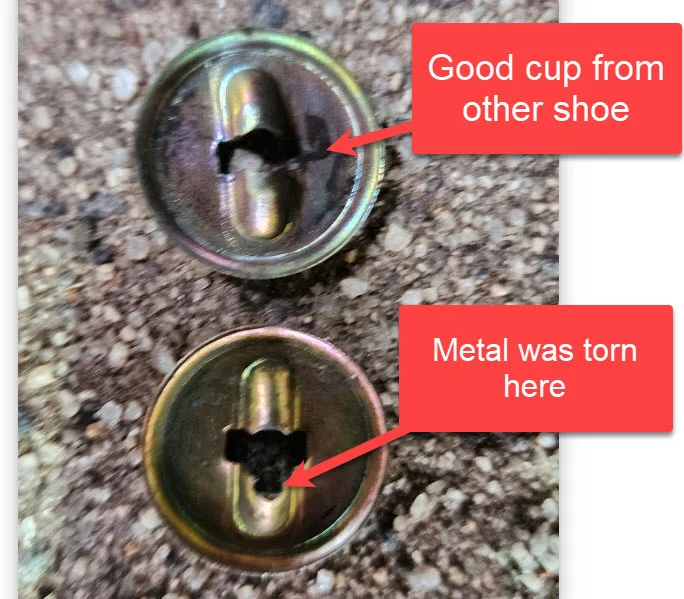

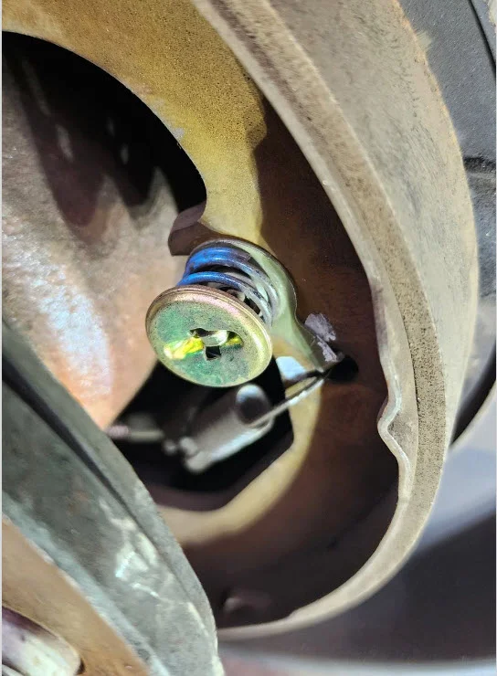

Once I got the rotor off I could see that I had pulled the Shoe Hold Down Spring's pin through the retaining cup. This allowed the spring and cup to pop off, that was the sound I heard. I was able to put it back together, but the damaged cup would likely pull through quickly:
The cup (PN 47449-30030), is bad and I'm headed to the dealer to get one now. Luckily that appears to be the only damage other than my ego...
