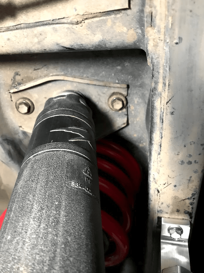

Slots are to the out side, these are right/ left sensitive or can only go on one side as they angle two directions.
Only reason i'm even questioning myself was Onur saying opposite, since he knows more than most of us combined on here about these rigs.
Precisely why I went and dbl. checked and took a picture ;)
