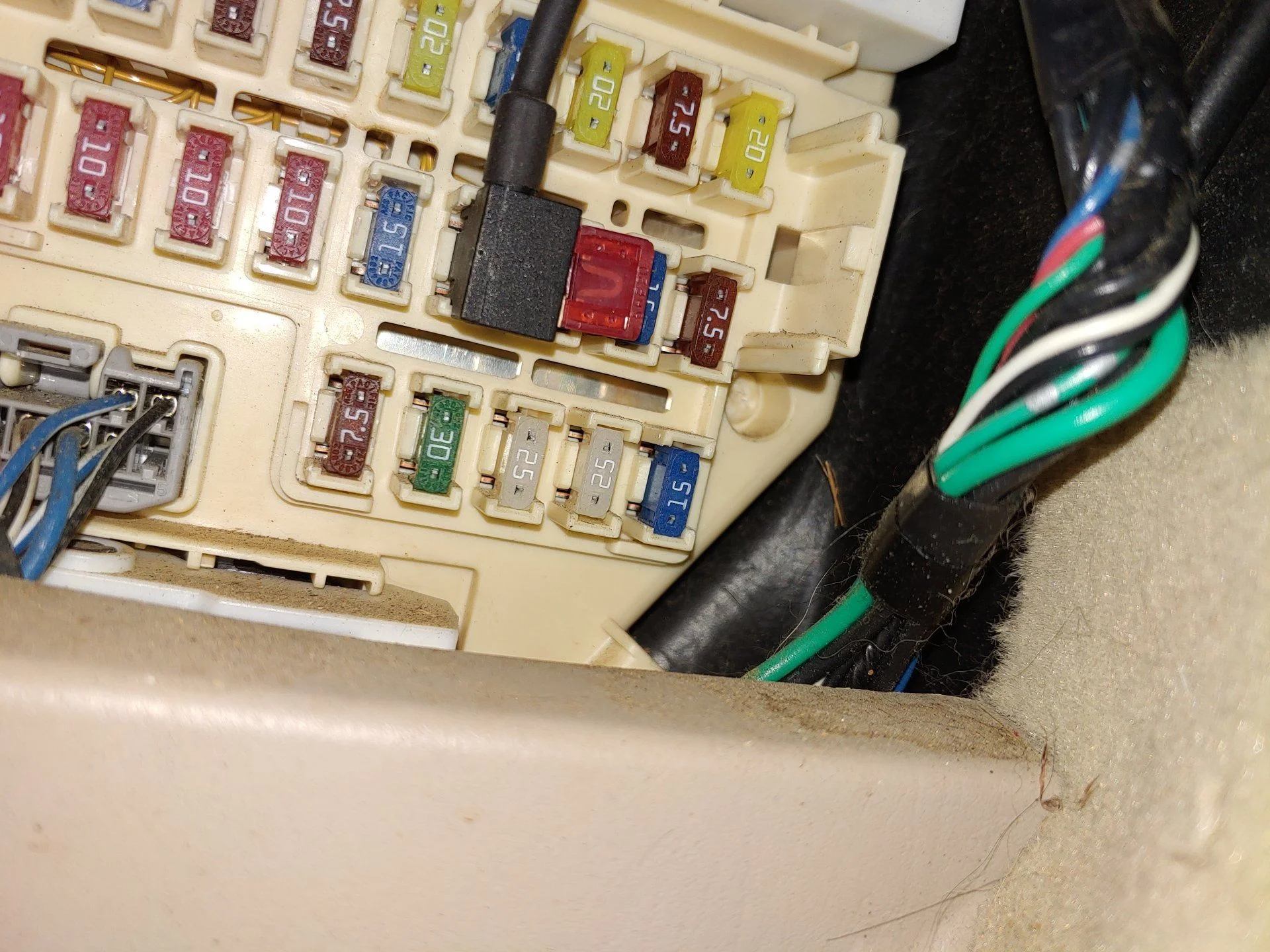

I did not. Phil's kit runs the fan through an add-a-fuse (10A) in the DS kick panel. Not sure if that handles what you're referring to or not- still an idiot with electrical. Is there an issue present as it's set up?

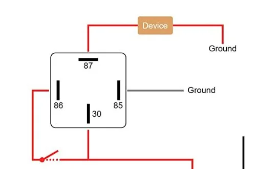

Okay folks hang on to your hats. Here is a relay on Amazon, but auto parts stores should have ones like it.
Amazon product ASIN B01J53IH5M
Note: Device in diagram above is the fan.
The red wire from the fuse (one dot) would now go to both the switch and terminal 30 on the relay.
Disconnect the other red wire from the switch (one with a line) and hook to terminal 87 of relay.
From where that other red wire was hooked to the switch now need a wire from that terminal on the switch to terminal 86 on relay.
Hook relay terminal 85 to ground.

Is it just as simple as Teeing a wire into what's already there and connecting with a spade connector on the points of the relay in the order you've described?
Worth noting: the red wire that comes from the fuse panel was also tee'd into to install the rocker locker switch. Am I at risk of overloading this fuse or causing any other issues? I'd hate to burn the truck to the ground.
Yes that is pretty much it. You want those original thicker red wires going to relay terminals 30 and 87, and nothing from terminal 87 going to the switch.
