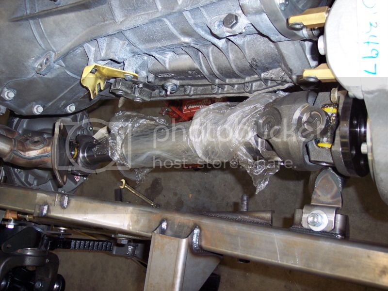

Here's our Tom Woods Driveshaft. They do some beautiful work with an amazing turn around time (that we loved with SEMA coming up). We're running 1350 joints and our front and rear driveshafts are within 1.5" of each other so we should be able to use one spare for both. You can see our driver side header dumps right into the shaft so we're thinking we're going to use these cast manifolds from Ford Racing to dump a lot higher and actually run the exhaust outside the frame where there's tons of room.

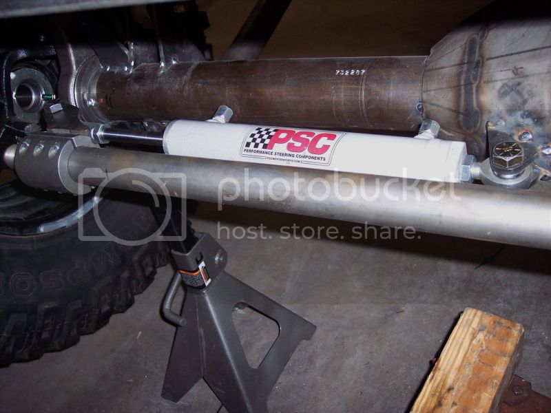

Here's our final location of our PSC hydro assist ram.

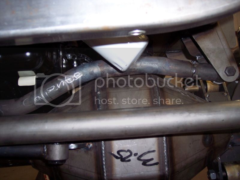

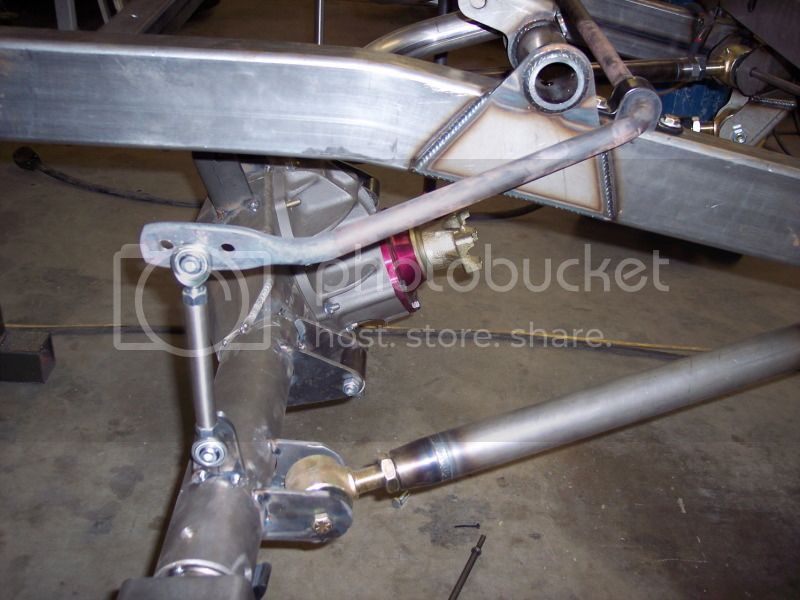

Here's the beginnings of our front panhard with the frame mount. This is full bump plus 1" for safety and you can see the top of our diff is actually a hair higher than the bottom of our oil pan, just offset enough for it to work. This made the panhard a little tricky but we bent one up on our CNC tube bender out of some scrap solid, then tweaked it with a torch and cutting out little sections to get it perfect. That's what this pic is of, but we then measured it with our CMM and bent a perfect one out of 1.375x250w DOM (no pic of that).

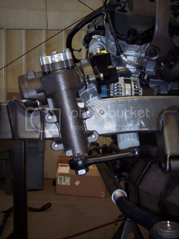

The flat arm worked the best for us, here's the box and pitman arm. We have the drag link using the same 1.625x250w material as the tie rod and the same CurrectLync ends. No pics of that either, oops

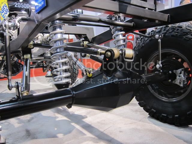

Here's our rear axle with all the link tabs, shock tabs, sway bar tabs and our 7/8" rear sway bar.
Damn nice work
is that swaybar going to let that axle articulate to all of its potential??
are its arms too short?
It should be pretty close to the full potential. They're about 14" arms which is longer than the majority of our sway bars and with the smaller 7/8" diameter we'll be able to get close to full flex. This is about the same as the rear sway bar we sell for Early Broncos and a bunch of Jeeps (JK, TJ, LJ, XJ, etc) and it works well for them. It is set up to be able to swap in a quick disconnect down the road if we want but for now we think it's unnecessary.

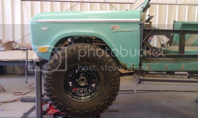

Here's how she looked before I took the axles down to Currie on Monday. This is full bump +1". The rear clears but the front edge doesn't (unless we always only drive in a perfectly straight line). This is the third time with the body on and off and we have it down to a 15 minute science now.

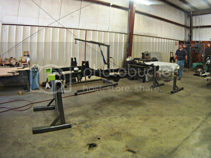

Here's how it looks now, pretty much the same as before we started except for a few extra tabs. A little depressing to tear it all apart but that means we're on the final stretch to SEMA! We took the frame over to Visalia Powdercoat to get sandblasted and powdercoated today. We're going to sandblast and powdercoat the rest of the suspension in house, we just don't have a big enough sandblaster to do a whole frame. And yes, it is upside down.

The only other slightly exciting thing besides a lot of paint prep and million little fine details is we got our power steering pump figured out on the engine after trying a couple different options.

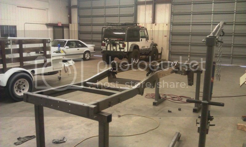

I guess I have been slacking on updates, we've progressed. Everything is all powdercoated and back. We went through a couple different colors and ended on a basic chassis black for the frame and suspension. We are getting the axles back tomorrow and then the real final assembly push begins (in a week I will be on the road to Vegas/SEMA). Otherwise, we've just been trying to catch up on some new sway bars and leaf springs and get the rest of the booth together while stuff has been at paint.
Here's the frame back from PC, we have some tape on the front because we were test fitting a bumper/winch that'll be on it for the show

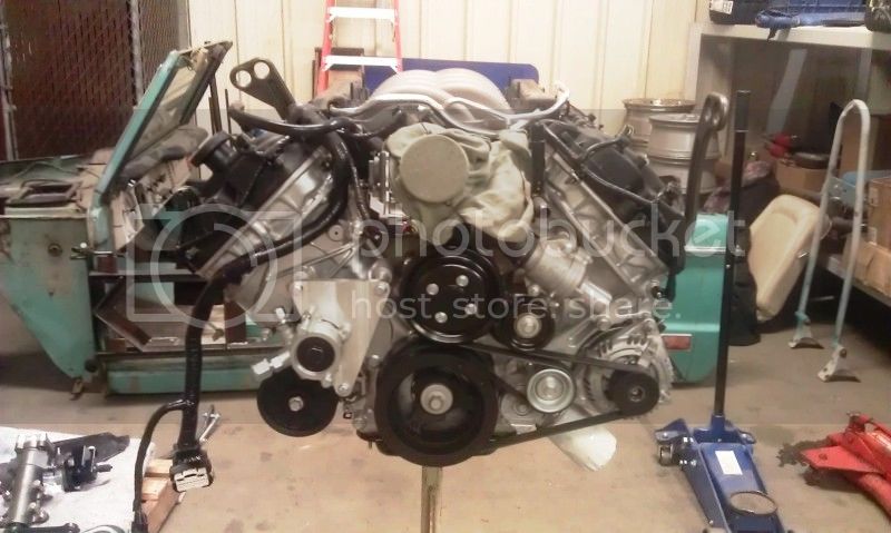

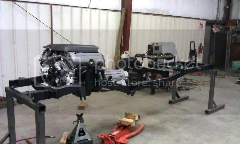

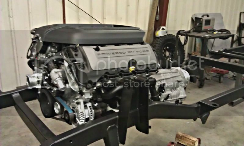

The engine and tranny are back in.
http://i1244.photobucket.com/albums/gg576/HellwigProducts/10-17-2012 Assembly/IMAG0625.jpg
http://i1244.photobucket.com/albums/gg576/HellwigProducts/10-17-2012 Assembly/IMAG0624.jpg

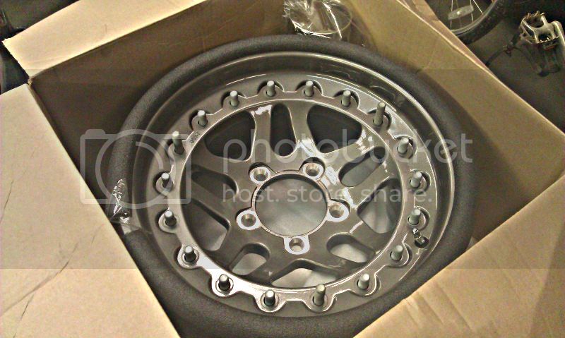

We also got the wheels in, we went with the Hutchinson beadlocks and as soon as the tires come in we can put them all together! Just from checking them out they look like awesome construction and since Hutchinson makes wheels for the military that stand up to IEDs, they should be strong. They're also DOT approved which is rare for a beadlock.
http://i1244.photobucket.com/albums/gg576/HellwigProducts/10-17-2012 Assembly/IMAG0602.jpg

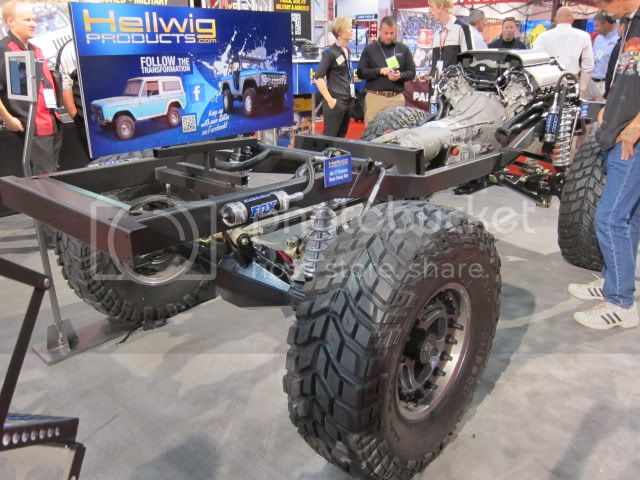

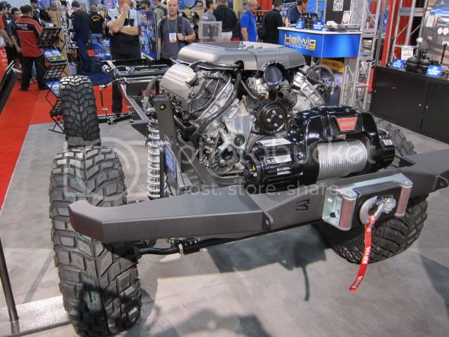

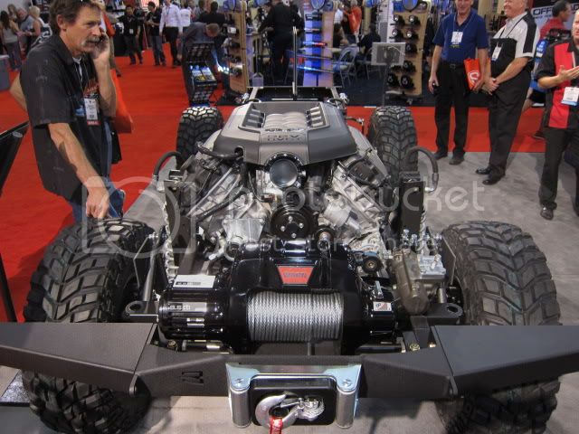

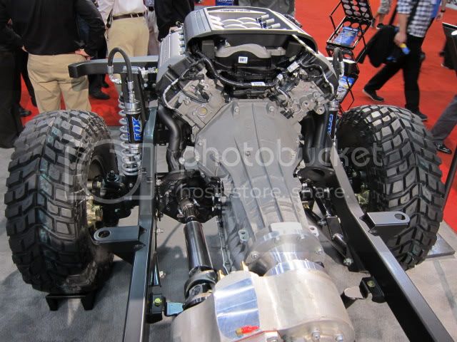

The SEMA show was awesome and exhausting. We had a ton of good feedback on the chassis and the company. Out of all the stuff we did, the most impressive thing that we got the most comments/questions on was using a CV in the rear driveshaft (actually double cardan, but whatevs). All the car guys had never seen one and were totally blown away. I can't count the number of times I explained how it worked, that is was able to pull over 5 degrees of angle, etc. I had multiple people ask if it was a new thing and were shocked when I said it comes stock on most trucks, including my 85 Toyota. Weird since out of everything on the Bronco I thought that was the least interesting thing, haha.
It's amazing how many people are building EBs right now. They're definitely the new cool thing (again). Now that we're back from the show, we're going to catch up on R&D work that's be on hold for Bronco/SEMA and then keep going on the build.
Here's some pics:
