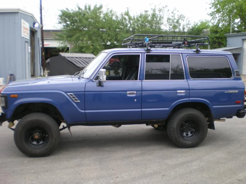

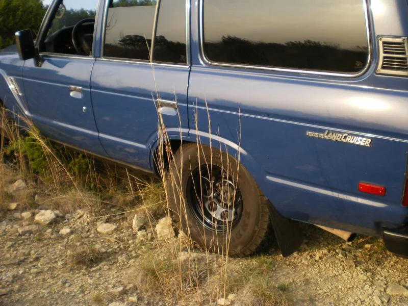

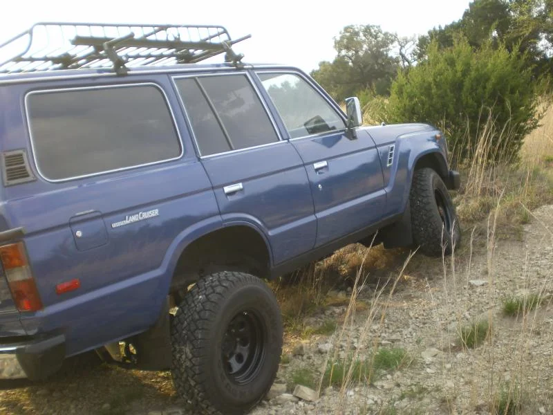

I finally got my Hell Creek 2.5" installed! Check it out...flexin' from Long Beach to Texas
Bradfly85 what size tires are you running. I am considering the 2.5 and am trying to get some info. Also did you put the heavy springs on?
I'm running 31X10.5X15 right now, but noticed yesterday that the left rear in the first picture barely rubbed the wheel well. I'll probably go more narrow and a little taller on my next set. As far as I know Tom doesn't offer a heavy spring.
