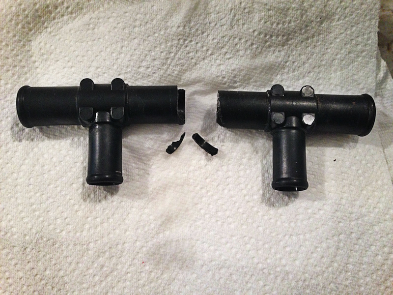

Heater T's failure - fixed with PEX t's

I found this particular thread after being stranded by the cruiser on Friday due to my Heater T deteriorating to the point of failure. Luckily I was at a gas station and noticed the drips on the ground which turned out to be a cracked T that completely disintegrated on touching it. The texture of the 3 ends of the T were almost like damp hardboard, and I’m afraid to say that I lost some of the pieces back into the system during removal.
How damaging are these small pieces likely to be? I would say that a third of one of the ends has been lost (perhaps in 3 chunks of 10mm by 5mm or so). Would that lock up my water pump, or block a critical galley? I had a new timing belt / coolant just last week.
I have the replacement T’s from a dealership and the car is currently at a farm 300km away from home. I’m with the car now and want to fit these, top up the coolant and get on the road again. Towing charges back to a mechanic would be significant.

@JonGregory Are you sure you lost the broken pieces? I thought mine was lost too when I separate the T from the hoses, but the broken pieces were actually stuck inside the hoses. But maybe mine was not in as bad condition as yours.

If the truck hasn't already been run then just take the hoses off and fish out the pieces, or use a wet/dry vacuum and suck them out. I wouldn't worry about the water pump with the pieces, the impeller would obliterate them as they are so soft but I would be more concerned about blocking a coolant passage and ending up with severe hot spots I the engine.
I'm pretty sure I lost some of them. I made the mistake of squeezing the end of the hose with the broken end of the T in there, and that squeezing broke it into many pieces. It was in the 'vertical' hose so I'm sure a bunch went straight down. I fished around but the end of the hose was clear.
I have spoken to the LC specialist (In Edmonton) who changed the timing belt last week to ask his advice and he really didn't think the Water pump would have problems in passing the degraded small pieces. I have (in the last hour) fitted the T, topped up the coolant and ran it on tickover for 20mins. Temp gauge after warm up was higher than I've seen before, but after a while (system burp?) it dropped. The replaced T is hot to the touch but only cool air from the interior heater, despite calling for max hot. I'm guessing an air lock.

Can anyone post pictures of the T's before change and what they look like ... Mine look pretty good for 225K , but I am guessing you cant see the part that is breaking down as it is hidden in the tube. May be mine where changed at some point...? I guess I will have to get in there and just change them to brass.
Changed mine at 100k just to be safe, they honestly looked fine:
(the ends broke off as I pulled them from the hose)
Mine at 164000K (2002) looked like the OP pics (first post in this thread). Black in the centre of the T, but each of the three ends was a light brown crumbly mess, with the consistency of damp hardboard. The vehicle lived its first 12 years in Phoenix.

Make the t's replacement more frequent, pretty sure it's listed to be replaced with TB. Don't wait 15 years and 200k, like most of us.
@wpsfan - Yep, still in the beast. One year and about 18k miles later look exactly like they did the day I installed them. Was planning on changing them to OEM's when I first did this, but now leaving them in as a lets see what happens. I lasted check them before and after a 1000 mile trip to Floriduhh! a couple weeks back. Also, when I check the coolant level in the expansion tank it hasn't moved 1/8" in last year so I'm fairly confident nothing is leaking anywhere.
If you already have the OEM's I'd just put them in. Even if you have an 07 that means they have been good for 9 years and you can try the PEX solution in 5 years or so when you have to even begin worrying about them again.
