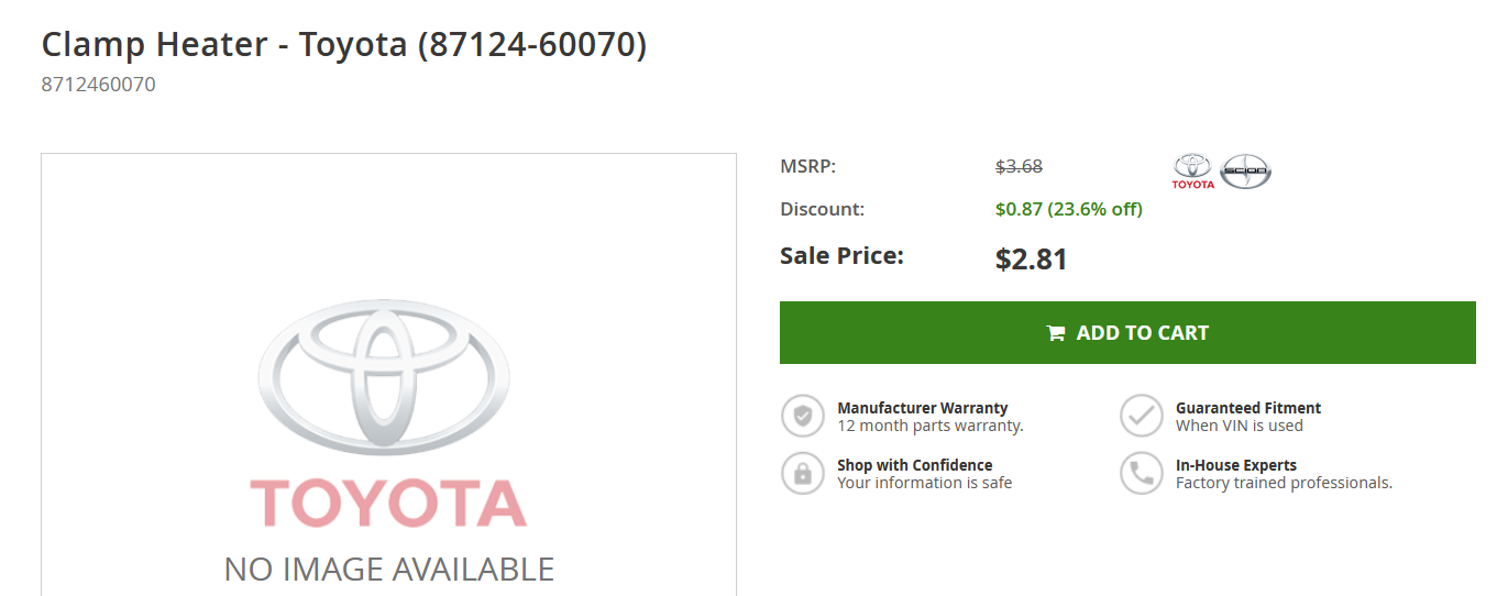

Thanks for confirming! I was a little confused, because @Kernal said above it may not be long enough after cutting to fit the left side. Maybe worst case, I could always try using Gates 28460 (9801) if I come up short.
I'll be sure to add a couple more 87124-60070 clamps, I ordered 2 for the right side, but forgot about the left side connection.

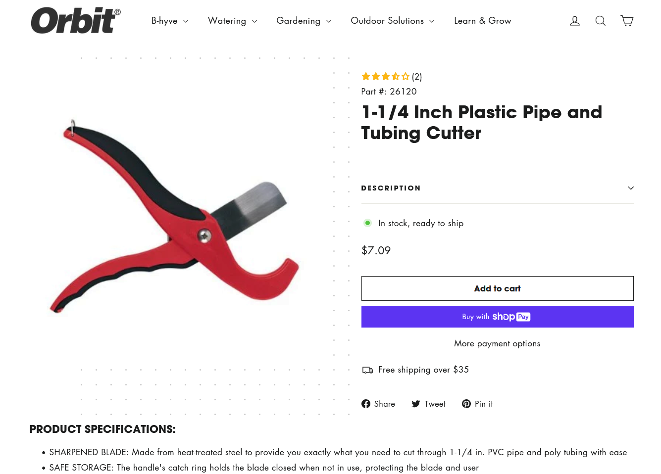

FWIW, I use a tubing/PVC pipe cutter, like this one (this is not the same as mine, but it's close)
The idea is to get a cutter that is made for tubing/pipe; one that supports the tube and slices it. Any cutter made for landscape tubing/pipe will work. You cannot get a perpendicular (which you need) cut with anything else.
I tried for years to get correct cuts with knives, boxcutters, scissors, etc. and gave up. I now use the right tool and wish I had been using it all along.
So you’re saying one of my utility blades won’t make the cut? 🤣
Would this work? Finger Release Ratcheting PVC Pipe Cutter - https://www.harborfreight.com/finger-release-ratcheting-pvc-pipe-cutter-62588.html
Or this? Amazon product ASIN B01C8G4F7M
Yes, but I think the ratcheting action is overkill. I have a large PVC only and a small PVC and tubing cutter; both have simple pivots and work fine.
Only reason is I need to hop over to HF soon for another tool run (again), so I figured I’d check what they had. Ratcheting is def overkill for these rubber hoses but maybe I’ll cut some pipe one day? 🤣
Edit: Ordered the Scamazon ones - still went to HF.
