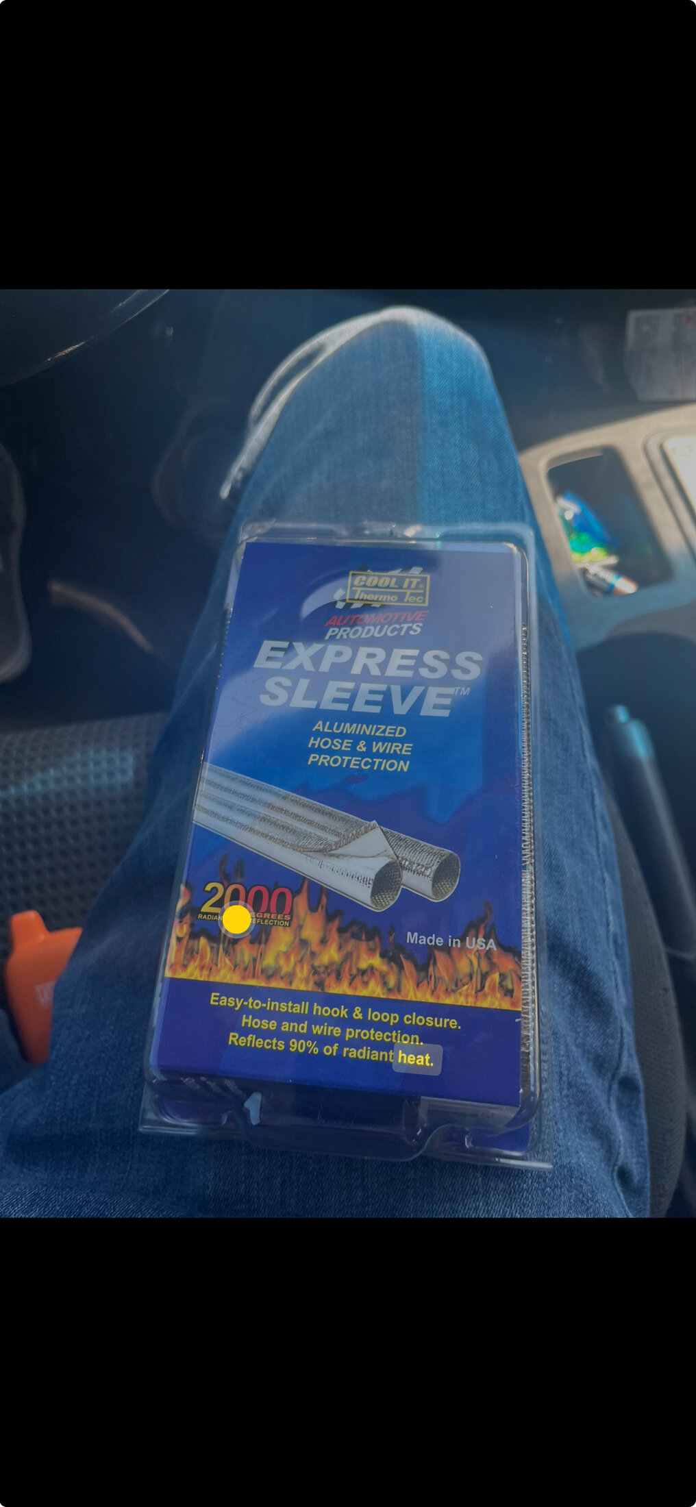

I just recently wrapped my rubber A/C line, that goes along my turbo down pipe & exhaust manifolds with this stuff.
Claims 2000*, I doubled it up because I had extra.
