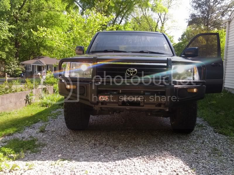

I went to a salvage yard and cut some headlight connectors off a IS300 equipped with hids. Paid a $1 for the connectors. Then used denso ballast to fire up my CBI bulbs. Drilled the ballast to the base of the headlight. Also I used tsx-r clear lens.
On a highway 7+ lanes, I lights it up easily. Nice wide spread across my front end. Razor sharp cutoff line. Bright white, when I pull up to cars with factory hid, my lights make oem hid look yellow.

Brother that is frickin impressive!!! Wow... I remember working for Acura when we got the TSX and the HIDs were beautiful... That cut off is sweet!
