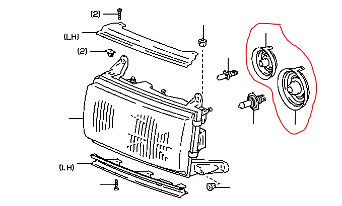

I replaced the damaged passenger side headlight about ~1.5 years ago and everything was swell...so I thought. I was in there doing bulbs today and noticed the bulb on the passenger side was quite dusty and upon inspection so was the inside of the new headlight :frown:. Turns out a new Toyota assembly does not come with the rubber dust boots that go around the socket and I threw mine out with the old headlight :bang:. The part numbers are below, but they appear to be discontinued. Anyone have some sitting around or know where I can source a set? Whats the best way to clean all the dust out of my new headlight?
9007599028
9007599027

The complete headlamp assembly should have come with the rubber dust covers along with new bulbs. If you bought just the "lens and housing" as shown in the diagram above, they did not come with any of the small parts (bulb, dust cover, molding). Unfortunately they both appear to be discontinued.
