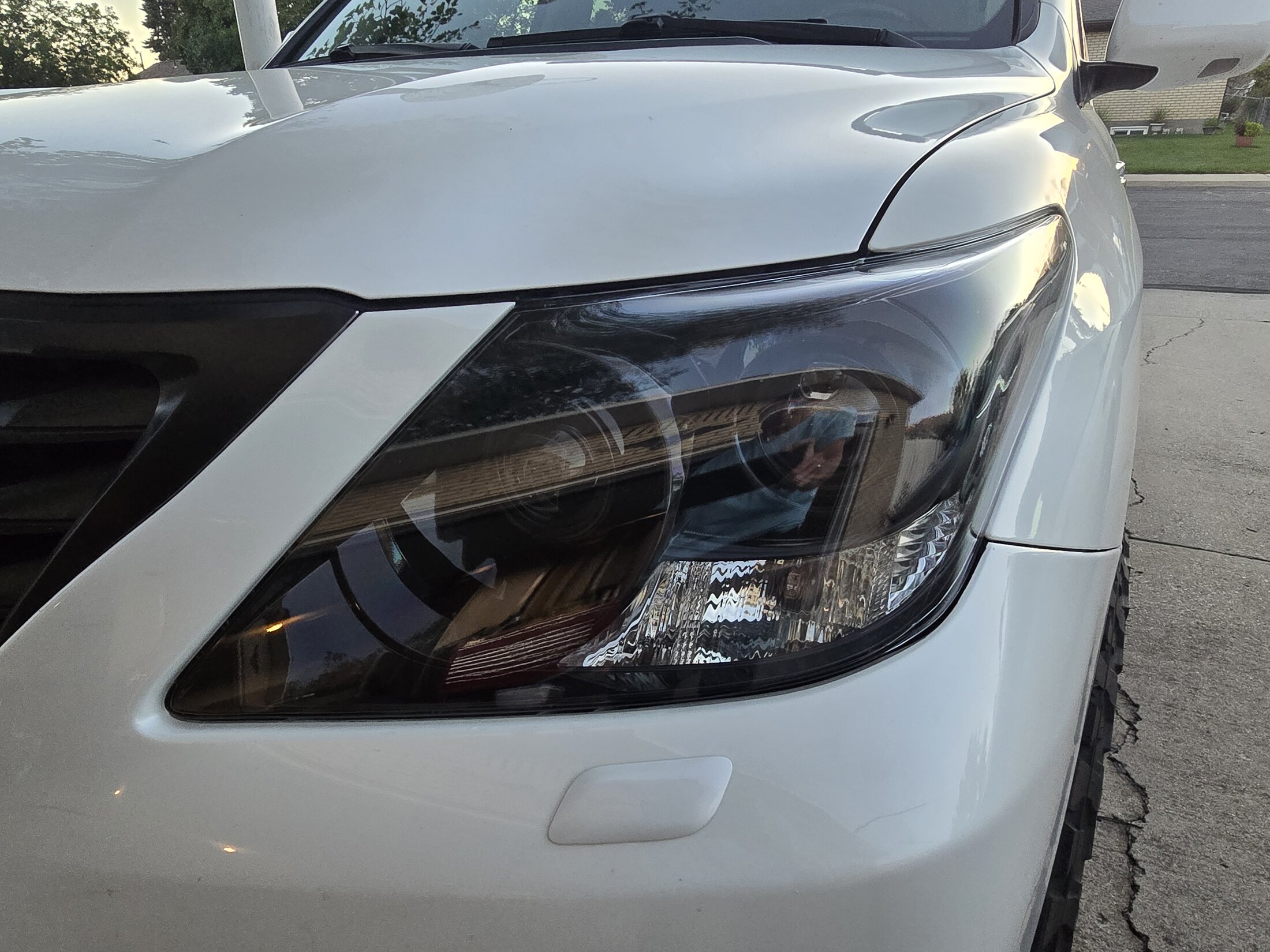

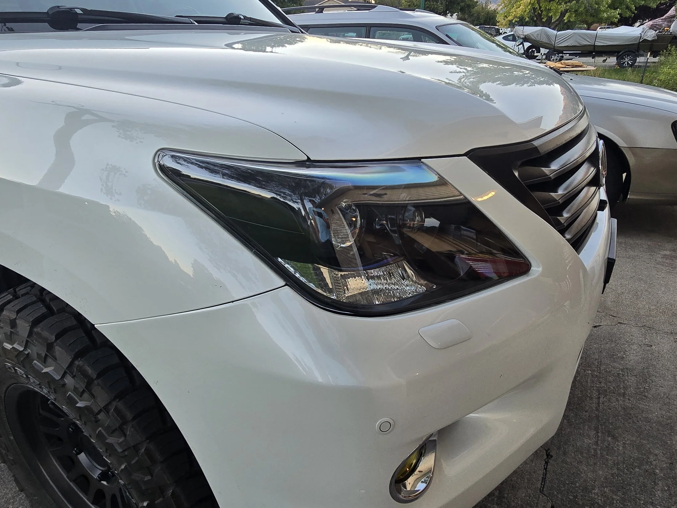

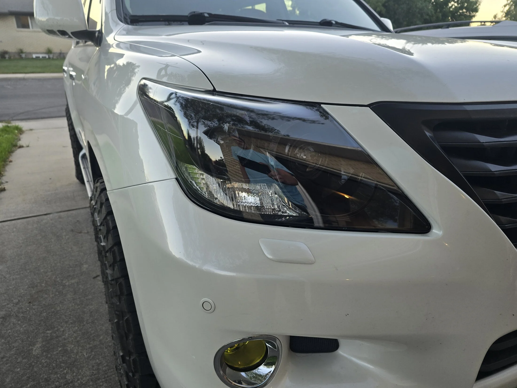

First I want to say that I have been building custom headlights for customers across the US and a few other countries for over 6 years so this isn't my first rodeo, though it was my first set of lx570s since acquiring my 08 starfire pearl a month ago. My own builds are geared more towards output and simplicity but there are plenty of options this doesn't go over like halos, demon eyes, etched projector lenses, HID setups, etc. I know I am not the best at photographing every step, I get into the zone, but there is almost no threads or extra info on LX570 builds so it's better than nothing.
I didn't document every step but this gives you a pretty good idea what to expect and what the internals look like before you crack them open. My factory lenses had tons of stress cracks or crazing in the lenses that could not be fixed so new lenses were used for the build.

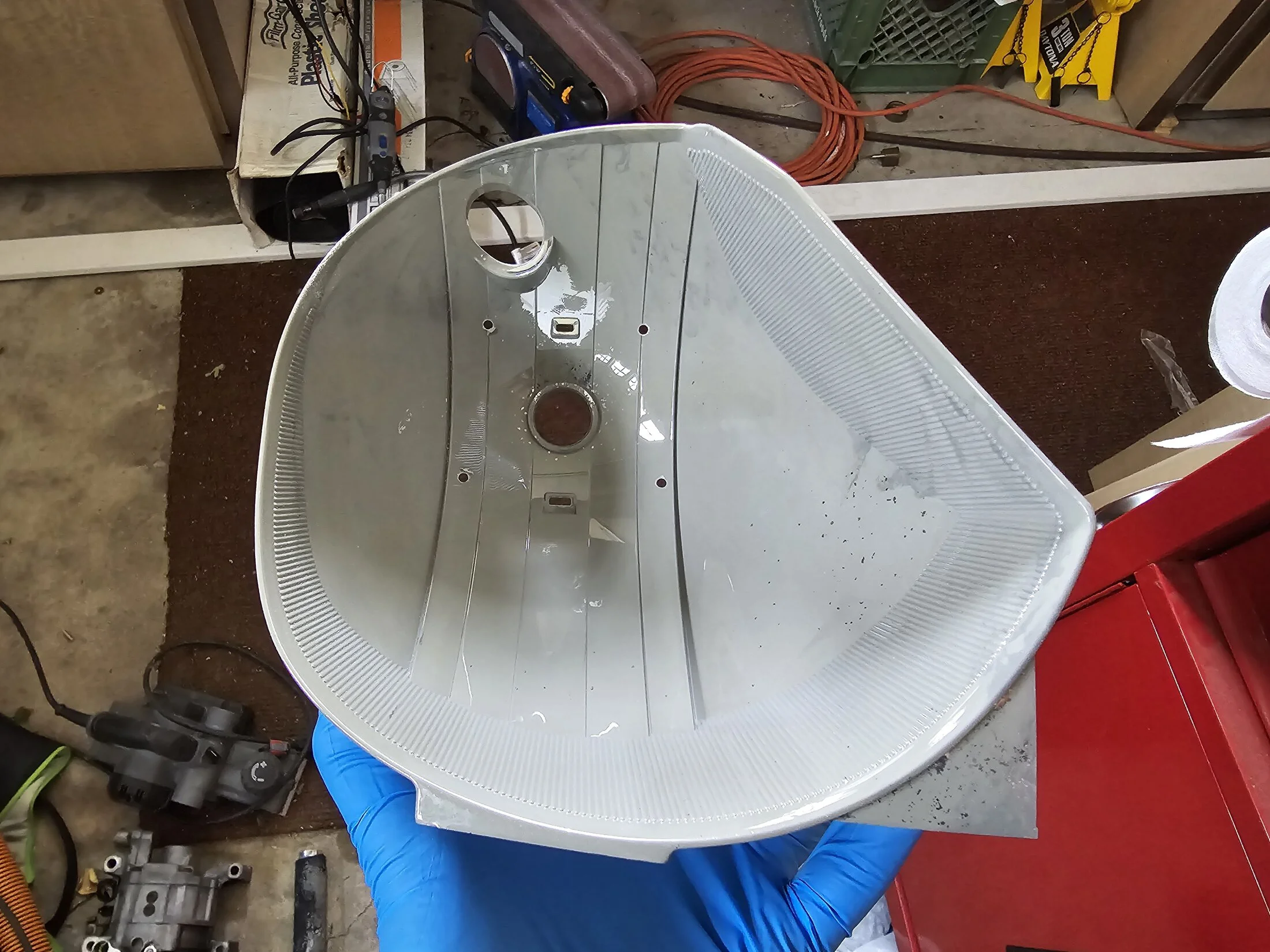

-once lenses have been removed you have full access to all the inner workings of the headlights. If you are doing any paint work on the housing, remove the chrome housing/shroud via the 4 screws into the lens from the backside.

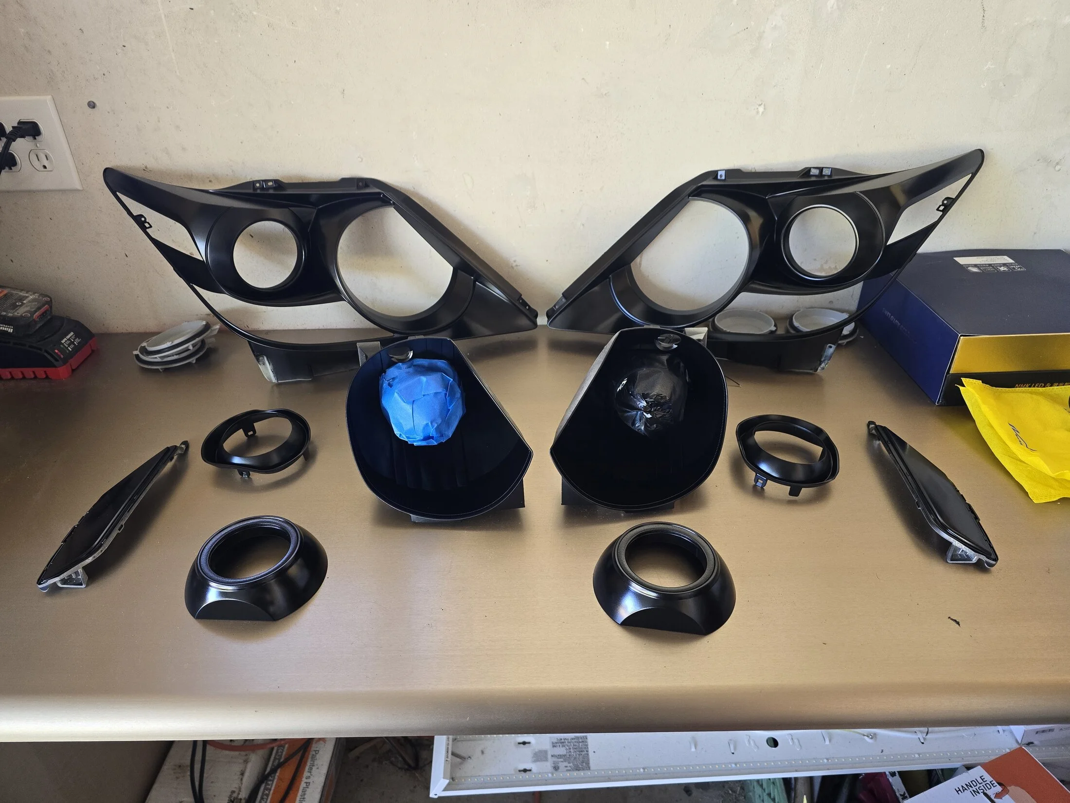

Step 6: shroud fitment
-there are plenty of shroud choices to cover up the high beam location projector. The shroud centric rings are used to fit a full size 3" projectors shroud onto a 2.5" projectors lens. You may need to trim more or less depending on your choice, the Iris shroud requires very very minimal trimming/sanding.
Step 7: paint work
-for any parts you plan to paint, strip the chrome or sand it off to get the best adhesion. Make sure that you do all your trimming ahead of time so the final finished paint surfaces end up perfect.

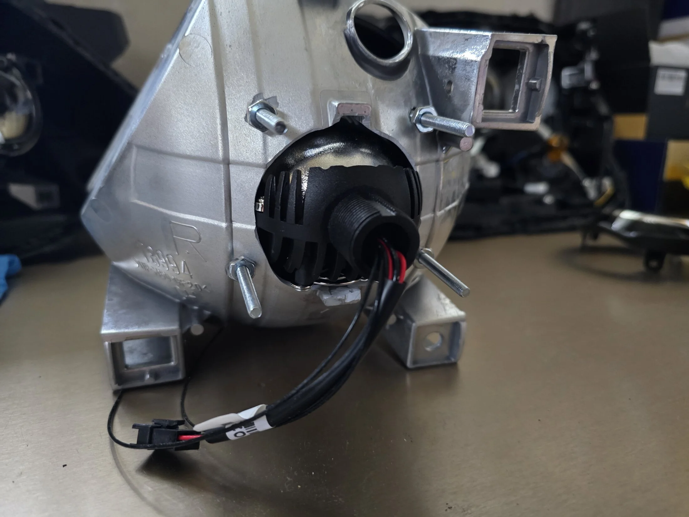

Step 10: wiring
-if doing quad projectors, you can wire them up one of two ways, constant quad low beams or have the high beam location projectors be wired up on a separate switch. I always wire them up as constant quads which means all the wiring can be done within the headlights and behind the dust caps. Both projecgor low beams need to he crimped to a h11 connector to make it plug and play. Both the high beams should be tied into the factory 9006 connector, simple as that.

I will be posting more completed pics for output and a few extras along the way since I am limited to 5 for this initial post.
