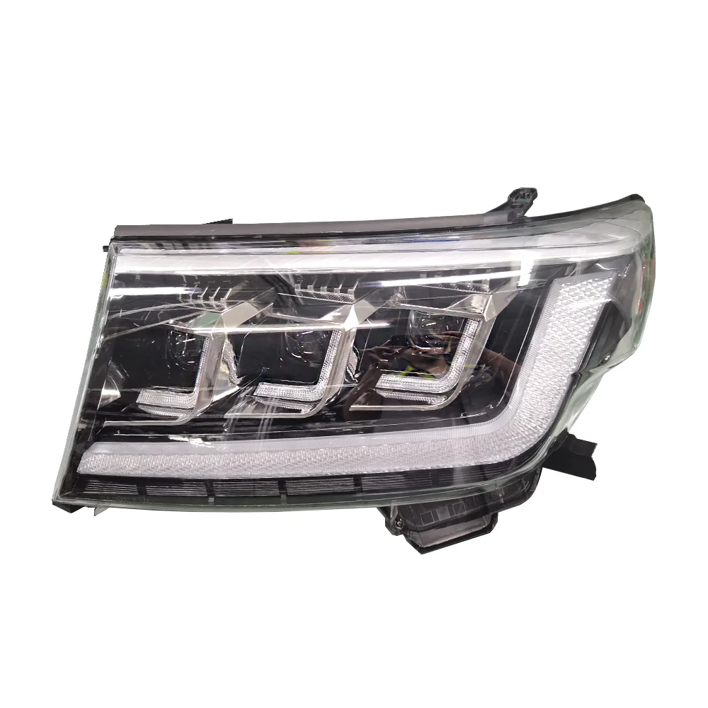

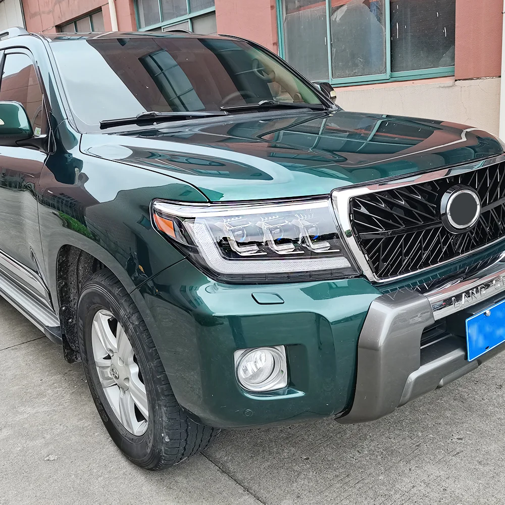

I've been looking at these that appear on Alibaba.com. They've got a few different styles to suit the 2008 on models, 2012 on models and 2016 on models. I'me just not sure they'd be "great" quality, but neither are the factory ones now that they are yellowed up, filling with moisture and crazy cracking....
View attachment 2821454View attachment 2821455
I would expect all of those side effects for brand new aftermarket lights.
Your factory ones are filling with humidity?
