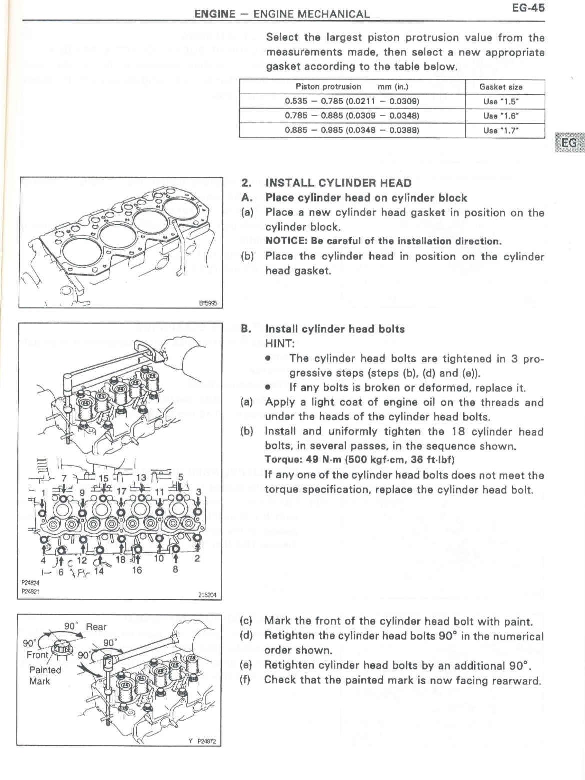

Do you know if the MLS gasket has a different torque spec than the 87ft lbs that the manual states?
The later B engines (3Bii, 14B, 15B) that I am familiar with came with MLS gaskets from factory and have torque specs of I think 49 Nm, then +90º, then +90º again. Which would end up a lot more than the 118 Nm which my local museum tells me is 87 ft lbs :D. 118 Nm is barely above wheel nut torque - the head bolts onone of these engines need the engine stand propped against a wall and a cheater bar on my breaker bar.
I thought this was down to the switch to torque-to-yield bolts, but it would also tie in with the switch to a MLS head gasket.
Good thought though - I had not considered that. I would get a set of 3Bii bolts (18 x 90910-02084) and run with those if you are taking the head off.
Sounds like you did everything perfectly, so unless (and I really hope it's not the case) the block or head has somehow cracked, clamping pressure is the only thing I can think of having failed.

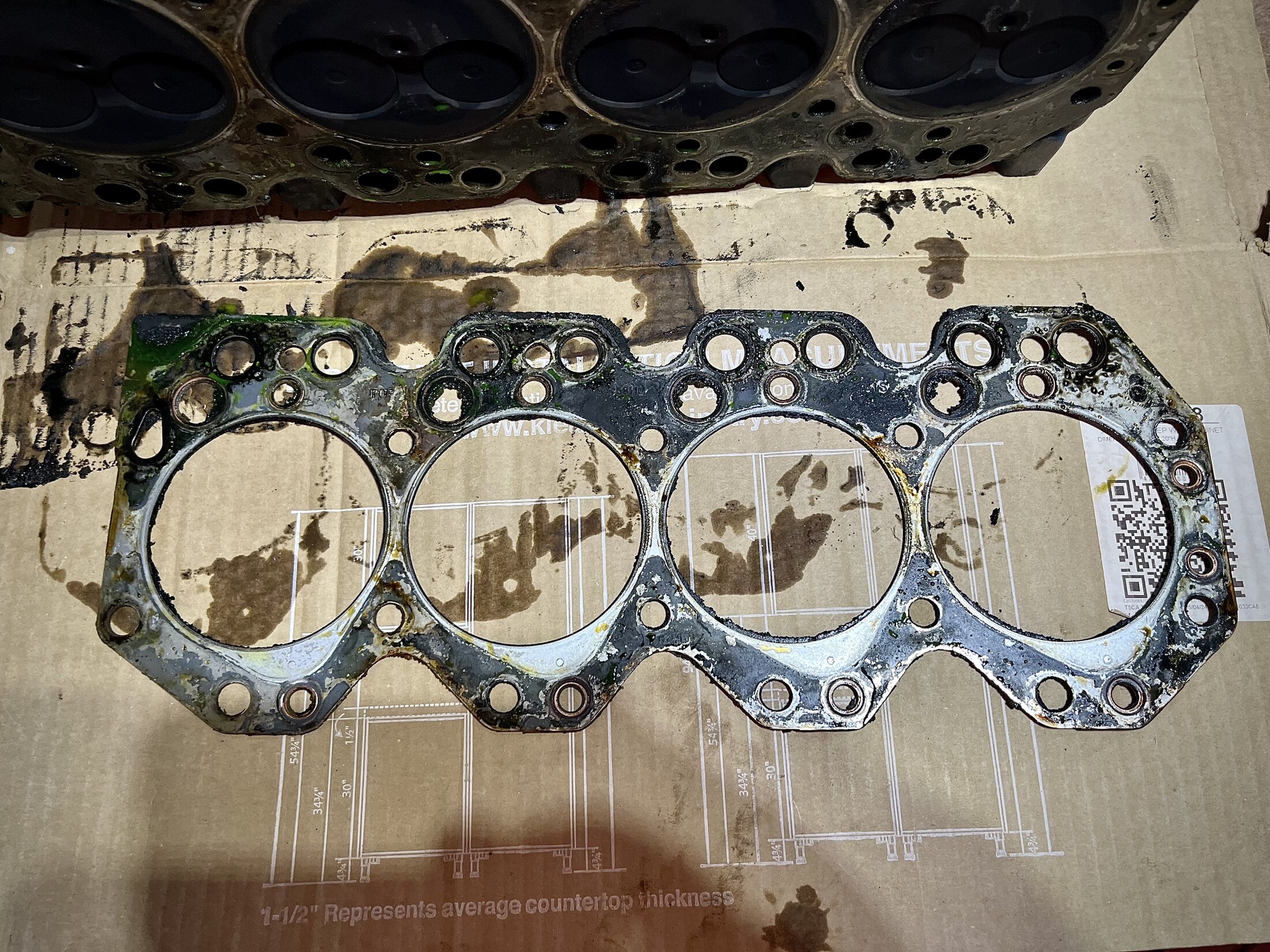

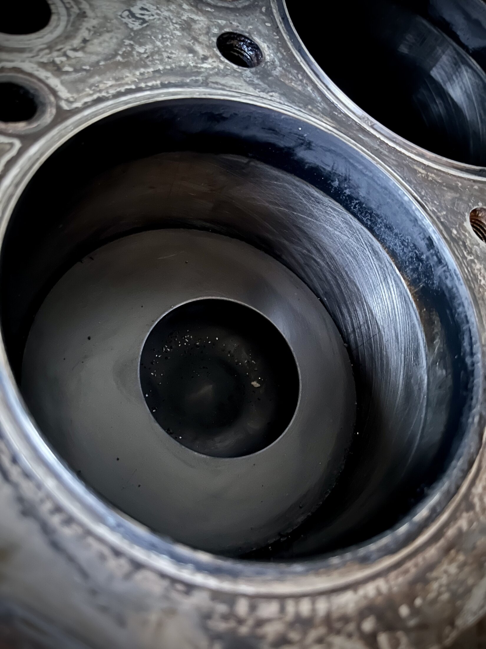

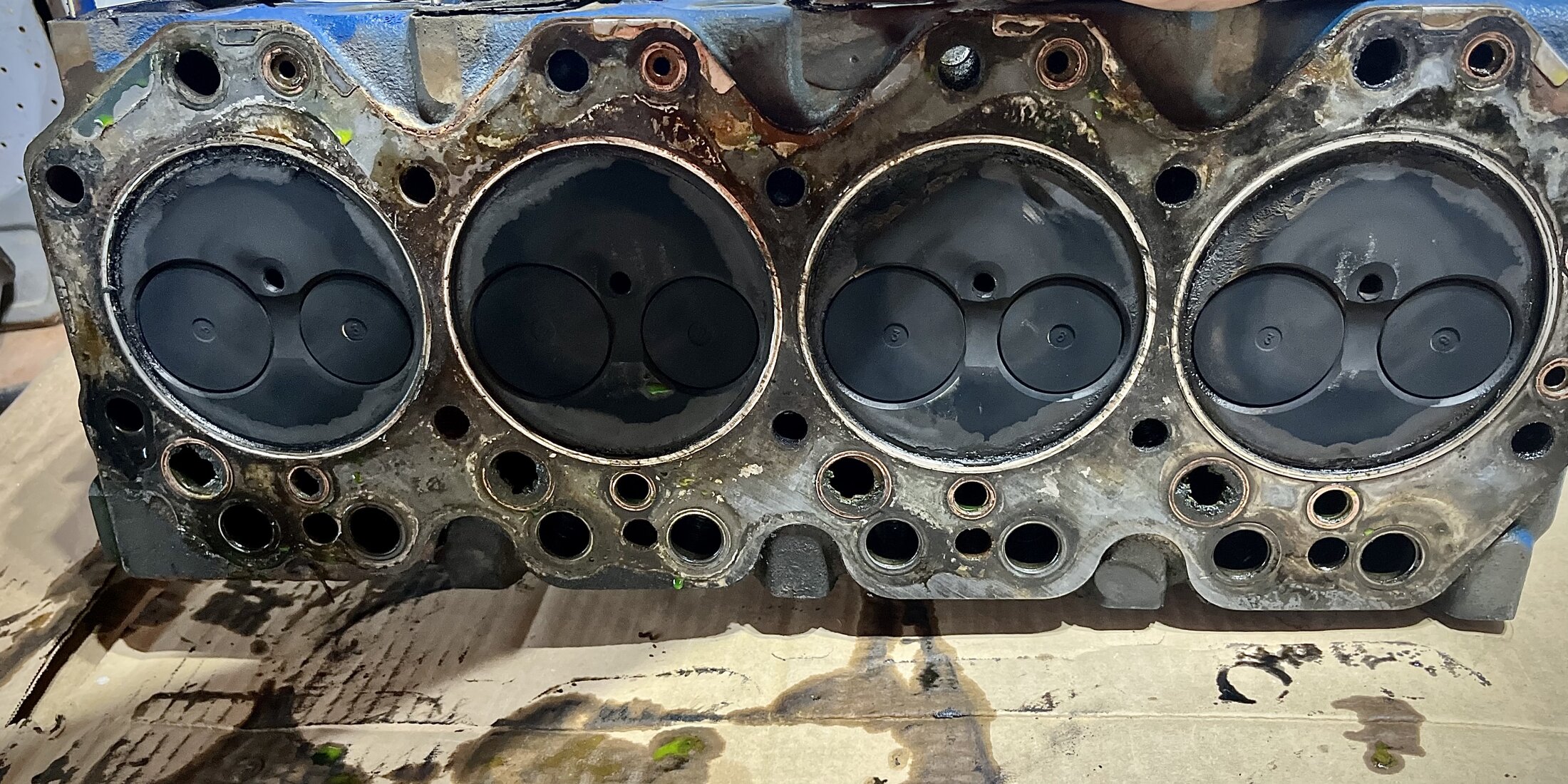

I opened up and checked the head bolts. The ones on the exhaust side were all a little loose to torque spec. I retorqued but it’s still leaking.
Do you have a manual or specs for the 3Bii or 14bt/15bt? I
I got mine from this thread. This is the 3B, 14B, 15B-F, 15B-FT engine manual. Toyota do not differentiate between various 3Bs, but this is the August 1988 3B which has the same block as the 14B.
