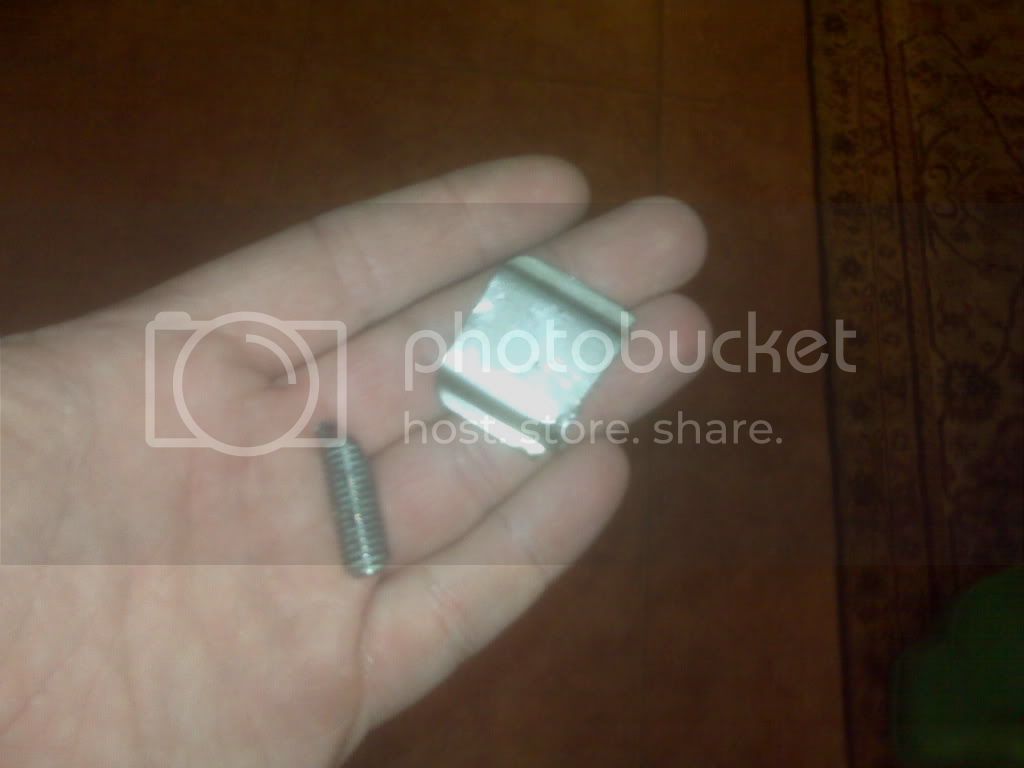

Here is a pic of the end of the bracket and screw that I cut off. It was at least 1/2 inch I cut off......
