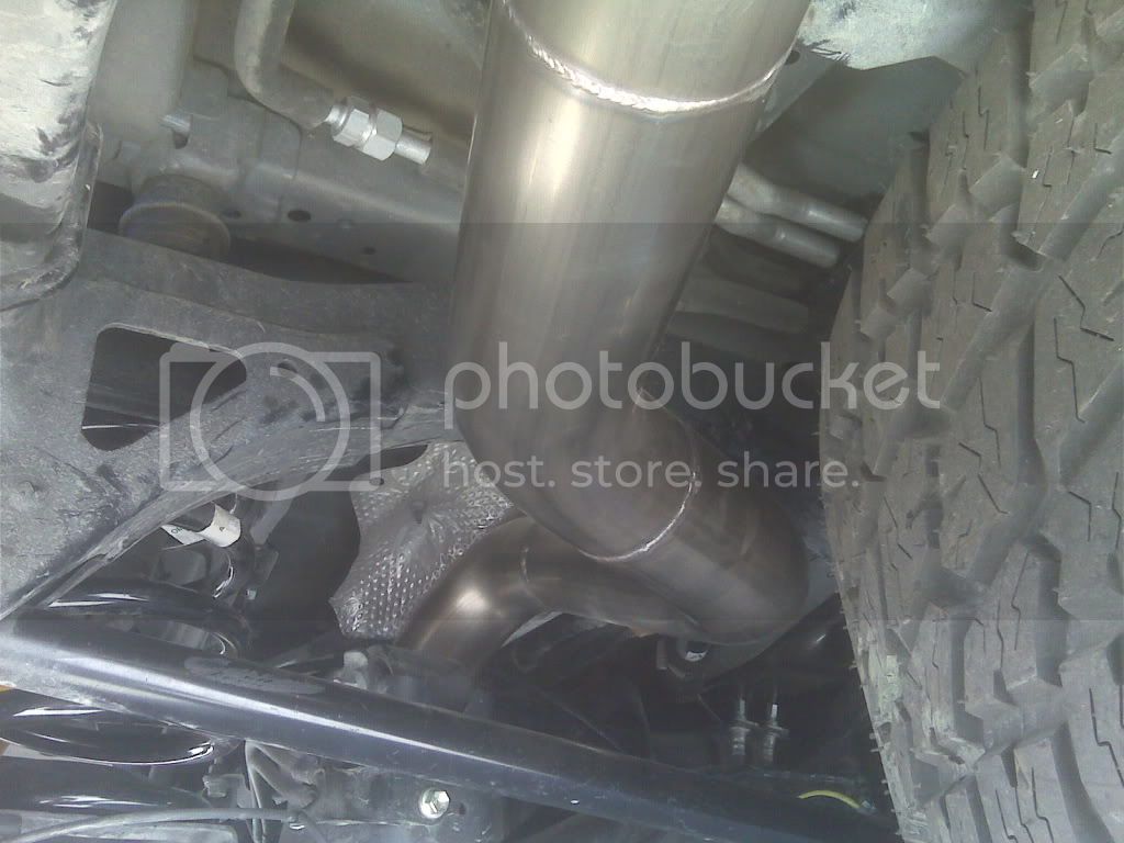

Here is the tailpipe exit:
Here is the pipe:
Here is a potential issue. If you look carefully you can see the tab from the bracket hanging down pretty darn low....I think I am going to have to cut off.
(From this angle it looks high enough but if you get even, it comes lower then the fuel tank.....therefore is going to be easily caught.)

Wow, that exhaust tubing looks massive! What did they use for the muffler? How does it sound? I wish somebody made high flow aftermarket systems for the 80 :(
Can't the bracket just be cut off below the where the washer resides? Or is that still too high?
Yes it can and that is what I am going to do.
If it looks like it will still be an issue, then maybe a small custom made skid plate about 2-3 inches wide would work. I have not gotten under there completely as to where that might mount. I will have to see and figure it out.
