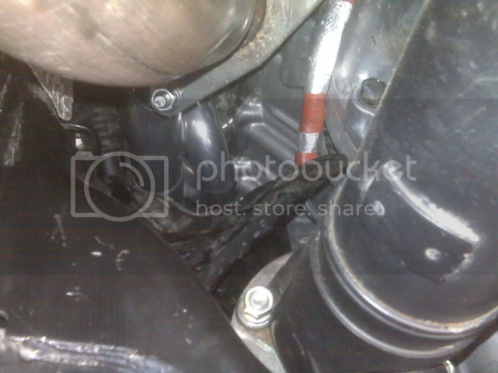

Well we ran into a small rare issue. It seems that one of the screws on the steering column was long enough to get caught on the headers, not letting the column turn.
Kind of a major issue. When ever they took her off the lift, it was to check clearance on the exhaust, and only moved her back and forth off of the lift.....never needing to turn the wheels!
Anyway they are pulling off the drivers side header and changing the shape of one of the pipes from round to oval which will fix the issue. It won't change the output at all.

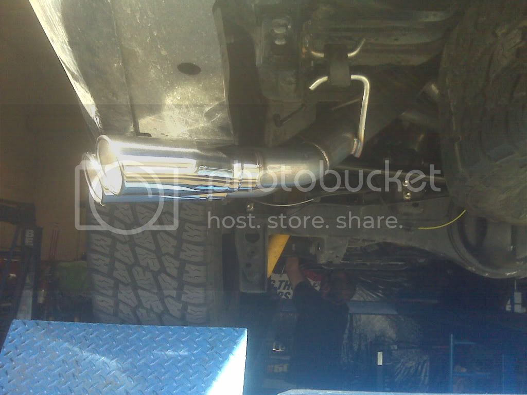

The exhaust looked awesome but I told them that it is hanging too low for off roading. (I will enclose pics when I get home). It looks great, but will get demolished when off the road.
So we put her on the lift and discussed getting rid of the nice looking tailpipes (which don't do anything but look nice) and making the exhaust terminate under the bumper ( more like stock) without any fancy tip. This would make the bumper bottom the lowest point in the rear, not the exhaust.
They agreed and are doing that mod also.

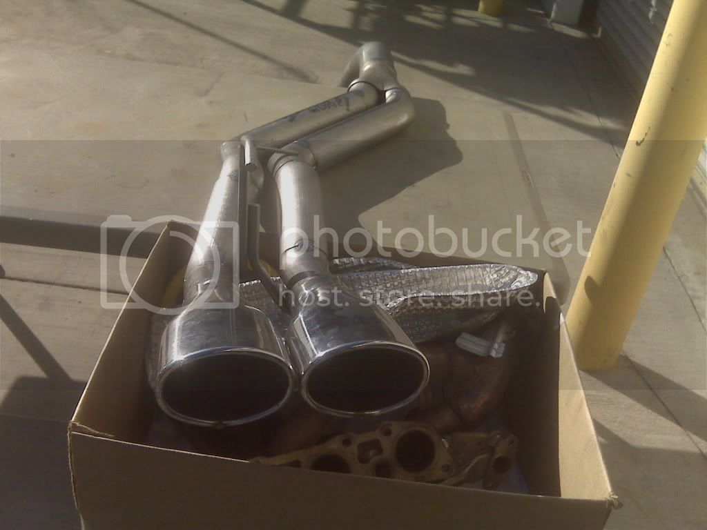

Here is what the dual straight rear looks like. Look at the nice thick piping! BTW In the box it is leaning on are the OEM headers!
Here is the Dual Drivers side, nice looking, but not 'offroad' practical:

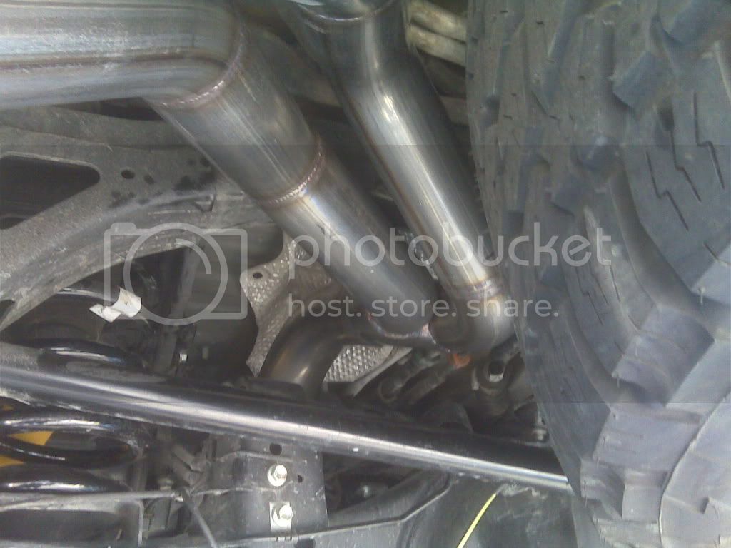

The nice thick dual pipes heading to the tips (pic from rear)

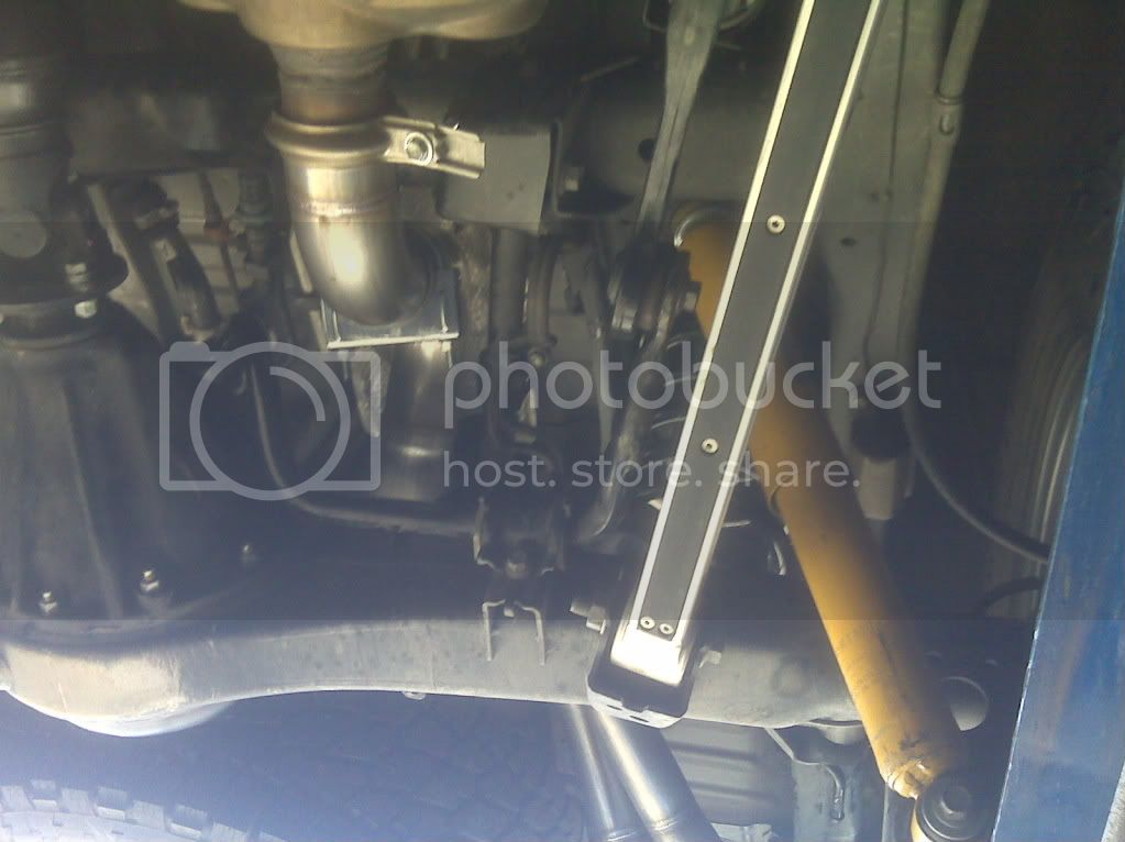

Pipes coming off the stock 1st muffler: (see them going over the rear axel)

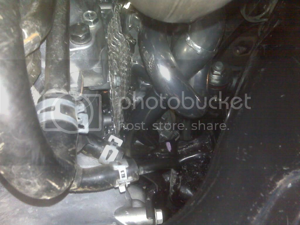

The headers (obviously hard to get pics)
