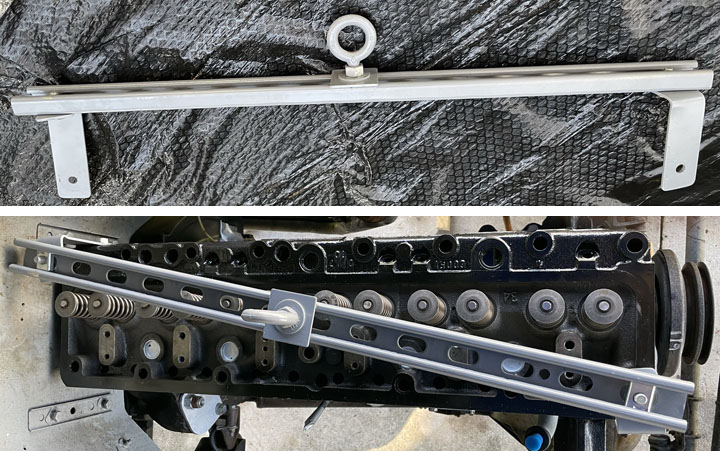

I don’t have an engine leveler but I whipped up this head leveler with material on hand. The eye bolt is mated to a channel nut so it’s adjustable where the hang angle can match the angle of the engine. I lowered it with a chain come-a-long hanging from a pipe spanning across two pipe stands. It couldn’t have gone on smoother.
@Steamer 's leveler is a great idea, but there's an added complexity for leveling with a heavy manifold cantilevered off the side of the head.
Oh! I forgot to mention the adjustable counterweight attachment. lol
